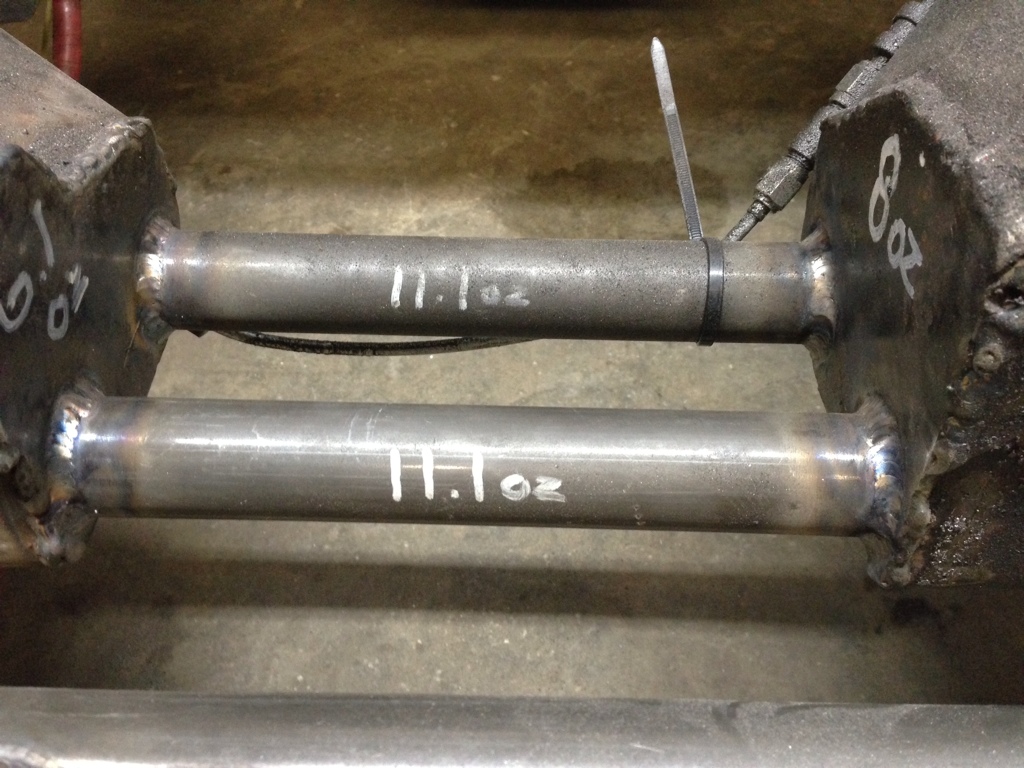

have you modified your stock cross member yet? s10 guys are losing roughly 20lbs by doing this. the silverado frame is a lot beefier than the s10 so i could see possibly 25-30 lbs off of your nose.
I am doing that right now. But I can tell you weight savings will be about half what you are thinking. The total section I cut out weighed a little over 10 lbs I think. I'll probably add back 3-4. Either those s10 guys are lying or.......
