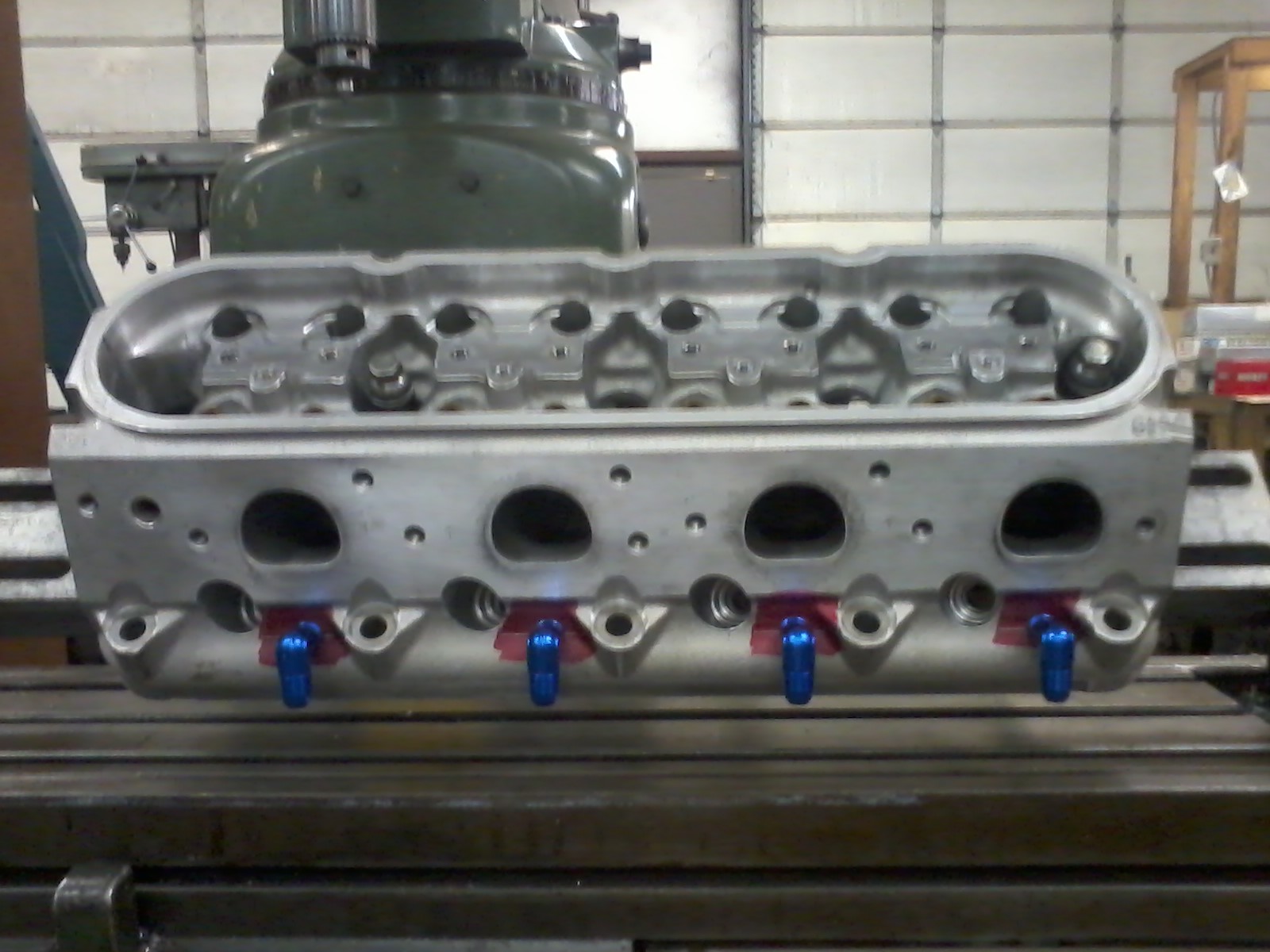

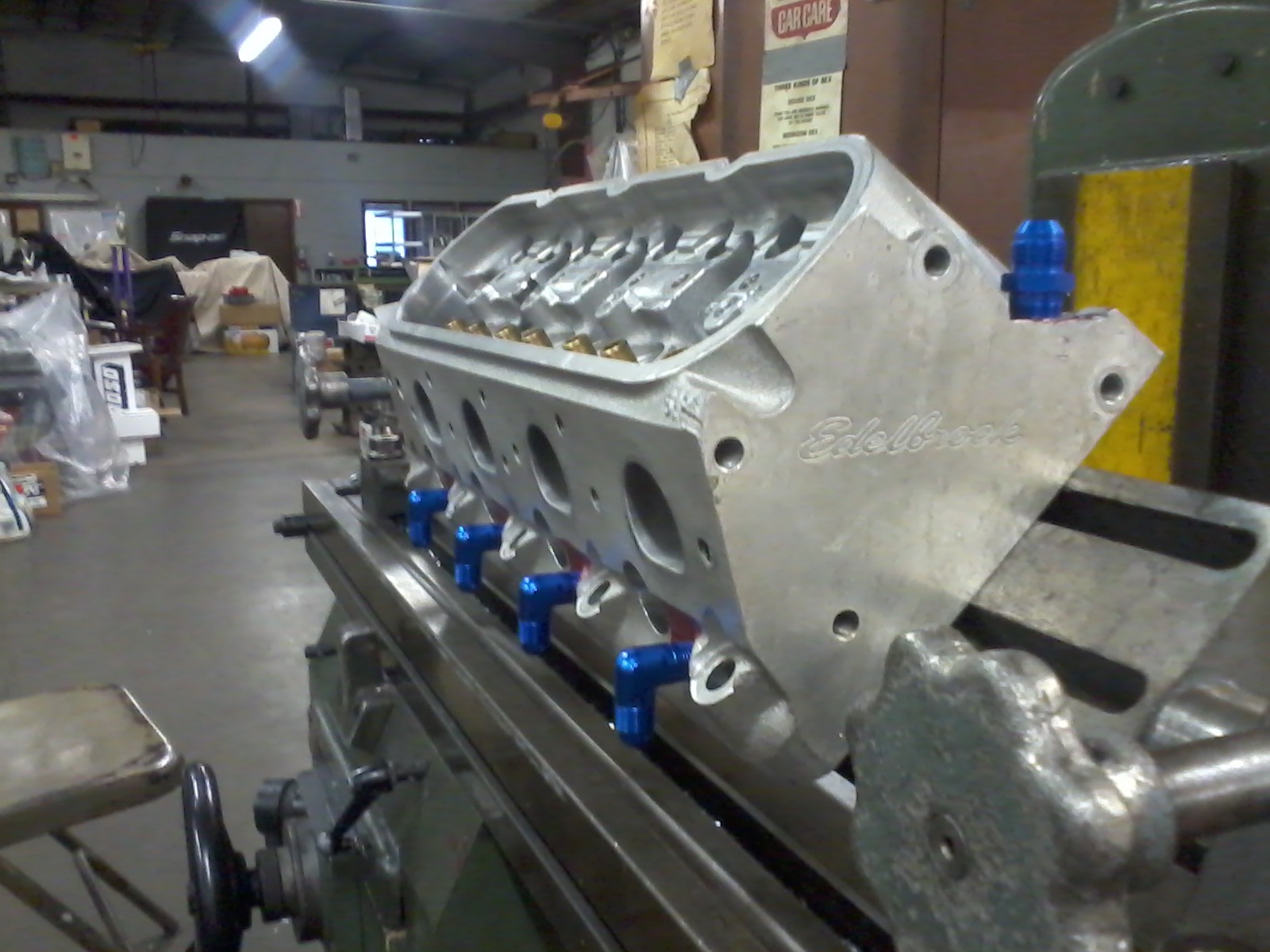

In an effort to keep the heads down on this thing the block is gonna get filled to the top, welding the decks on the heads completely shut (dry deck) and 1/2" head studs.
I'm gonna feed water to the exhaust side of the heads via -6 lines aimed directly at the back of the combustion chamber and water out will be via -8 lines where the steam ports used to be.
Here is pics of the progress so far.

The 6 bolt must be crazy expencive? Seems like you have a lot of money rapped up in all the fittings, tubing, drill, machining, and other misc. I do love anything that is different and maybe one of a kind? So this is awesome just seems like some crazy voodoo stuff.

Set of 6bolt mast/allpro/etc. probably 7-8k decently setup.
Im going cheaper with a prc/tfs ls7 heads bout 1/2 that, not nearly as much boost as blown06 though hes pushing 2bar + into setup.

The modification to the heads was a suggestion and brainstorm of a few different engine builders. The reason I haven't switched to methanol is just as you said......the fuel system. Block gets filled with "Hardblock"
