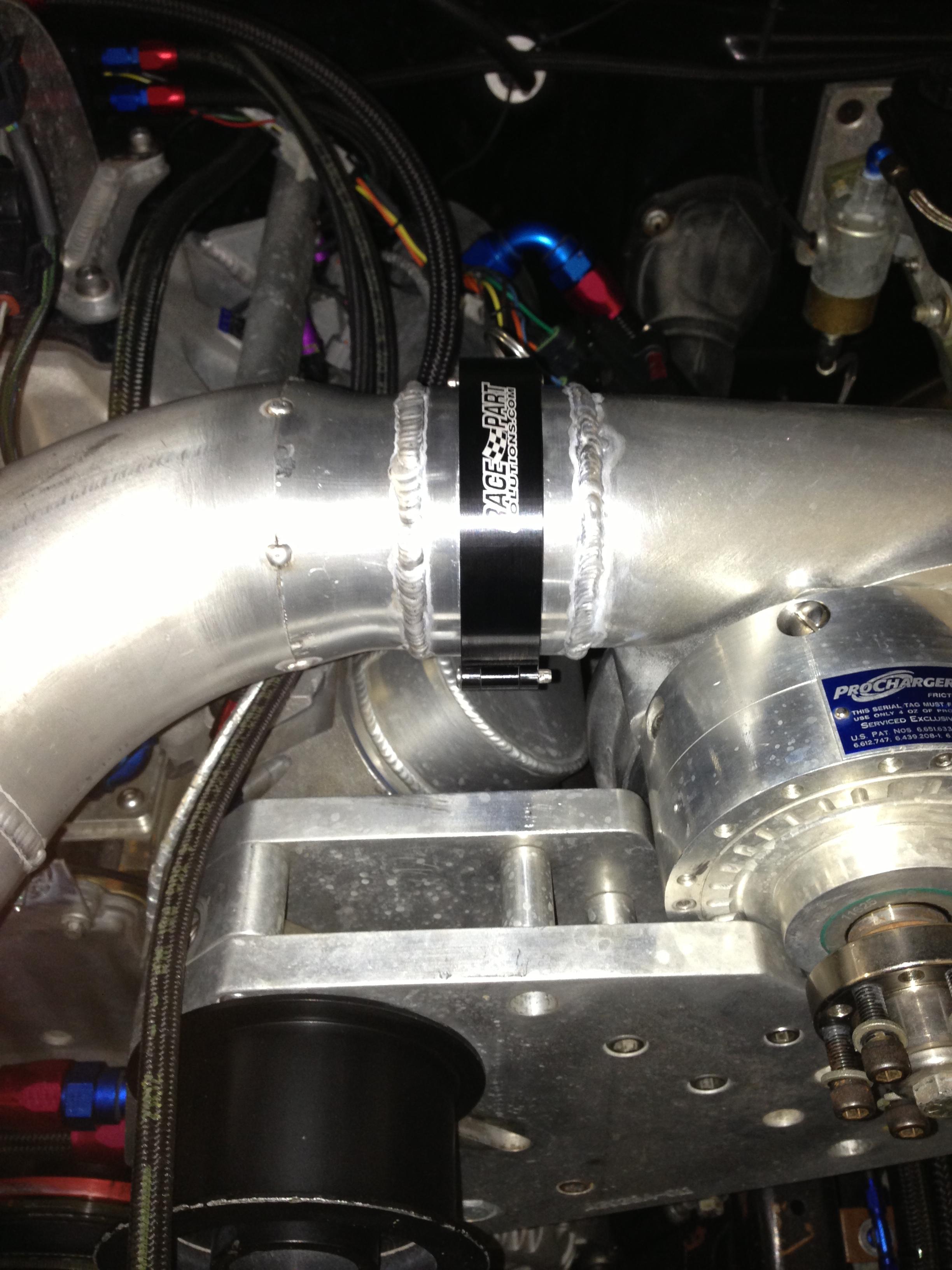

I've already got the pipes v-banded at the intercooler. I have a racepartsolutions clamp at the tb. I'll just do another racepartsolutions clamp at the blower. I don't need much room for flex. The motor and the blower don't move at all. I have yet to have one belt issue.

I had v-banded the intercooler and did a racepartsolutions flex coupler at the throttlebody. I left the blower connection silicon/T-bolt to allow for movement (if it needed any). It wasn't blowing the tube out of the silicon coupler (rigid mount at the intercooler), but it was stretching the silicon to the point of pushing the t-bolt clamp off. Anyway......that won't happen anymore.
