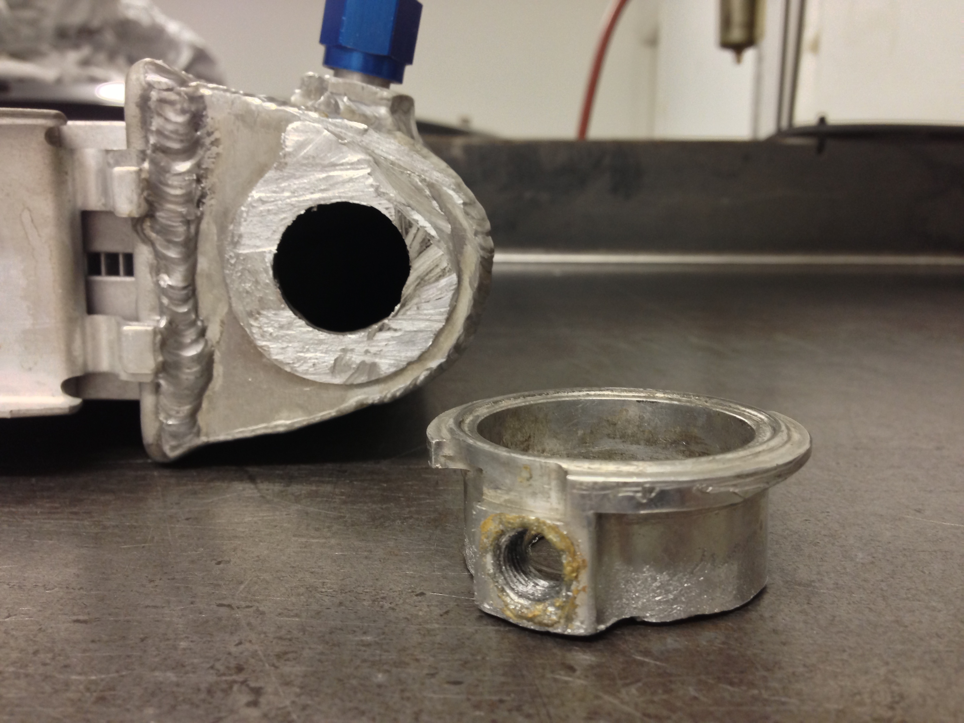

I was pretty pissed off about the pushing water out the radiator cap thing....
So I got drunk and cut the filler neck off the radiator....now what????
Have a new radiator built...
That is a back weld cap and they often have issues because you can't pressure test the radiator and inspect the weld on the filler neck. I would buy a new filler neck and clean here up and weld it back up.
Here is the style we use at the shop.
https://www.cantonracingproducts.com...-NECK-WELD-ON/
What about the vertical weld next to it.......looks like a few pin holes.
