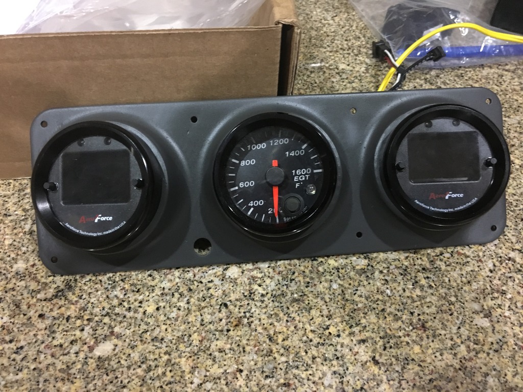

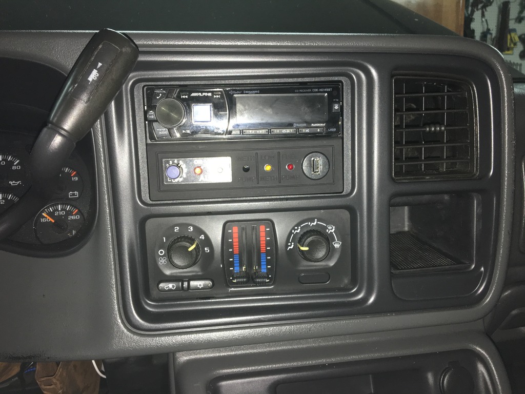

I got the radio pod installed today. I just got to install the alkycontrol LED. I also got my new Meth pressure gauge install and working.
Crappy pic
The console pod should get installed tomorrow

Looks damn good. I'm pumped to see the guage pod installed.

Curious what your egts will be.

I have always had a egt gauge ever since i was turboed. I am just moving it noe.
