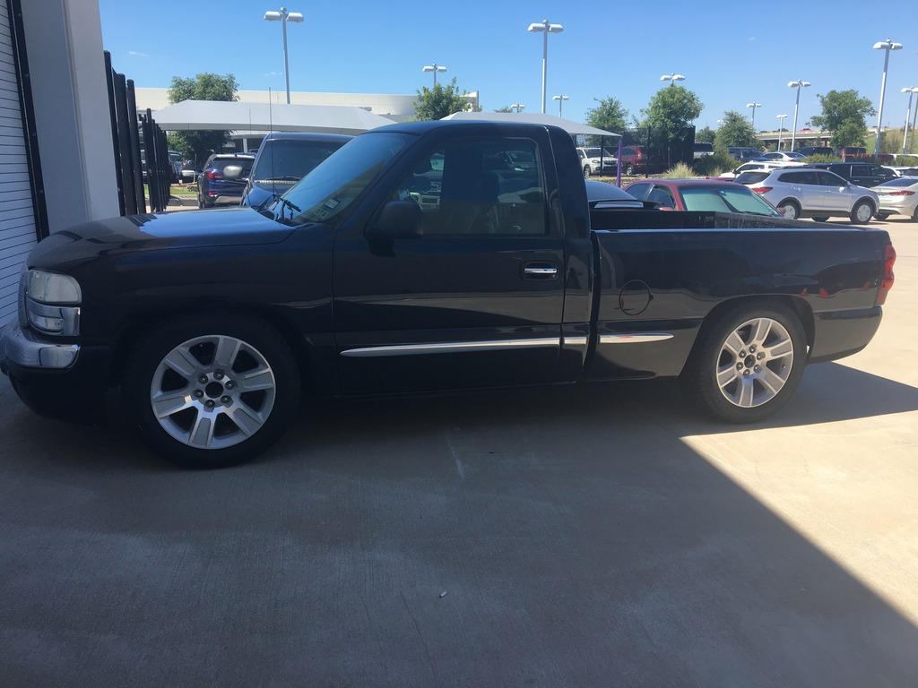

New wheels and tires. The center caps are being painted

Looks awesome!
