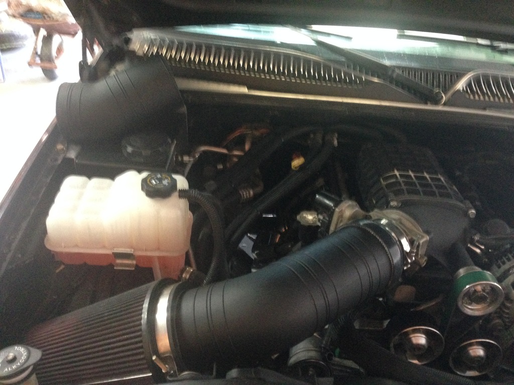

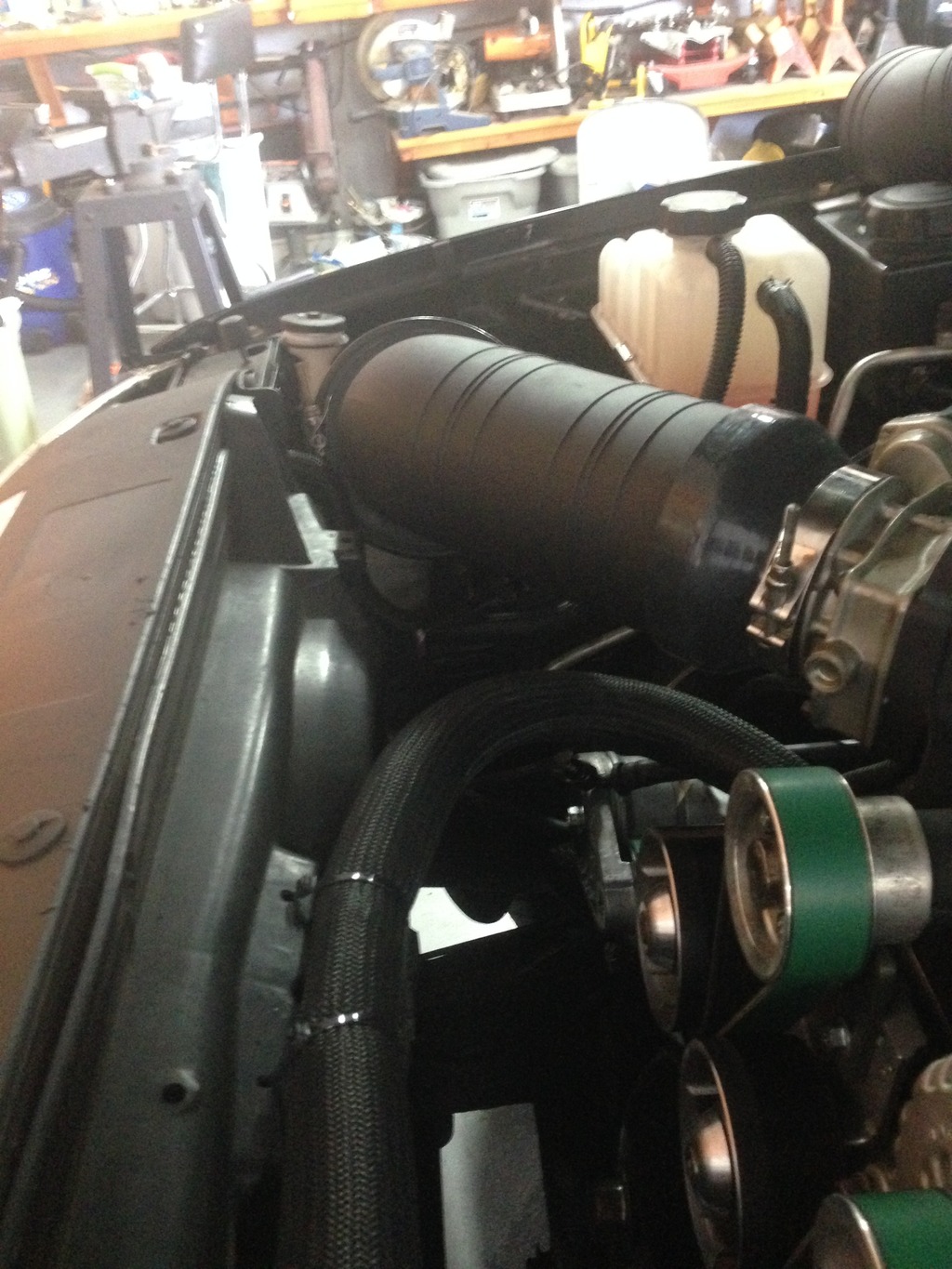

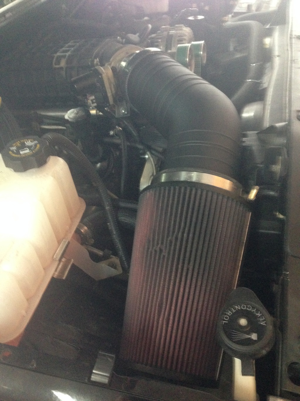

5in intake tube mockup. I need to order a 5in to 6in adapter for the air filter but you get the idea.

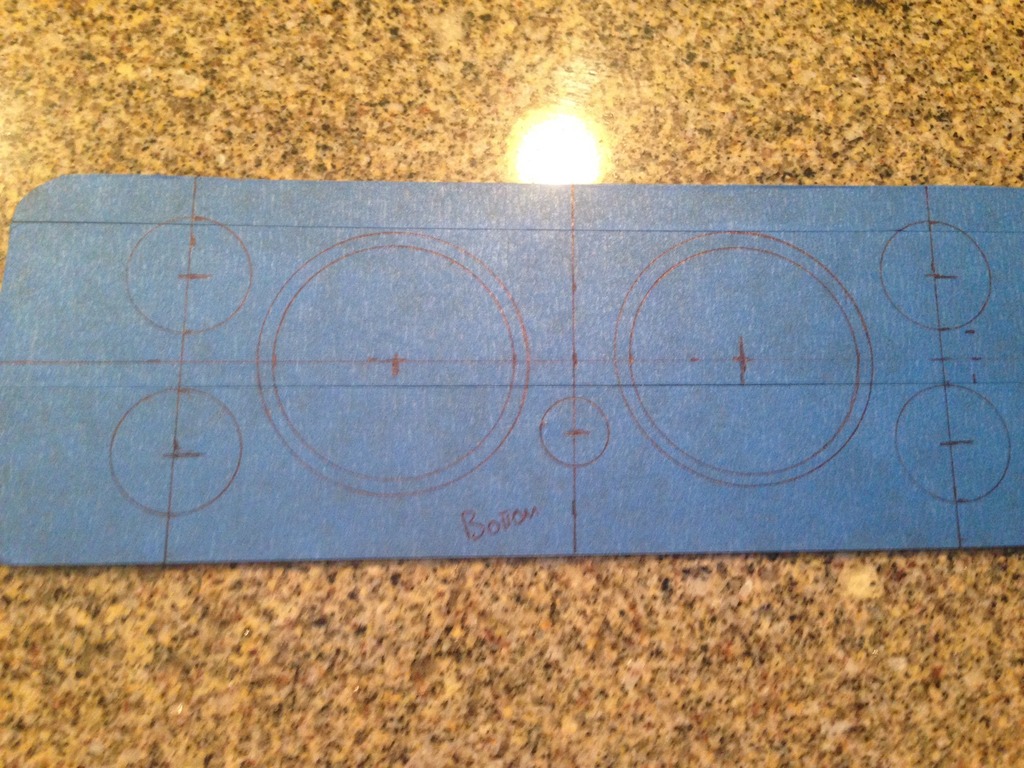

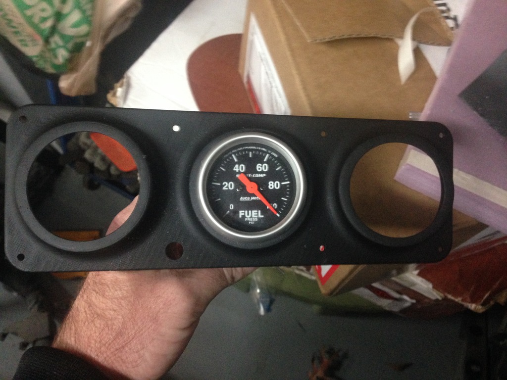

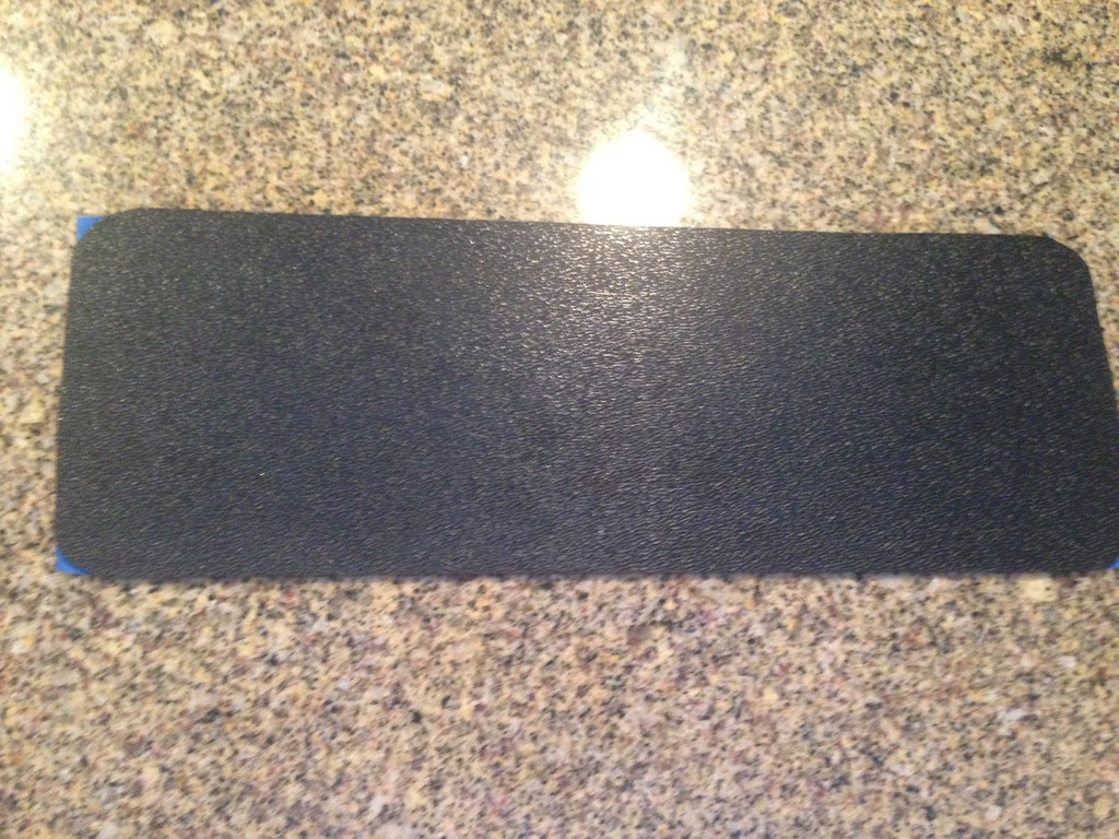

Plate for the console. I am going to mount 2 aerforce gauges, seat heater switch, 2nd fuel pump switch, USB plug for stereo and Sub gain ****

<p>Intake looks killer!!</p>

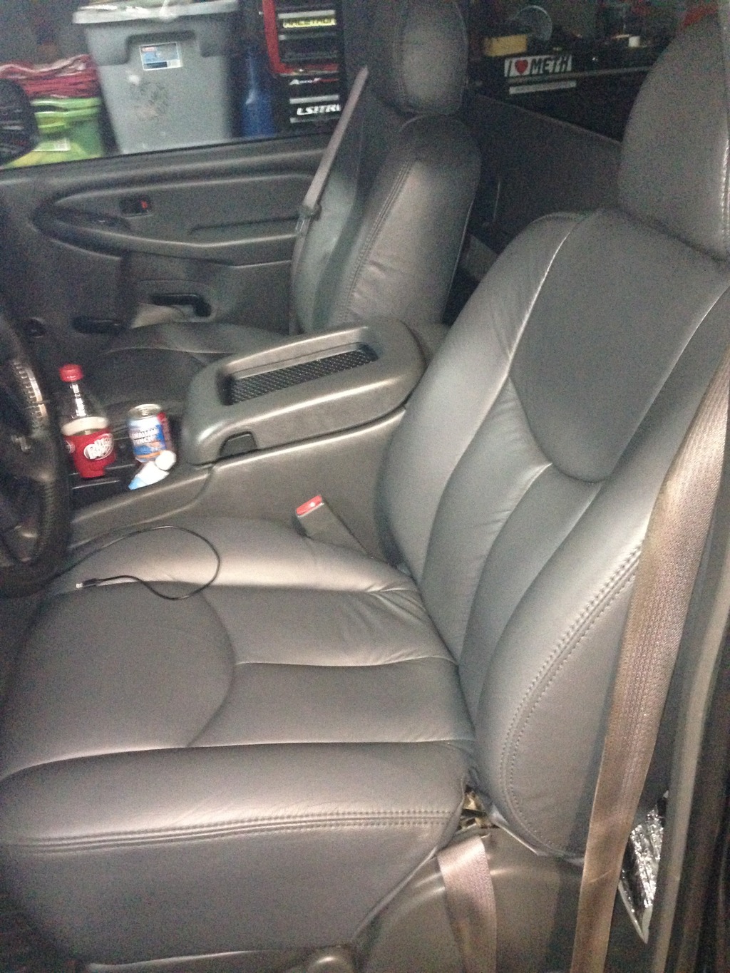

I added some Katzkin Leather and a full length console

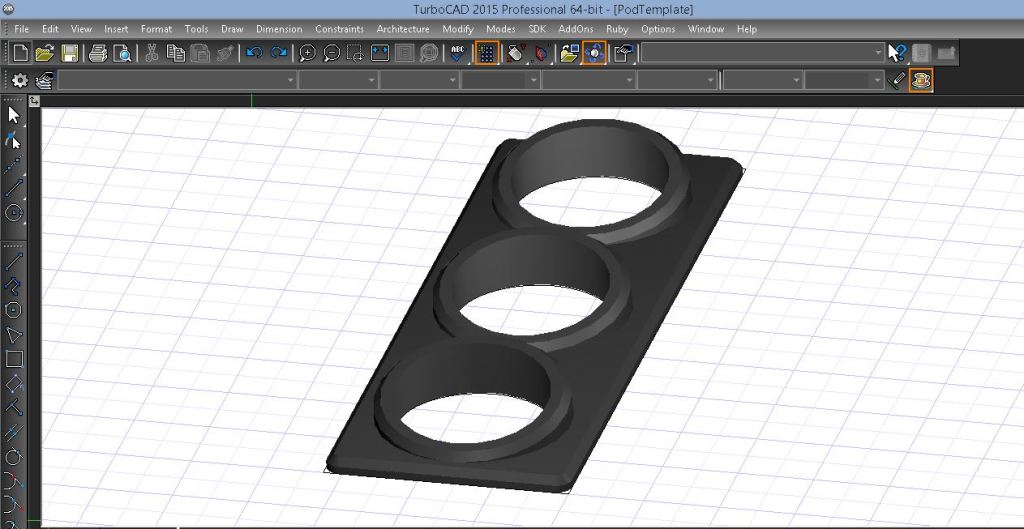

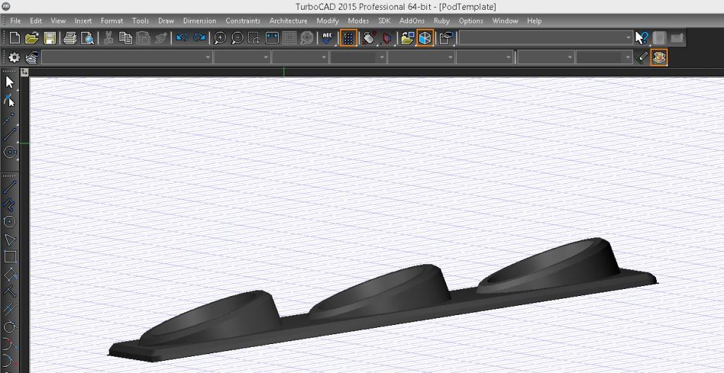

Then i decided i hate my 3 gauge pillar pod soooo since there is really not a better option, i decided to make a gauge pod myself... Sooooooooo i taught myself TurboCad and designed one, then sent it off for printing. Turned out pretty good. The gauges have a 10* tilt towards driver and 5* tilt upwards...
Drawings

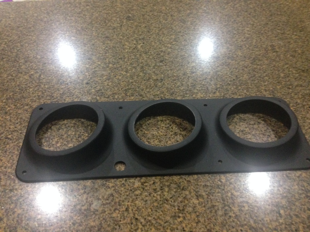

Printed
