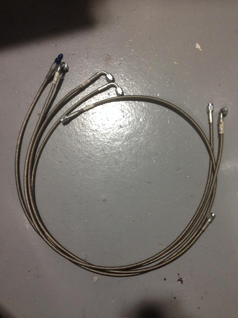

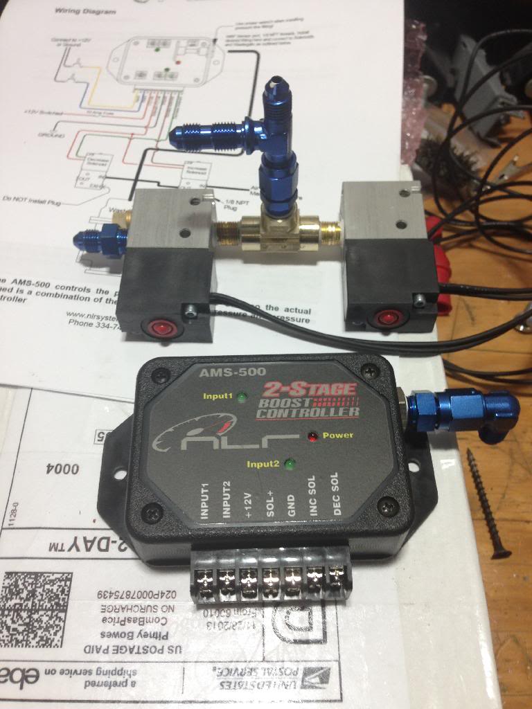

Sooooo i figured it was time to finally up the boost so i ordered a AMS-500 dual stage boost controler. Still trying to figure out where to mount everything and measuring for all the -3 teflon braided lines to hook everything up.
Pile of lines, these are leftovers hopefully they fit somewhere

Likes: 438
You know stainless line and AN fittings is way overkill for that right?
Old Dec 4, 2013 | 11:01 PM
  #294
BlackGMC's Avatar
Resident Retard
iTrader: (31)
Posts: 17,216
Likes: 20
From: Fort Worth - TX
yep i know. All my air lines are like that. I used to have all rubber lines and it worked fine until one died, that is when i switch them all over so know i don't have to worry about it.
Also it realy isn't that expensive. One of the lines are like $15. I buy them premade at a circle track race shop.

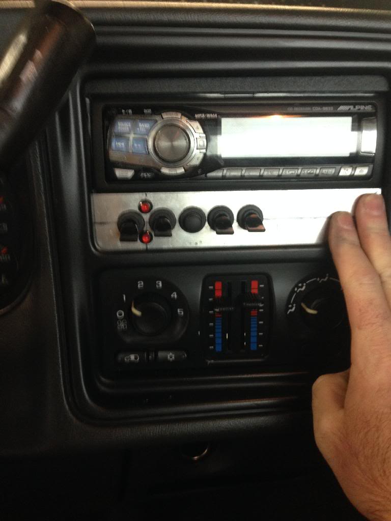

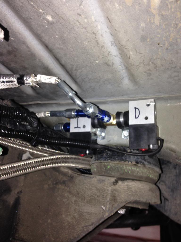

I got everything all plumbed up just working on the wiring. So i will be able to run 3 stages of boost. Off the spring 6lbs, stage 1 8lbs, stage 2 12lbs. Something like that.
Solenoids mounted

Switch panel: stage 1, stage 2, meth test, fans low, second fuel pump
I still need to paint it
