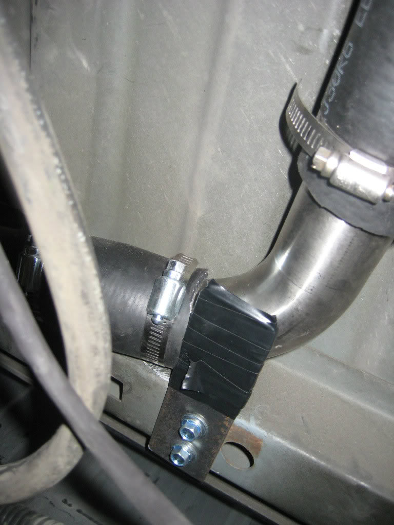

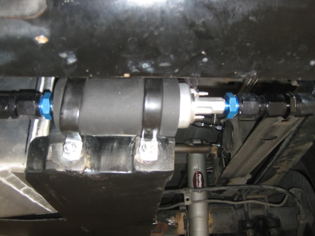

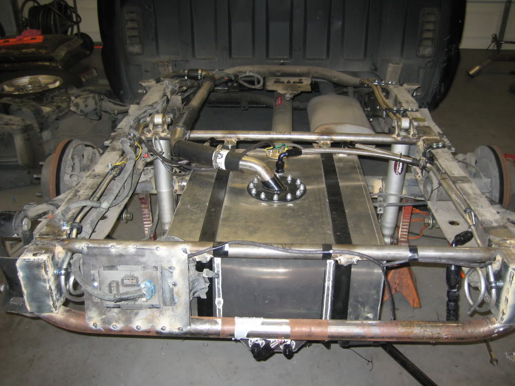

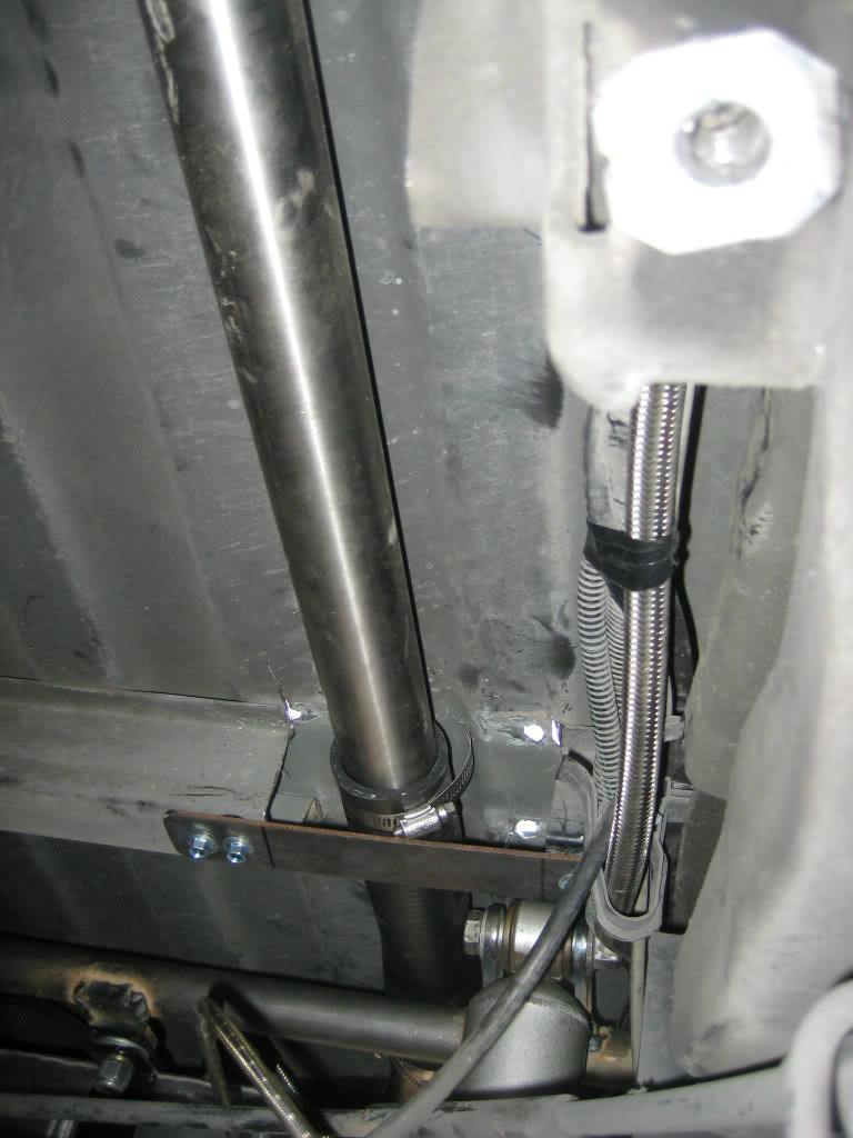

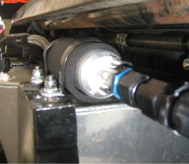

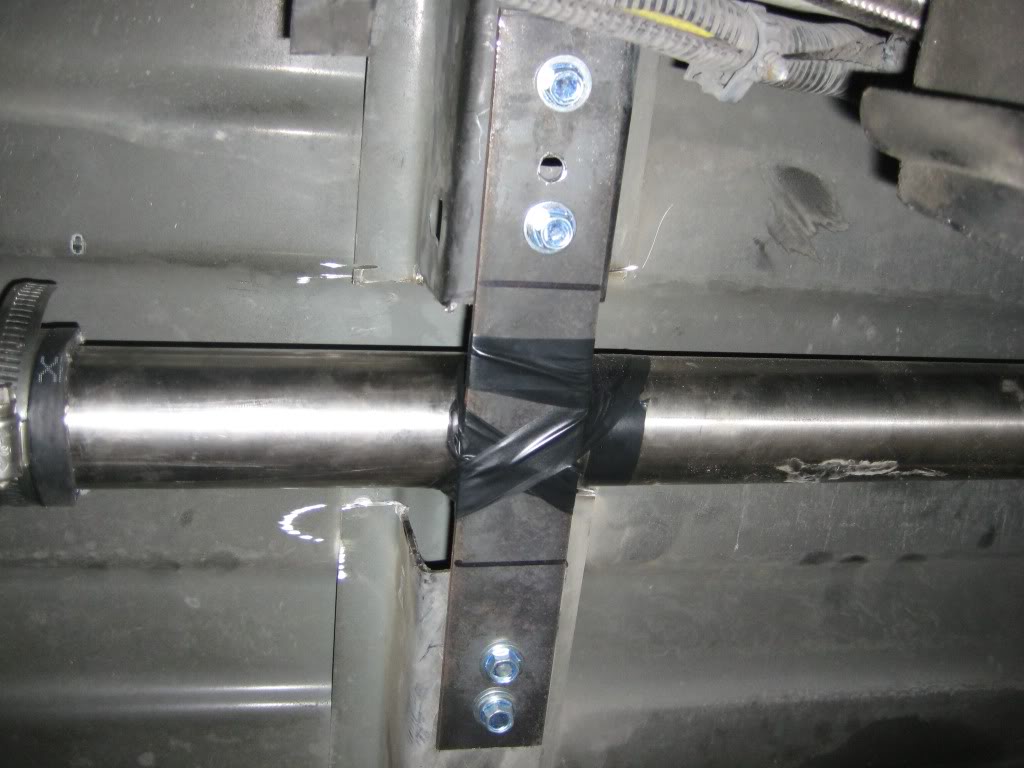

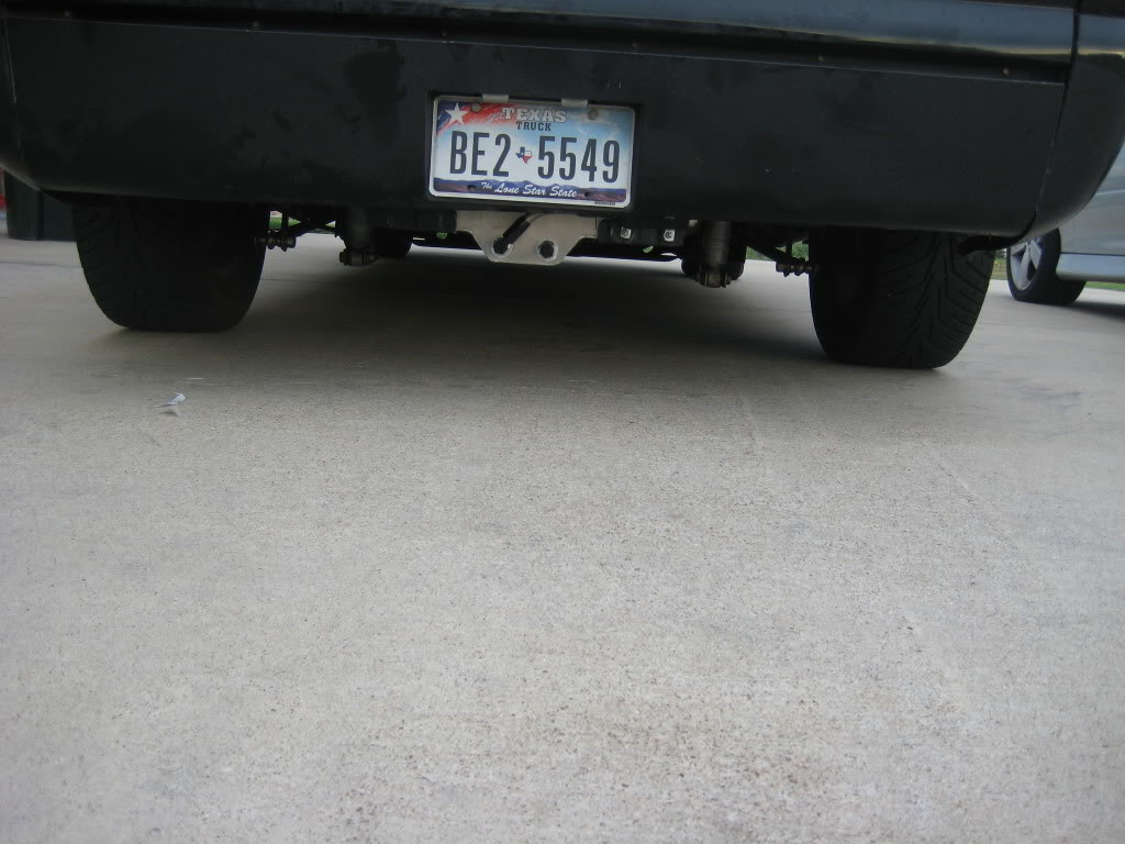

Here are the pics. Granted i still need to clean up alot of things but i just flat out ran out of time... Also i did not have any zip ties so i had to use electrical tape, sucks i know.... Anyways i am really happy with the way it turned out, ran into a few snags, like they sent me the wrong damn fuel sending unit, pretty pissed about that one!!! But thanks to a good buddy helping me we were able to get everything knocked out!!! lots more todo but it is a start in the right direction.
Middle notch, i need to go back over it and really secure the pipe but this will work for a few days.

rear notch, same thing here, i need to secure it.

Front bend going to the gas cap.

standing straight up the cell is slightly visible... I think i am going to paint it black so it is less obvious, or rear shape the roll pan to cover it

this me knelling down...
