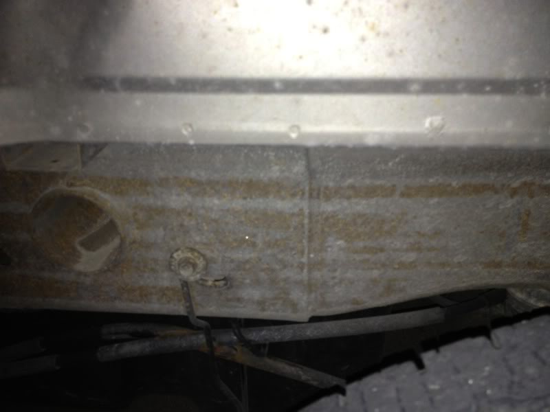

This is the drivers side frame rail. Would I cut it in front of the tire and then remove the excess material and slide the rear back I to the front?
Or remove material from the rear portion and slide it back together?
