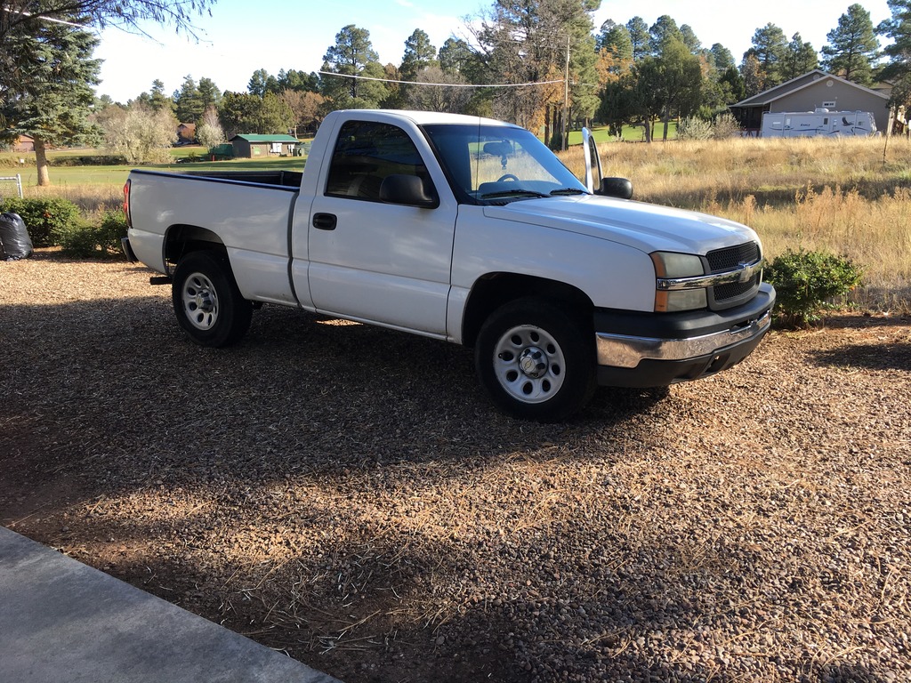

I came across a 84 foxbody, so I was going to throw everything in the foxbody and make that my project car. I put that plan on hold for a lil while to do family stuff with the kids and wife. Then one day after work I was looking on autotrader, and I stumble upon a little gem. I had found a 05 rcsb 4x4, flex fuel 5.3. Which is what I originally wanted before I started making plans for the foxbody. So this truck was 3 hours from me, but it was in the same town my mother and father in-law live. So I had my father in law to take a look at it for me. It was a used as a work truck, so the interior was dirty with trash all on the floors. It had 2 small dents on the exterior, but nothing bad. The original price that was listed, was $5900. After my father in-law talked to the guys at the dealer where it was, they said that they can't sell it, as it was a whole sale vehicle. After about 15 min of talking to the manager, my father in-law called me back saying that they would sell it to me as a whole sale item. No warranty, as is, no returns. And for me that wasn't an issue, since I had everything I wanted to put in it, engine and trans etc.
So the final price after the said I can have it as a whole sale item, $3700.
So the wife and I dropped what we were doing and drove up and picked up it.
That was 6 months ago. Since then, I have put my ecsb back to stockish, it's rocking a stock 6.0 and 4l80e. Everything else is stock, air box, exhaust.
The single cab is all torn apart, no engine or trans in it. I've been getting everything ready for the swap. Been cleaning it up.

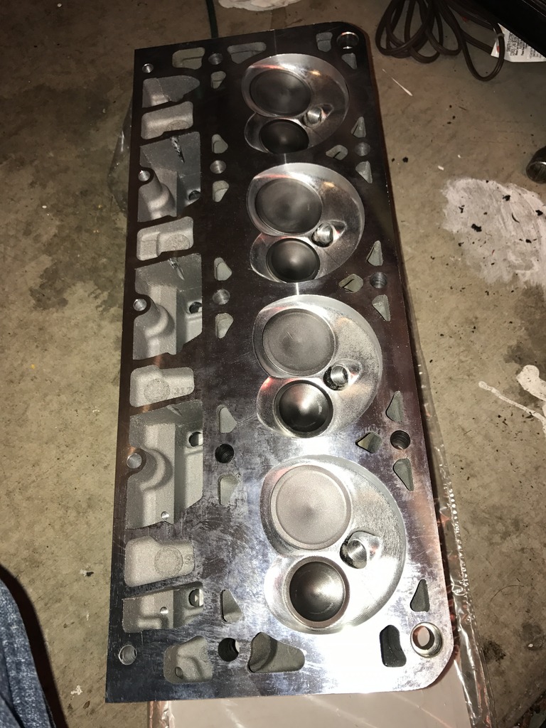

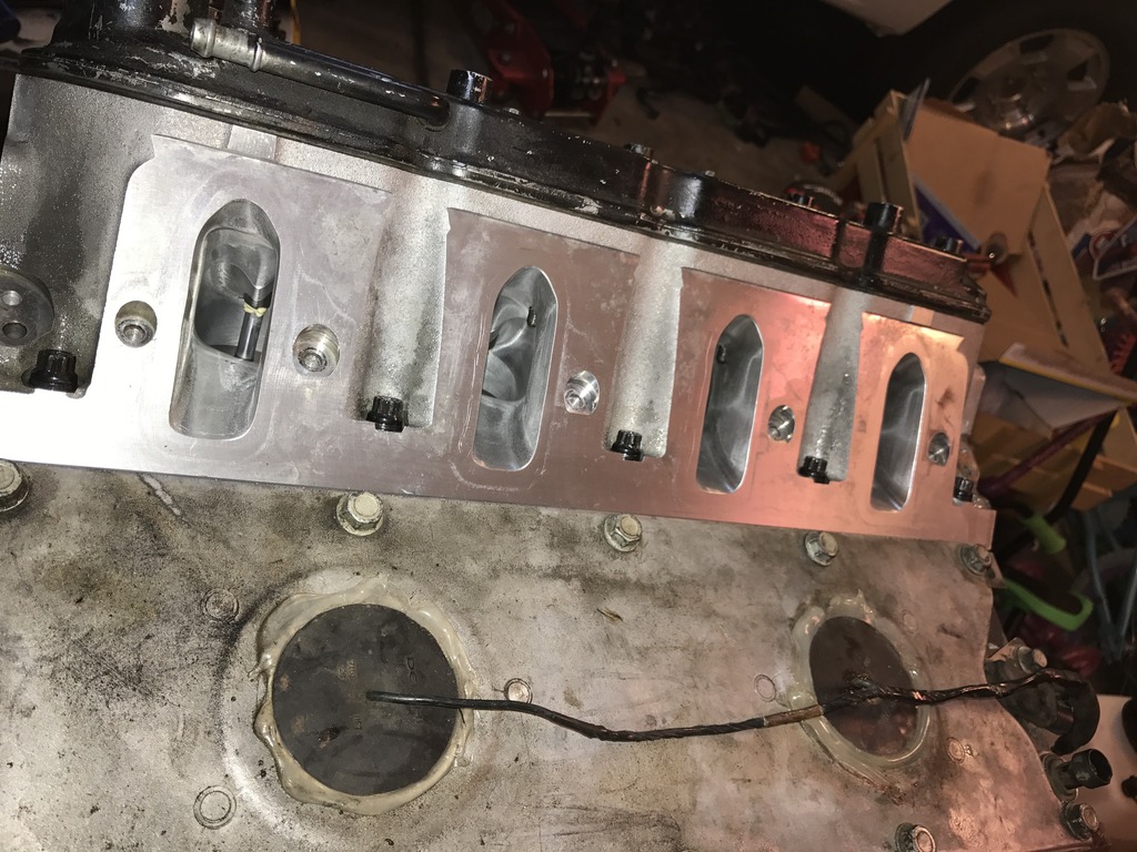

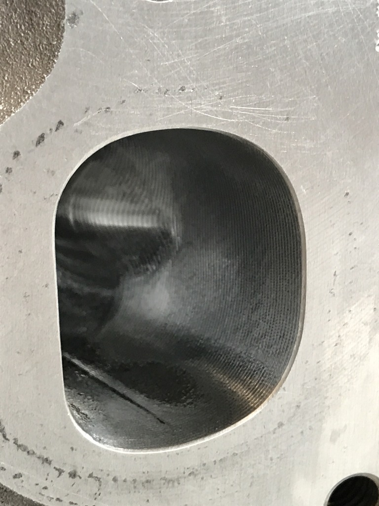

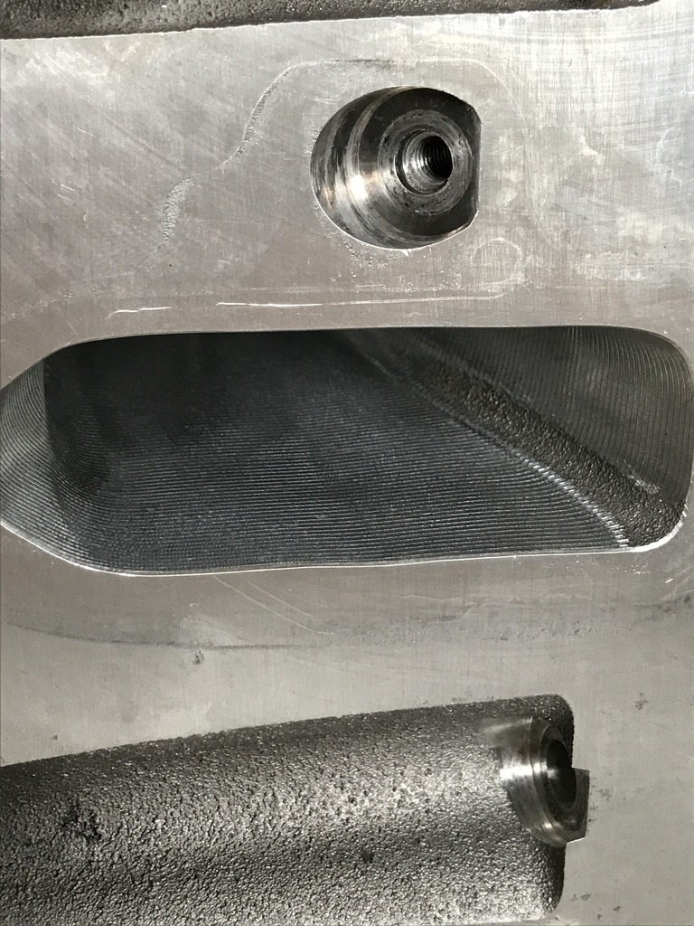

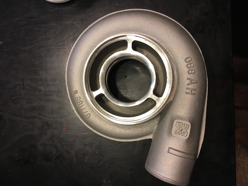

As far as everything else going into it, my injectors were cleaned and flow matched, my converter was sent back to yank, so it could be rebuilt. The trans was gone threw and had the clutches replaced and had the output shaft swapped to the 4x4 shaft. I have a new race cover for the turbo. Bought a turbosmart Eboost controller. My favorite part so far are the heads, I had the stock 317s worked over, cnc port and polished. They look awesome.

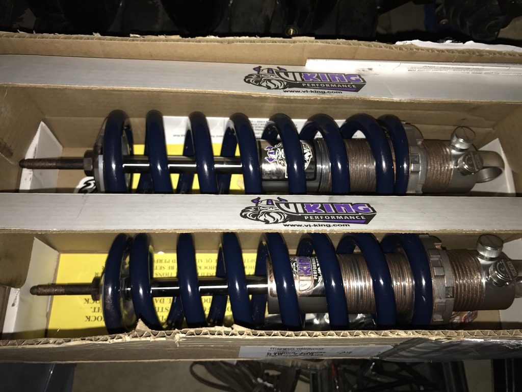

I almost forgot, I want to thank Richard for the coil over conversion brackets. I will be ditching the torsion bars for a set of Viking coil overs.
