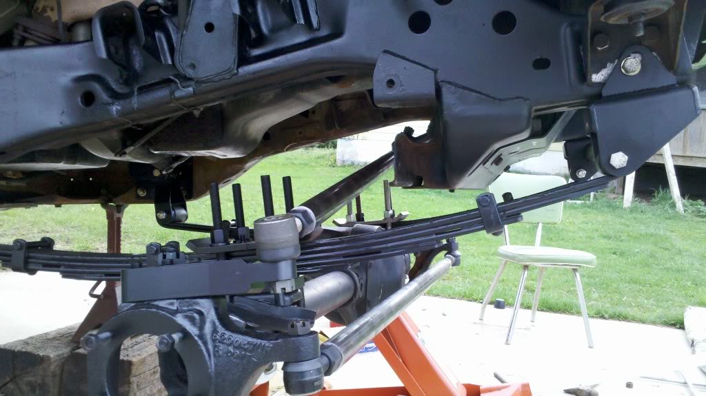

here's some tear down pic's and moke up pic's.
Had to move the spring perches out some.
