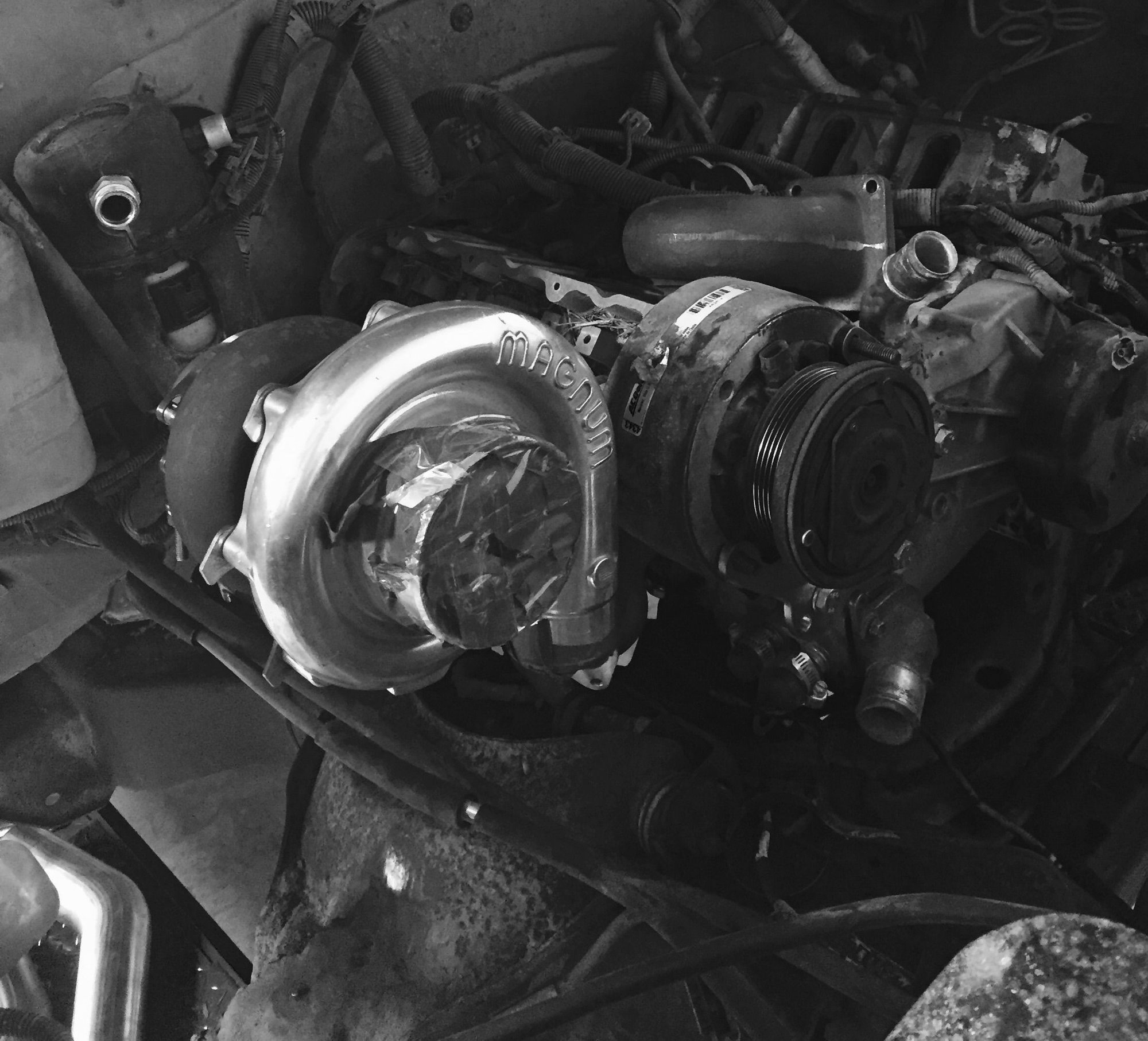

Like George said, The Buick GN's and T-Type Regals are like this. I've built hundreds of kits like this.

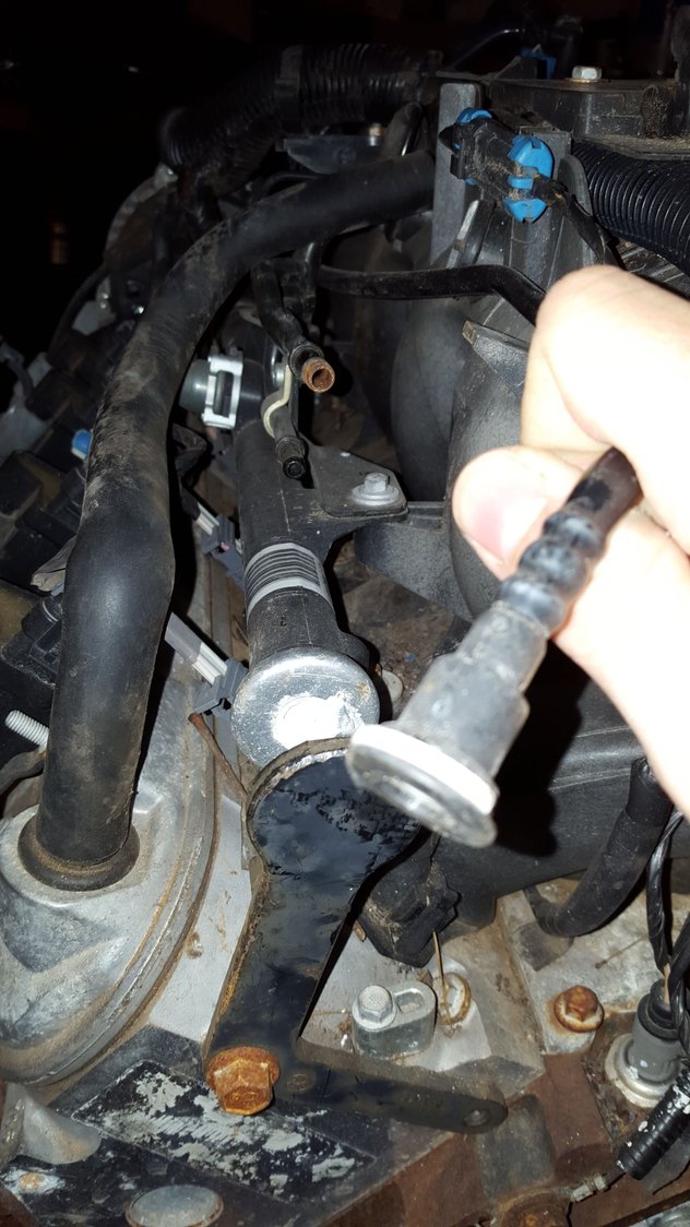

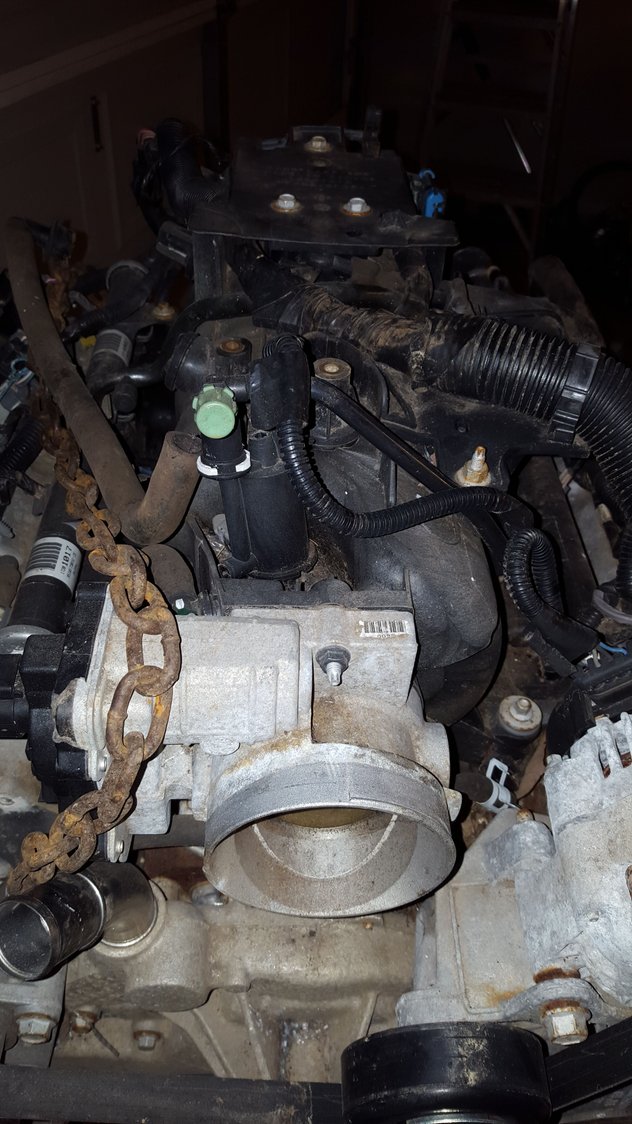

so i got most of the motor torn down this evening and i'm pretty sure my DBW motor is a 2003 model. My casting# 12567393. with that being said i've got several questions but will take one step at a time. So my FPR is located on the fuel rail and has a return line. what is this 3rd line for that comes off of a solenoid looking module behind the DBW.
Old Feb 2, 2016 | 02:38 AM
350SS's Avatar
iTrader: (36)
Joined: Feb 2004
Posts: 737
From: Houston, TX
evap system

Thanks for the reply. I hope I can do away with a lot of that crap. What about the coolant hose that comes of the back of the intake? What are you guys doing with that?
Old Feb 2, 2016 | 09:07 AM
350SS's Avatar
iTrader: (36)
Joined: Feb 2004
Posts: 737
From: Houston, TX
not sure what coolant hose would be back there...is it the vacuum hose that goes to the brake booster?
Old Feb 2, 2016 | 09:13 AM
1995gmc's Avatar
Registered User
Joined: Jan 2016
Posts: 11
yea im pretty sure your right. he was so nasty and dirty i just assumed it was a coolant line.
Old Feb 2, 2016 | 09:57 AM
1995gmc's Avatar
Registered User
Joined: Jan 2016
Posts: 11
i guess a one way check valve would work ok on the brake booster? since the truck pulls a vacuum at idle?
