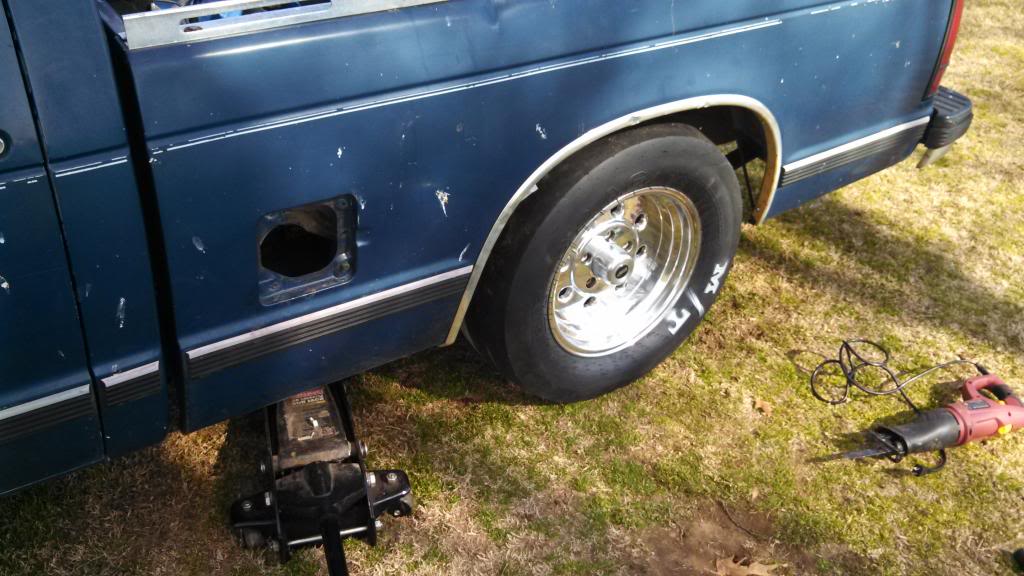

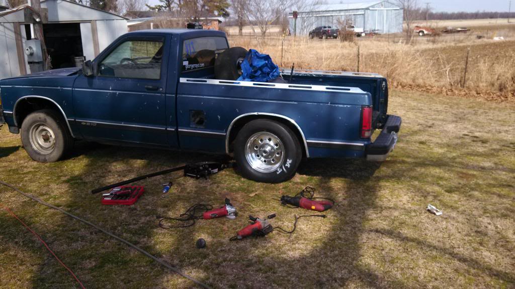

So this afternoon I got the other slick in from FEDEX finally!!

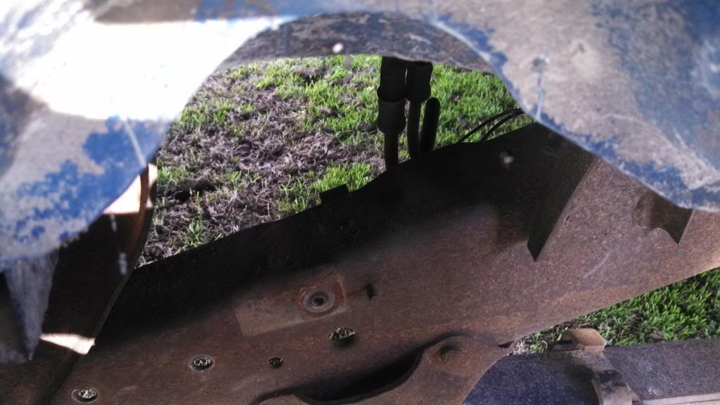

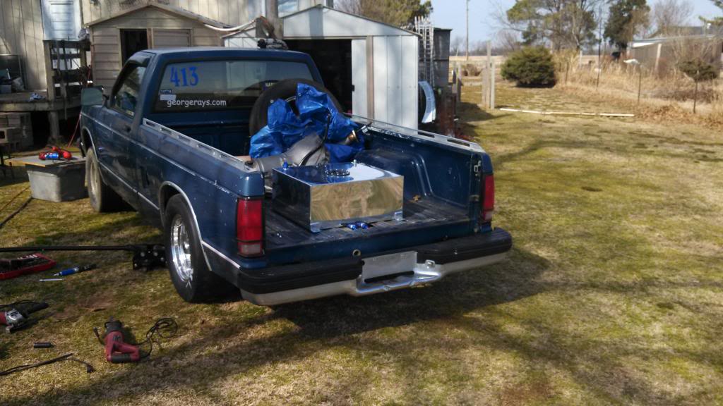

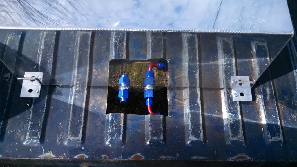

Got it on the wheel, and went out and got them put on the truck, also got the fuel cell mounted in the bed, kinda. I have 4 small screws holding it down for right now. I will be getting larger and longer nut and bolt assemblies for getting it mounted to the bed a lot better. I am contemplating using a large flat piece of plate steel across the mounting holes at the front and back of the tank. That way it should bolt down flat and not compress the ribs in the bed when tightening the mounts down.
Got the factory gas tank off the truck finally. Still have a couple things to get cut off and wire in the gas gauge feed from the new fuel cell. I will probably also use the fuel pump power wire that is already there to save me some wiring hassles.
More to come in about a week to 10 days when I finally get back in again.
Pictures of what got done today.
