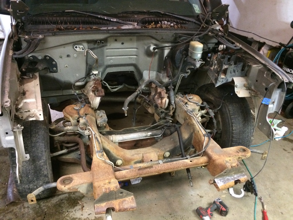

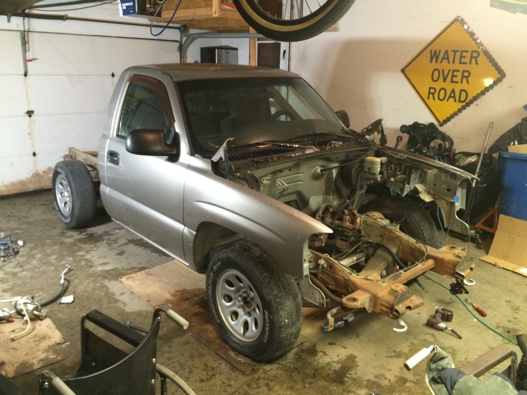

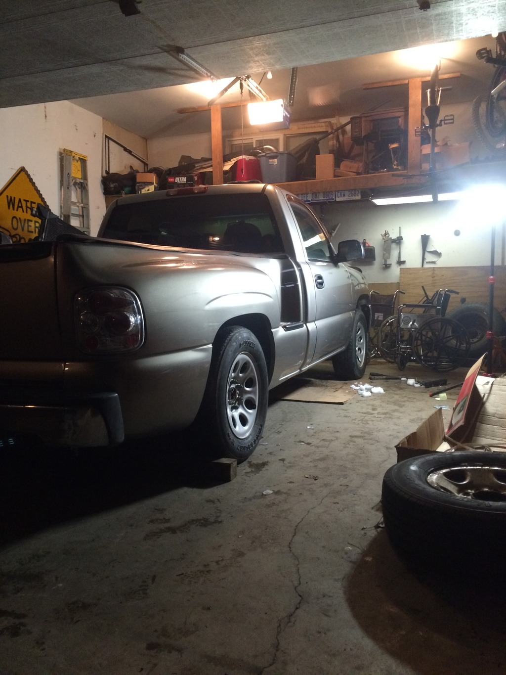

But time for an update. Its 4 AM here and I just came inside (Im used to being up at night as I work nights) but I went out and officially picked up the truck and got it home. It also is very torn down already.
A little background info on it: its a 2000 GMC Sierra, Pewter in color, SCSB 2wd and it is also a step side. The truck is 100% rust free as it came from Louisiana ( its a big deal here in Michigan), and has a few scratches and minor dents and the clear coat is peeling slightly. It was a v6 truck and the motor blew, the motor and trans were already pulled and in the bed.
When I got it in the garage
Got the bed pulled off
Core support/ front bumper/ engine harness off.

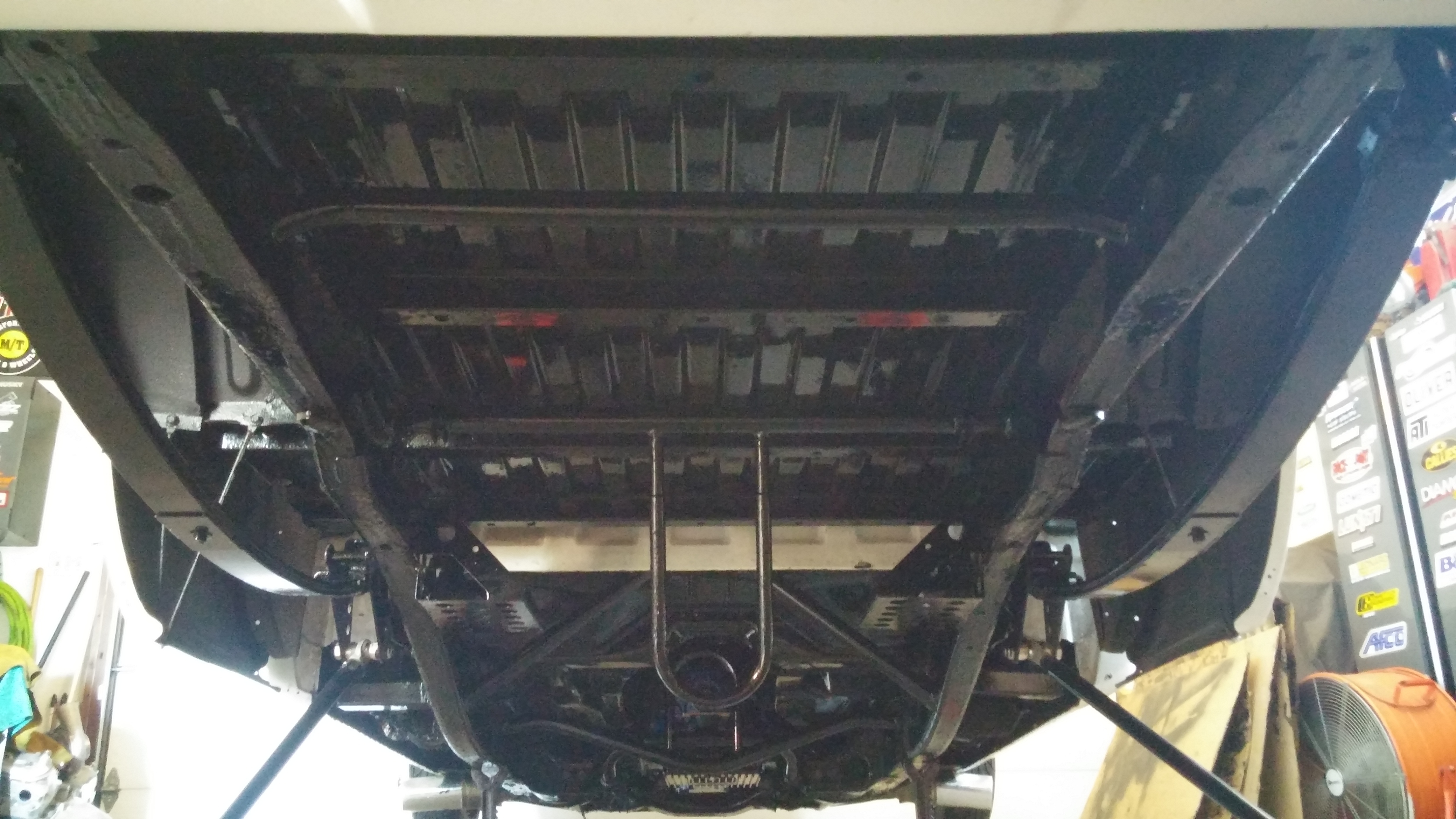

My old fuel system was 2002 bucket...ran that up until i went belt drive
I used rustoleum and used gallon and quart but also did my floor
