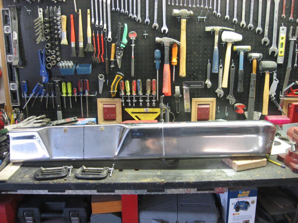

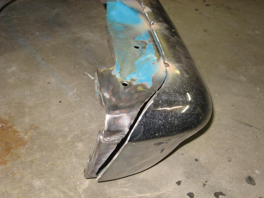

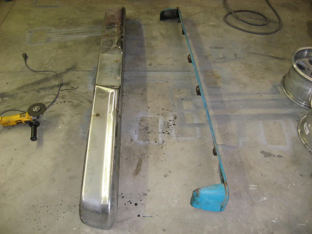

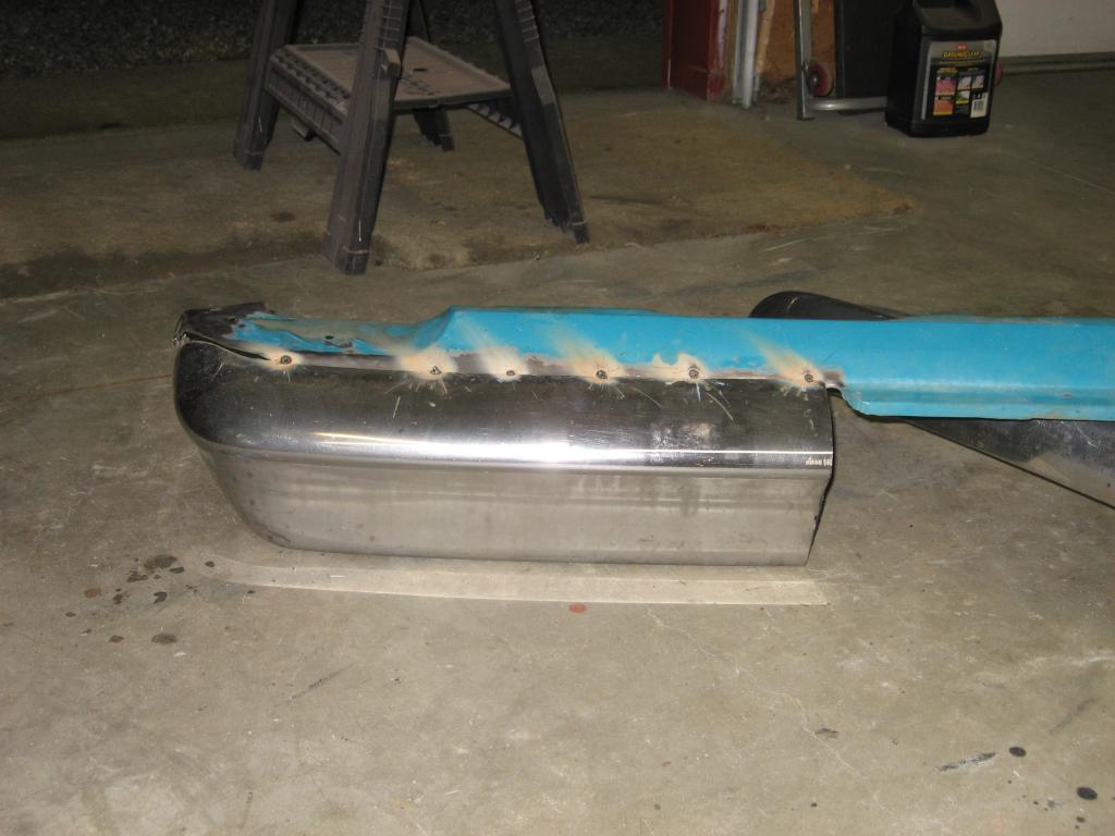

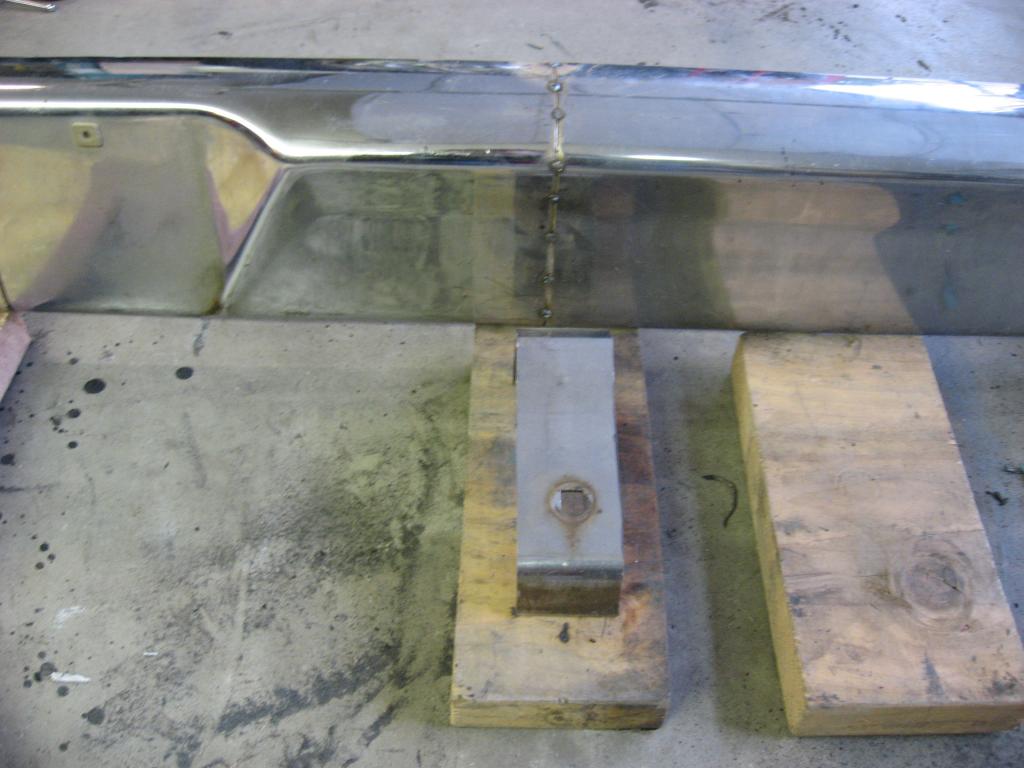

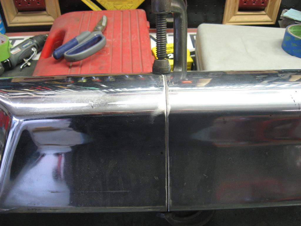

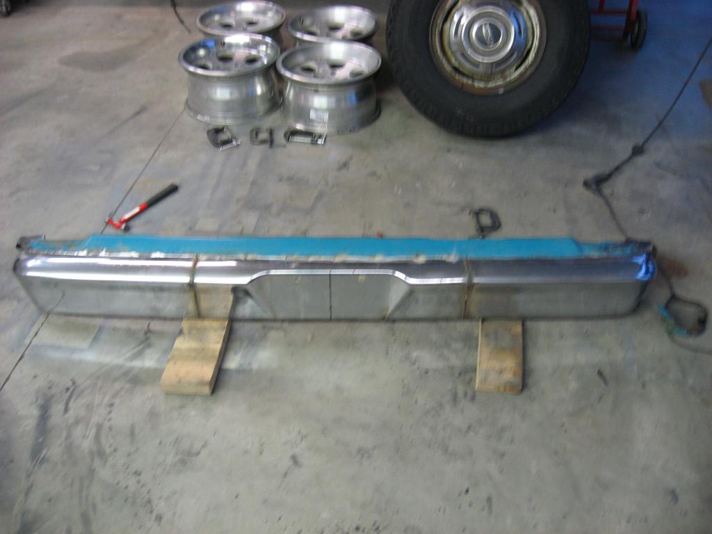

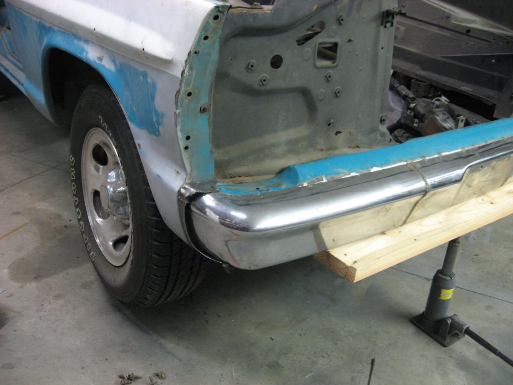

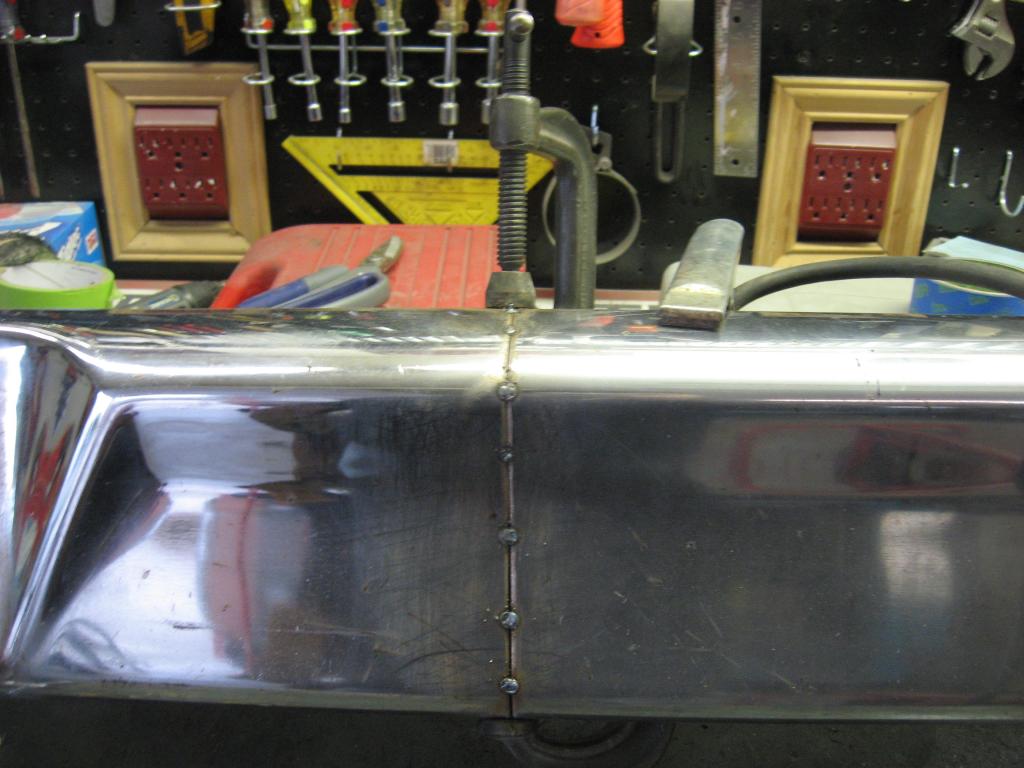

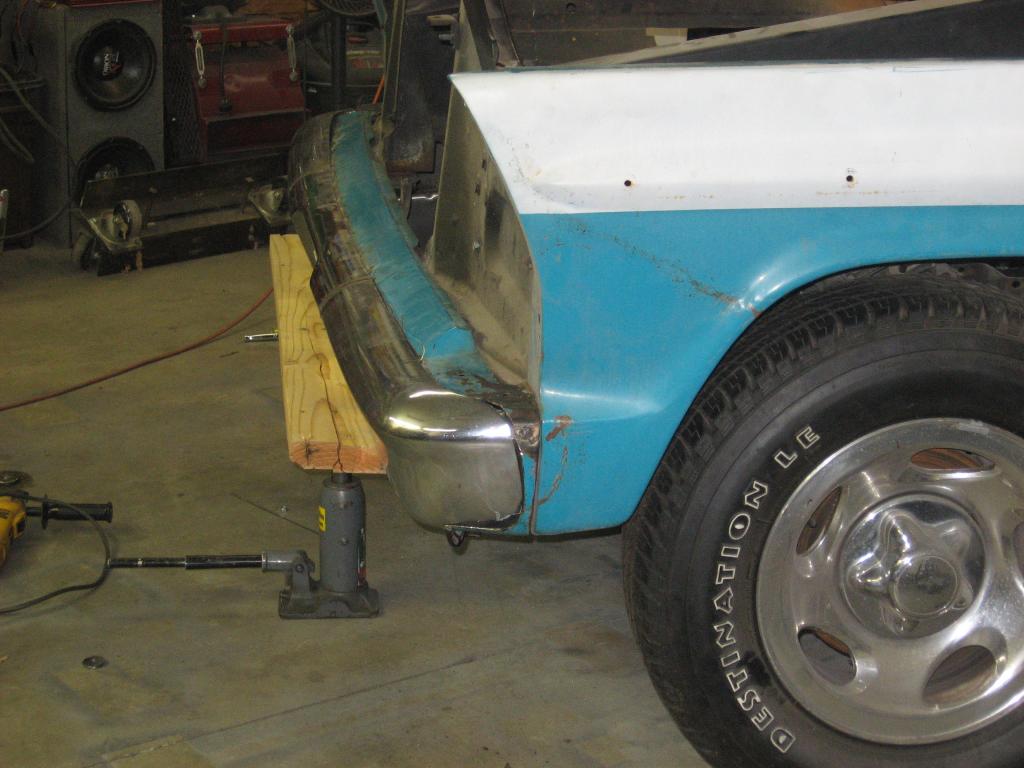

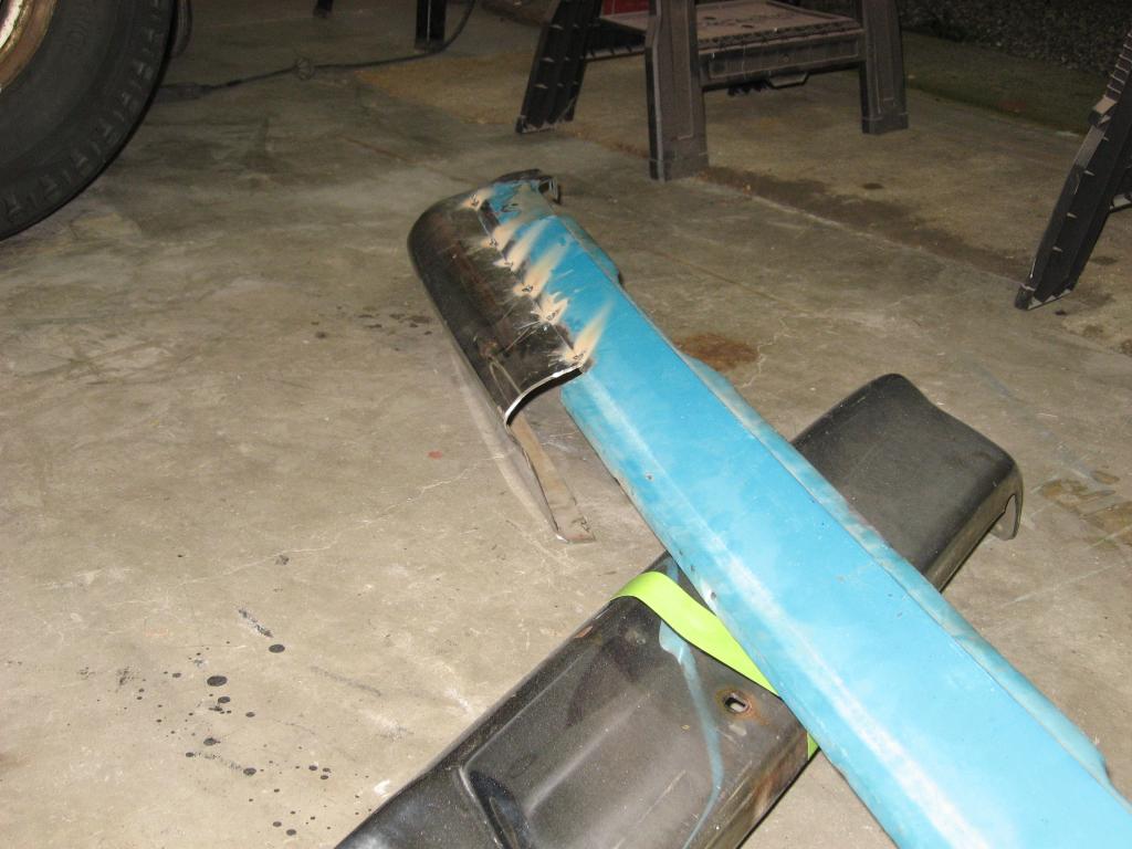

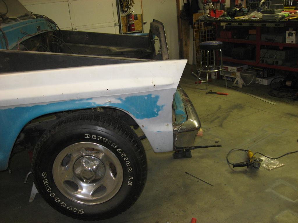

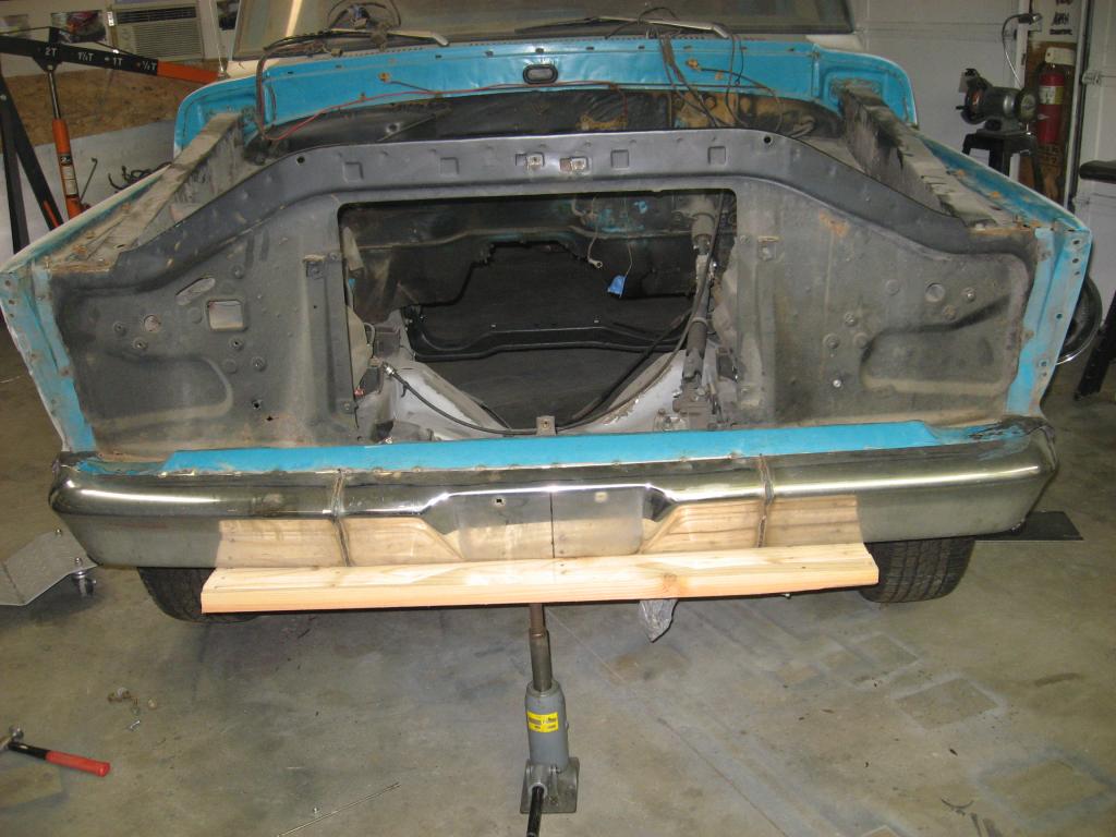

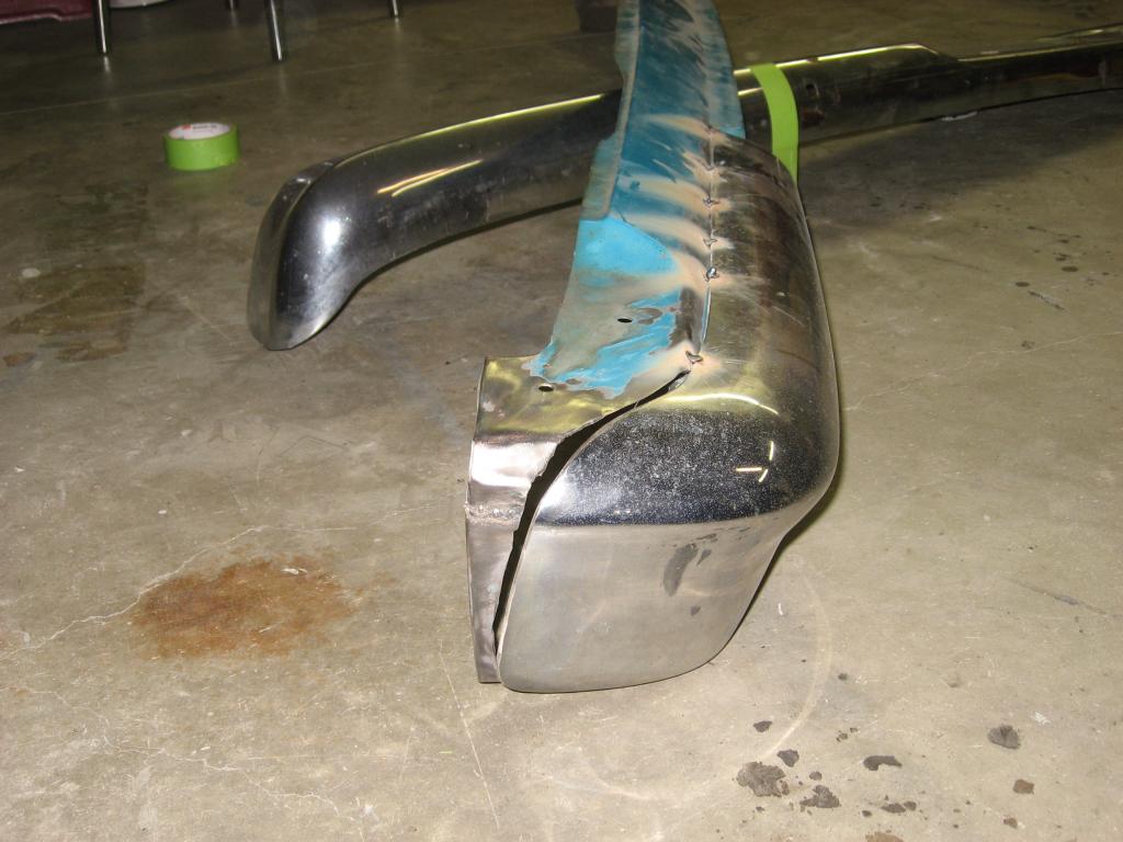

So after heating and beating one of my spare bumpers back into shape and almost straight again. I cut off one end of the bumper and matched it up to the stone deflector, marked off the end of the deflector to match the bumper and then cut it. I did this to both ends and that brought the ends of the bumper in about 2-1/4" I then chopped off the extra off of the middle section and welded the bumper back together and started tacking it to the deflector.

So this is what I have so far. I have more metal work to do to make it all smooth and fit together right, but you can start to see the idea coming together. I will body work it and primer it to see how it turns out before I decide if I'm going to use it or stay with a more stock look.
