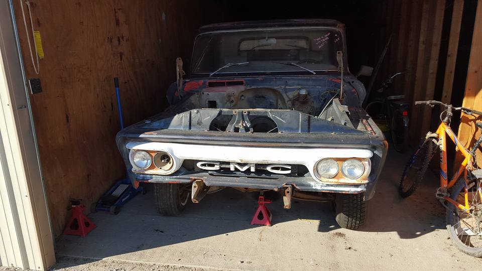

*Edit* Sorry Im not on here much, but here are some shots of the "new" GMC. Slowly gathering parts to put the engine together. Hopefully will have a T56 soon as well.

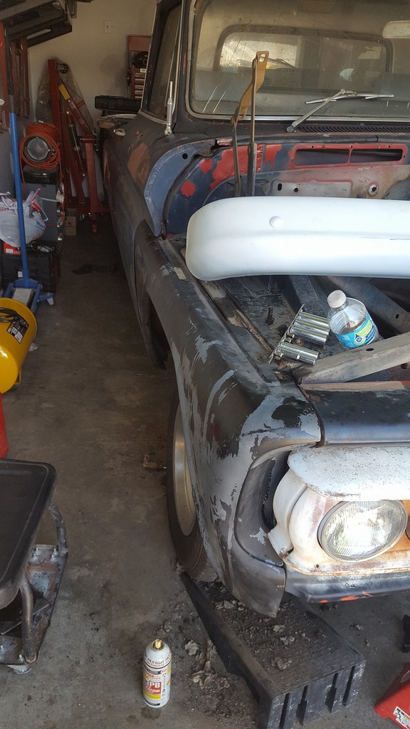

Finally got the truck out of storage and brought it home to our tiny 1 car garage. Name:  13698268_10153967600677763_4577173874268755523_o.jpg
Size:  92.0 KB Name:  13698282_10153967601242763_8633930488327570584_o.jpg
Size:  72.5 KB Got the front fenders swapped out for a cleaner set, and also got the bumper hung. [URL=http://s858.photobucket.com/user/73MightyMonte/media/Facebook/66%20GMC/13640857_10153967601907763_2235836314027890269_o.j pg.html]Name:  13640857_10153967601907763_2235836314027890269_o.jpg

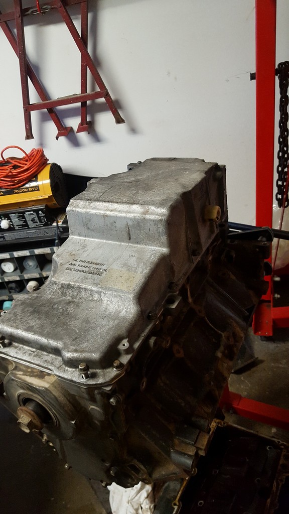

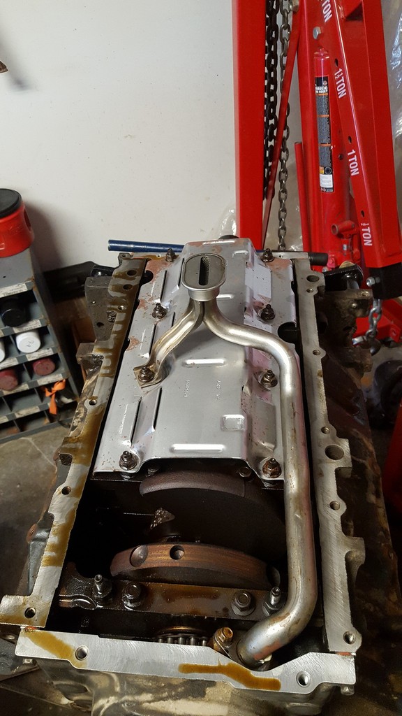

Freshened up the engine. All new gaskets, new lifters, btr stage 2 truck cam, and an f-body oil pan for optimal ground clearance. Name:  14445168_10154163755257763_7923607595821325076_o.jpg

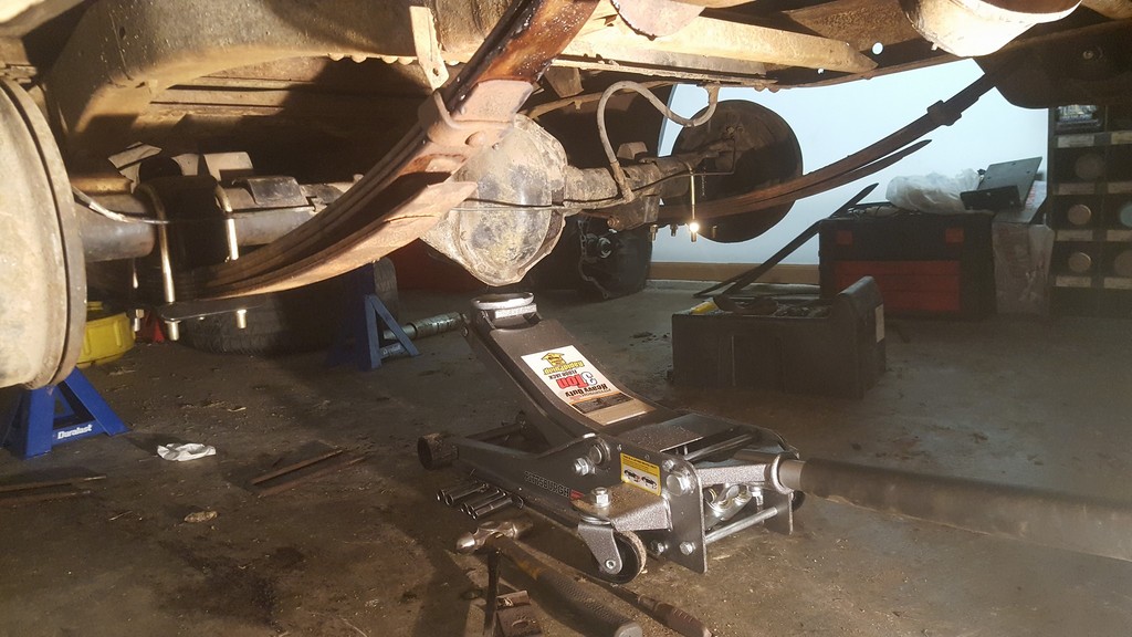

Started in on the rear suspension. Did a 6in. flip kit for a 73-87 C10 and found that it bolted right in. I also pulled the 3 overload springs on each spring pack. Not sure how low it will sit because the axle is currently resting on the frame. A notch will be in order. Name:  15000207_10154291743302763_9106520668704989180_o.jpg
