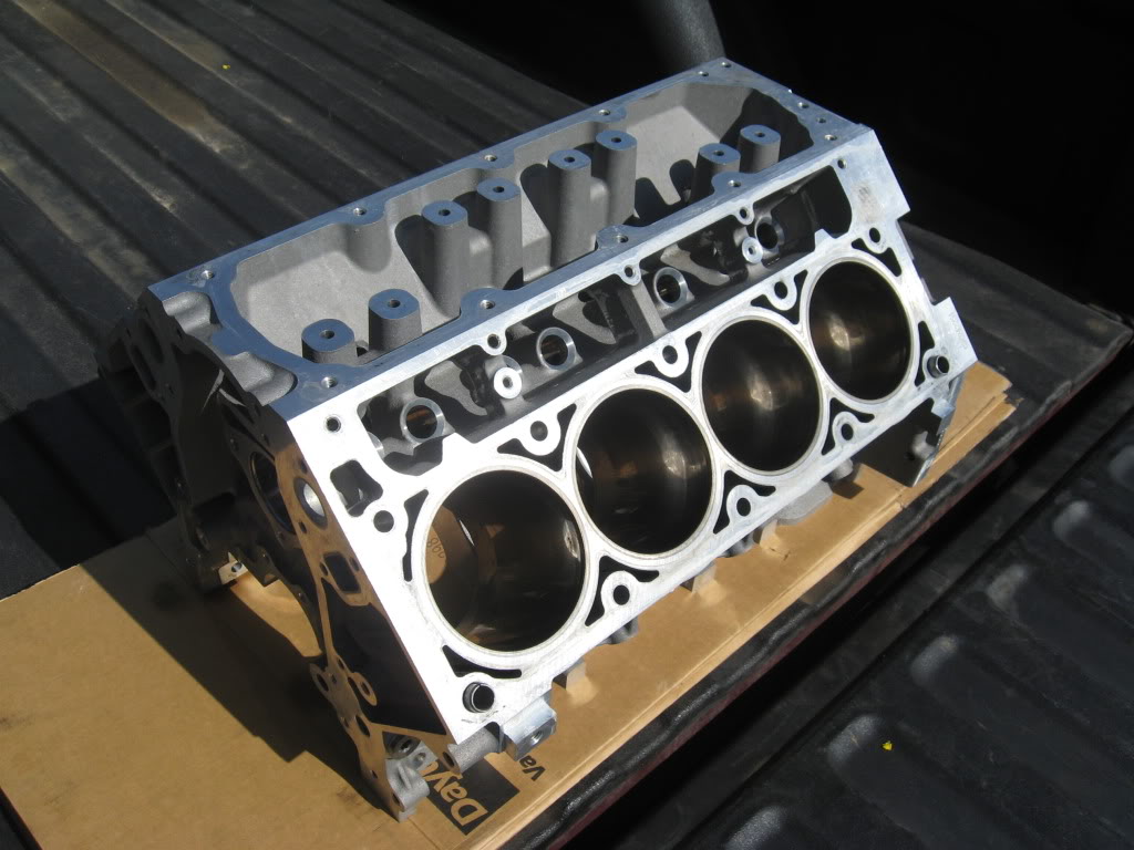

Old May 8, 2012 | 06:28 PM
smokeshow's Avatar
Mod with training wheels
Joined: Feb 2009
Posts: 7,741
Likes: 207
From: Detroit
Just picked it up from the machine shop. Work starts this weekend.

Old May 8, 2012 | 07:07 PM
TXSZ66AVLANCHE's Avatar
Joined: Sep 2010
Posts: 1,920
Sexy!

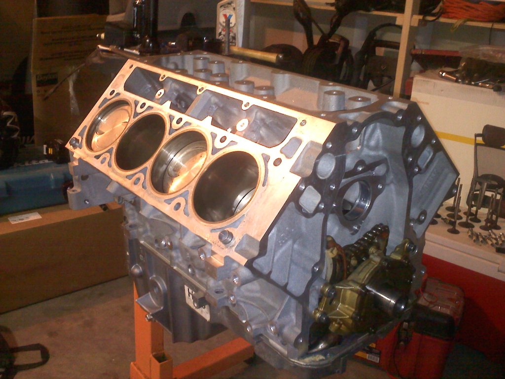

Old May 16, 2012 | 07:52 PM
smokeshow's Avatar
Joined: Feb 2009
Posts: 7,741
Likes: 207
From: Detroit
Got the short block back together... Took me a few days to do it, as I spent a lot of time making sure every piece was extremely clean before assembly. Not sure when I'll be dropping it in yet.
