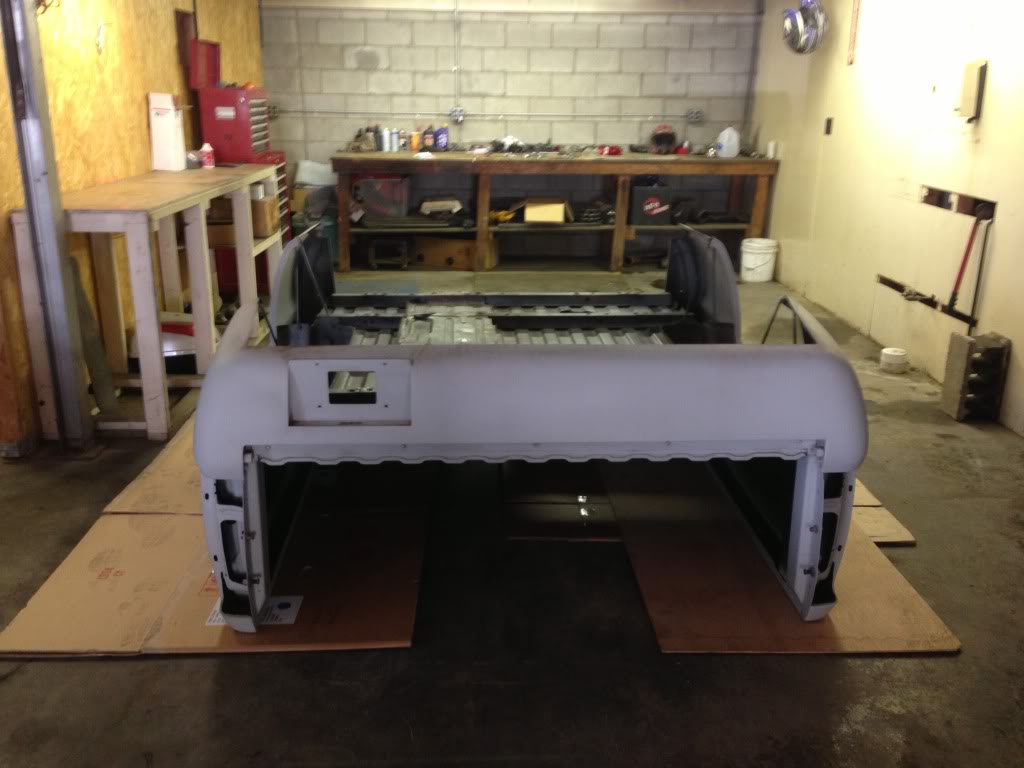

Old Jul 31, 2013 | 08:09 PM
  #53
Chevy_King1500's Avatar
Joined: Mar 2011
Posts: 2,072
From: Jasper, IN
