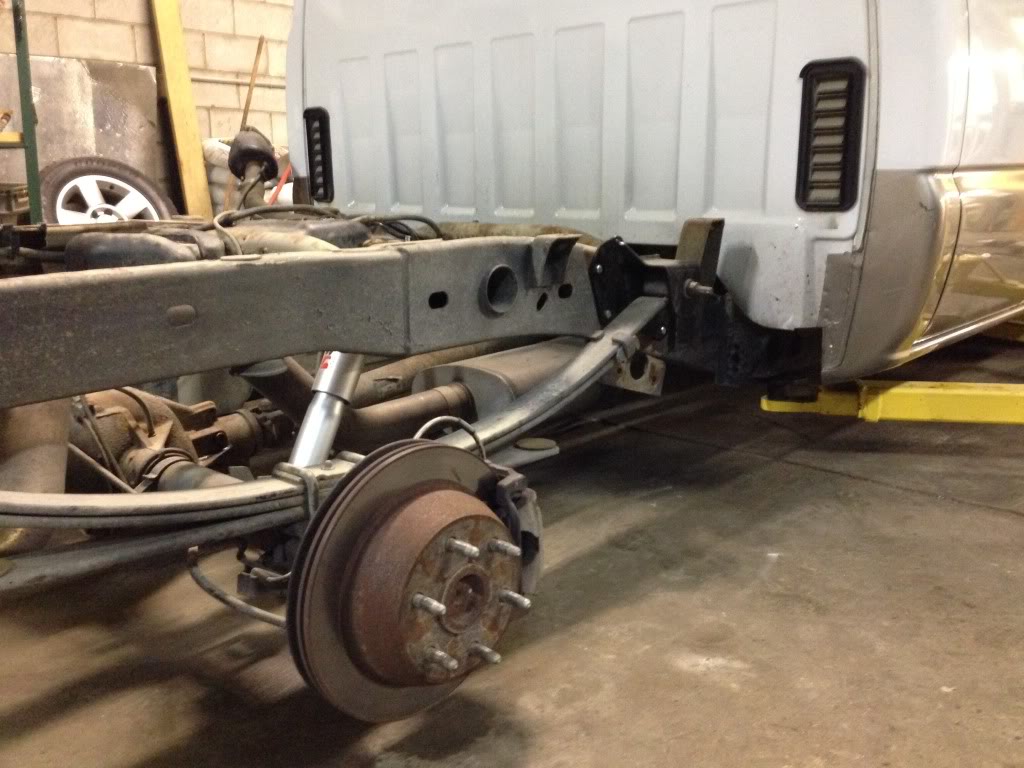

picked up some new tools on my lunch break today, put in some time after work and got the new hangers installed , also the new street performance belltech drop shocks.

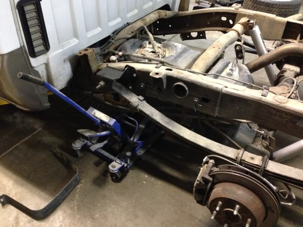

this little lift made it easy to install the fuel tank back in

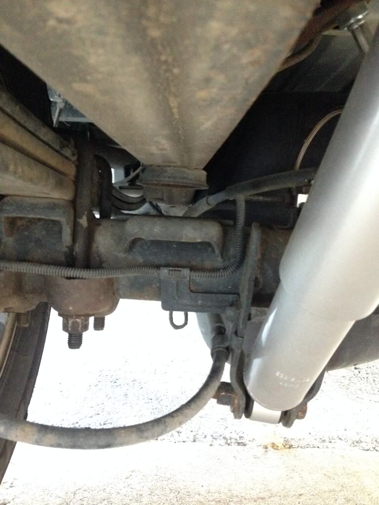

hit a small bump and the rear felt really rough, got back to the shop and found this lol. looks like I need a c-notch

Truck looks perfect, id just get some small button bumpstops for the front and back, thats what i had on my 4" rear drop and it kept it from bottoming out during normal driving unless i hit a big dip. But yeah you wont ever be able to haul or tow anything heavy without hitting unless you c-notch it.. just the way it goes :-/
Did you do the leaf spring bushings?

For the front I will trim down the stock stops and make those work. The rear I will do the c-notch for sure. I didn't realize how close is was going to be to the frame. I didn't do the leaf bushings. Once I get my own press I will, I diid not want to wait 2-3 more days on getting this thing done.
