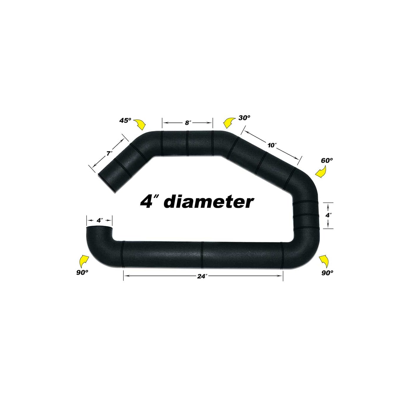

Also for some some that Tunes and is familiar with those trucks, He should know that is an early intake tube ment to clear a mechanical fan set up thats why it has a hard 90 in it. The later CAI tubes for E-fan set up trucks are not like that. The OP can get just a replacement CAI tube if he wants to.
Mine is also like that and really never thought about the 90 as a restriction. I hate that notch for the mechanical fan, looks stupid and probably disrupts the air before the 90. The thing is AFE's best CAI for GMT-800 trucks, the $365 Momentum GT has the exact same stupid tube. I wonder if any other manufacture has a tube that works with the AFE box on 800 trucks. Airraid has a universal "build it yourself" tube option.
Momentum GT
AirRaid

Originally Posted by RedXray
Nice looking SS
Momentum GT
AirRaid
AIRID sales just the tube by it self. I believe K&N does too.
I have the AIRAID Jr. Kit as that's all you really need.
it was shown on a dyno long ago. I think Blackbear did the testing. Various kits on the same truck back to back.
Ironically I have 2 Airid CAI kits I have never used but the boxes are damaged....
My research before I found the new open box AFE system for $90 (quite the deal) the Airaid jr tube is the way to go using the OEM box.
I've been contemplating pissing good money away on the $410 dollar Banks Ram Air system with the optional $199 "super scoop". Not because it actually has a horsepower gaining ram air effect... It's the under hood "wow" factor that nudges at my wallet lol
