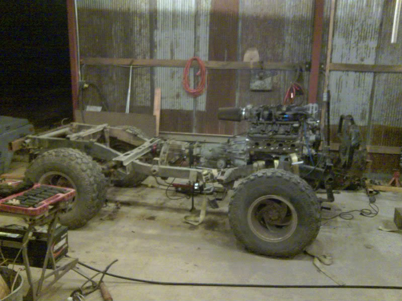

Boss gave me the Samurai, i took the 4.8 out of the S10, found a 60E and rebuilt it, NP241 out of a '90 Suburban, Toyota Axles.
Here it is with the drivetrain sittin in it for a test fit.
It fits way better than i was expecting, and the ls1 S10 swap headers fit like a charm..

Tonight im pulling the stock Sami springs/axles out and start on the Jeep YJ spring brackets and trim the rest of the stock brackets off the frame.
Using a 97 Sidekick Fuel tank since its 12 gallon and had a electric fuel pump and bucket, Putting a Walbro in it.

You got a flat right front tire or something in that pic homie?? Looks a little crookerd hahaha... And hey, I don't know if you noticed but that intake is backerds too

Gonna run the airfilter in the cab so it wont get wet and dirty from riding in the creek and mud.
Yea i figured i would put the drivetrain in at an angle, ya know, to be different haha..
Took the sami axles and springs out, put the toyota axles and YJ springs under it last night.
