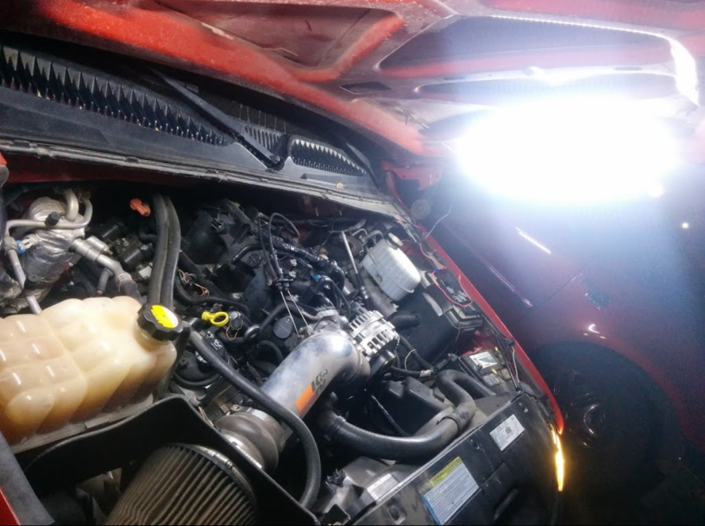

Good looking build. Where did you get that cluster?
Old Apr 29, 2016 | 06:14 PM
  #42
matte99's Avatar
Joined: Sep 2015
Posts: 70
From: sherman tx
X2 on the cluster. Looks like you have gathered some pretty stout parts.
Old Apr 30, 2016 | 09:47 AM
  #43
2KRedSilverado's Avatar
Joined: Feb 2013
Posts: 261
From: Garden City, Kansas
The cluster just has an overlay from whitegauges. I just got it cause it has a tranny temp and put the overlay myself and painted he needles red.

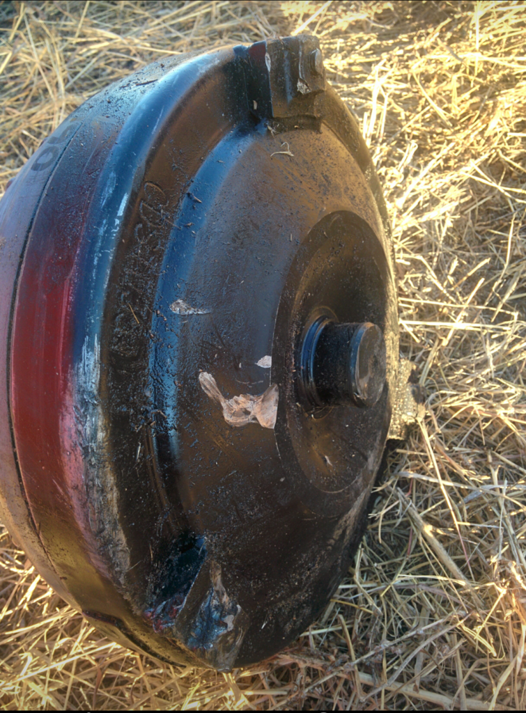

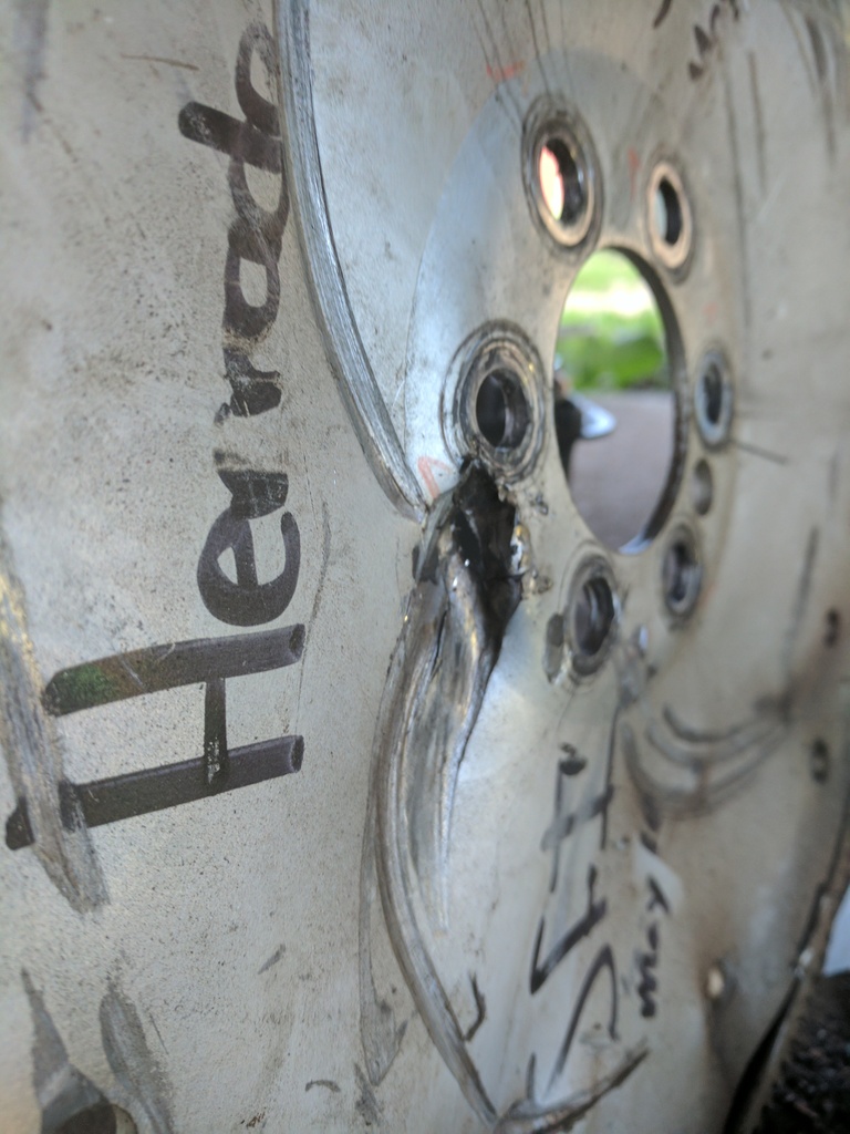

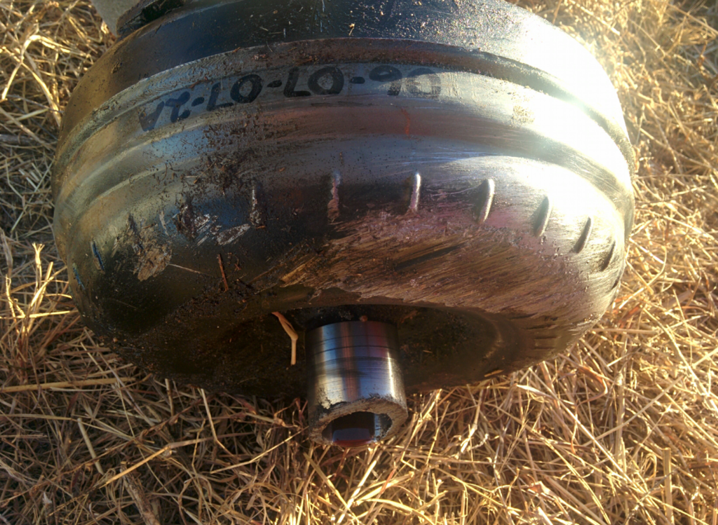

This was all short lived as I was being stupid and the stock DS gave out on a run. This was the carnage.
Notice the ARP bolts were completely sheered off on the converter and it was actually spit out, found it laying on the floor.

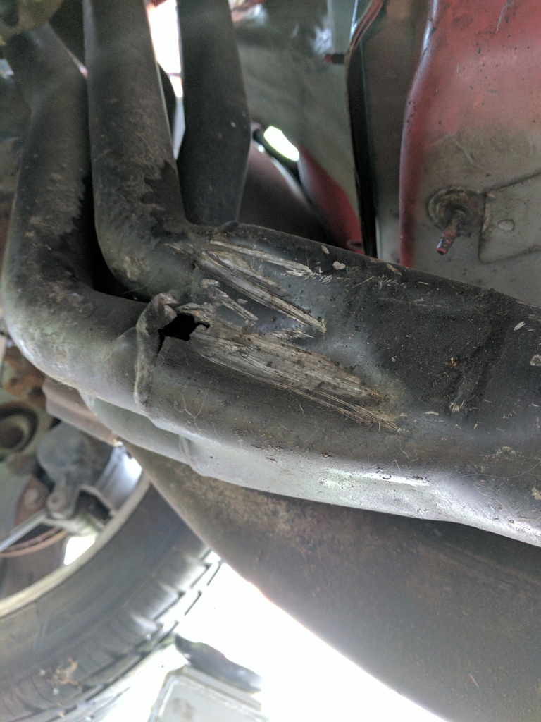

Gauged a hole on my passenger side collecter

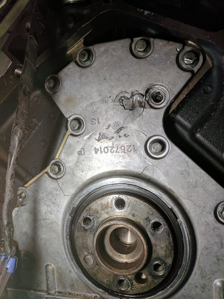

cracked rear cover from the flexplate hitting it and an ARP flexplate bolt got sheered off on the crank as you can see. Any ideas on how to get this thing out?

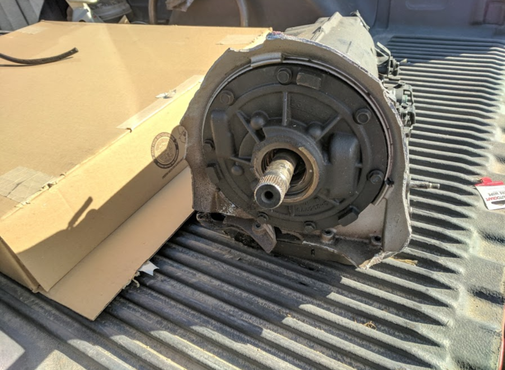

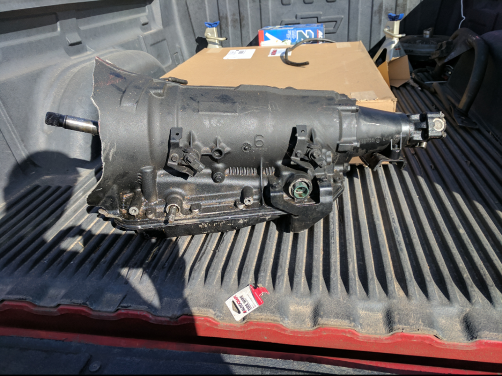

And the Trans....
