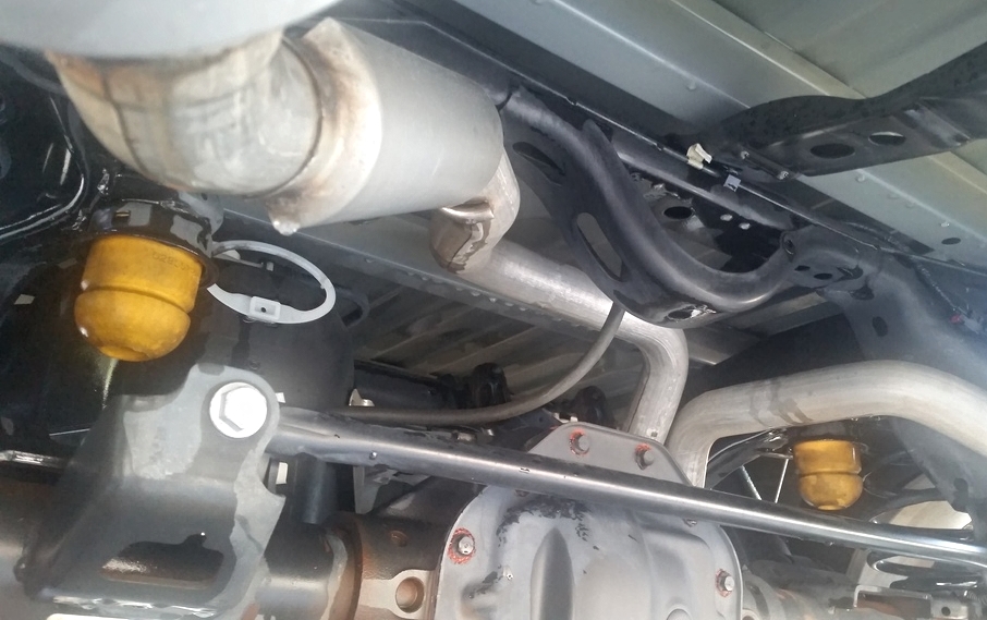

chassis is clean:

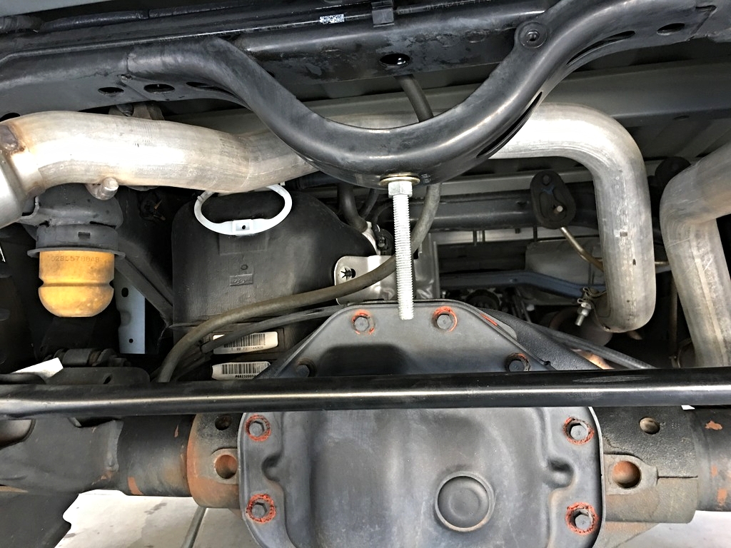

going to use this bolt as a reference to mark the initial rear end position and any subsequent side to side movement:
