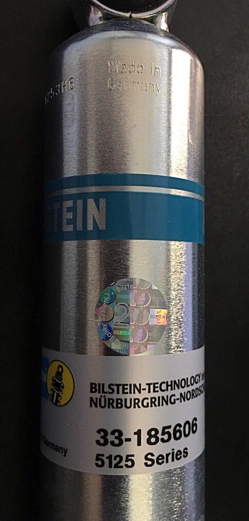

Very good apparent build quality on these shocks:

Uhhhhhh, these rear bilstein 5125's are damn awesome! Without a rear swaybar the rear of my truck is a totally new (read better) handling beast.
Really impressed and surprised.
Of note, my seat o'butt meter is telling me the rear sits higher now, will take measurements when I get home to confirm ....
Wow, what a difference!
Funny that my stock rear shocks are Tokico and my stock front shocks are Hitachi......

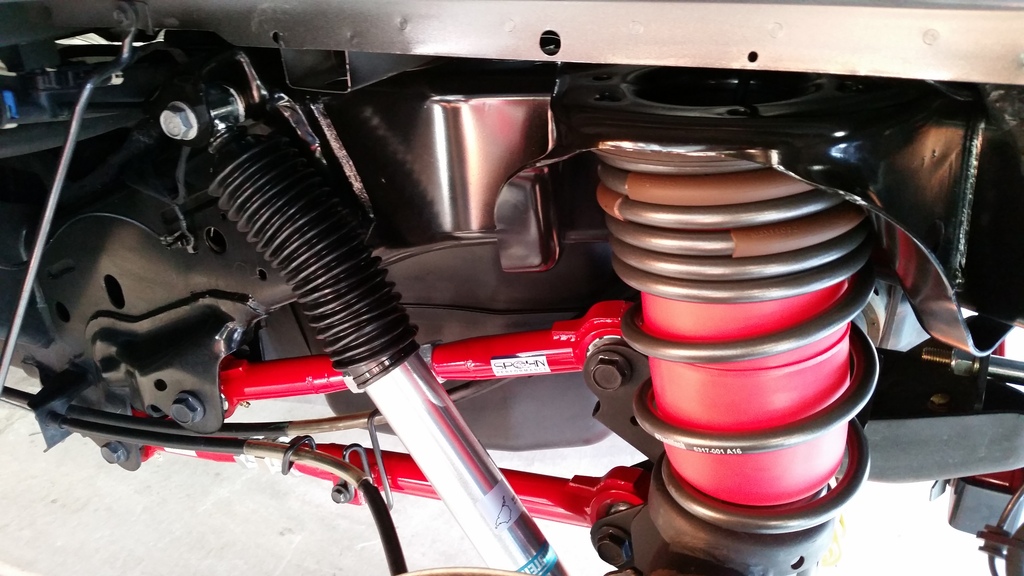

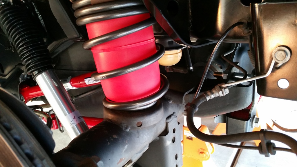

only missing the rear swaybar now:
ran each bag to a separate schrader valve like I did on my burban, cool the factory provided these slick mounting holes!

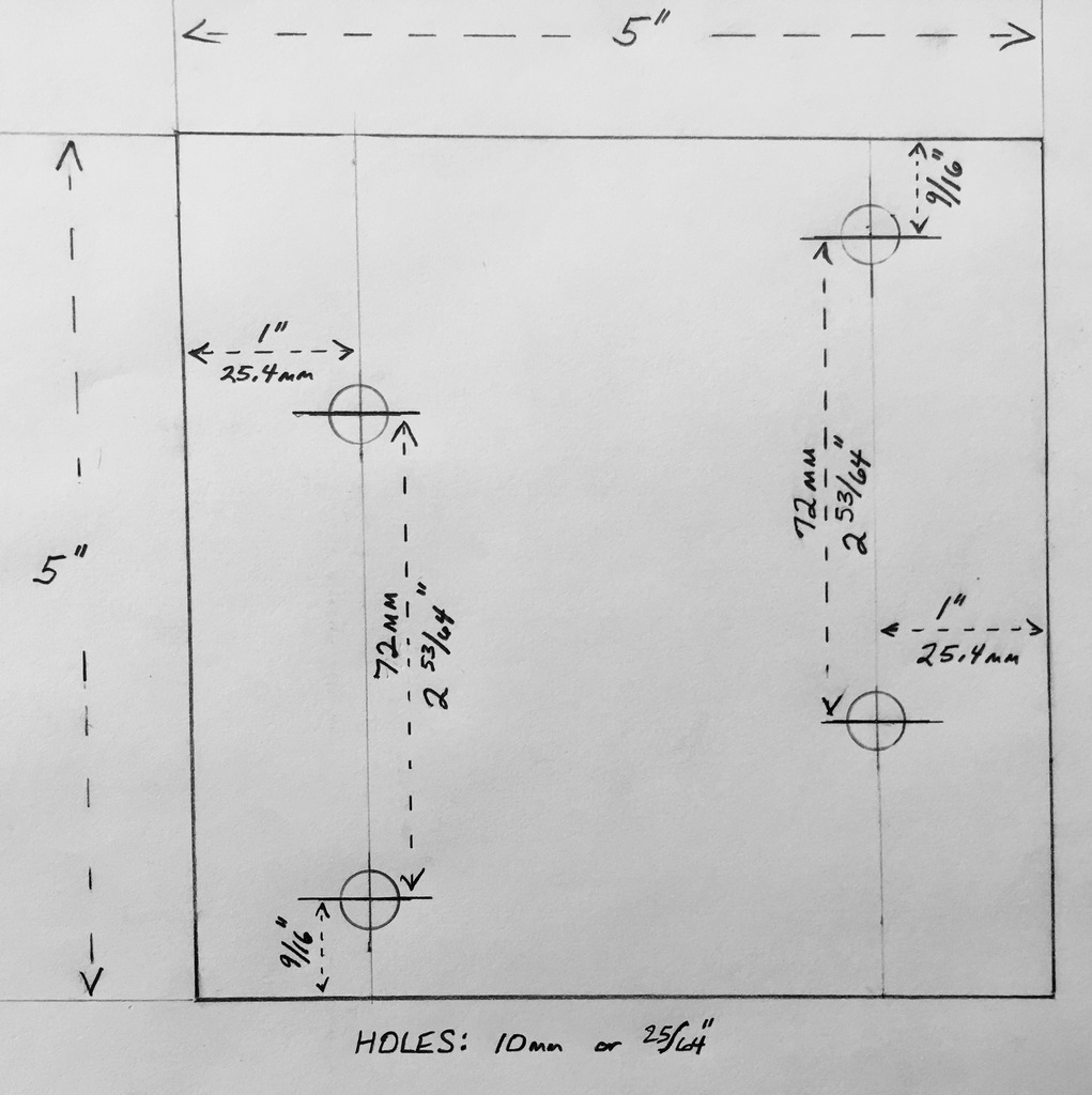

Since I did not purchase one made for the Ram 1500 because I wanted a thicker bar. In order to get it mounted to the axle I have to make some adapter plates, easy enough, as it will be essentially a flat metal plate with four holes drilled into them. I'll be moving the mounting location 3" inboard on each side and 1" down. As a note: this will not be the lowest point on the suspension. Here is what I'll be making as a starting point:
This particular pic is "not to scale" but I have a scanned copy that is. If this works out well and there is a performance benefit, all someone would have to do is buy a 5" x 5" piece of metal in your desired thickness, apply the template, center punch the holes to the metal, and drill them out.
