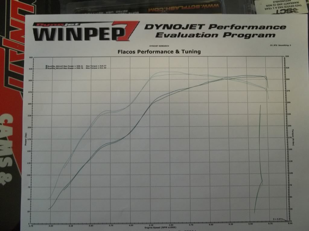

well, after the K&N was added..we strapped back on the dyno to see the results, i am a bit dissapointed to see only a diffrence of 2hp and 5tq at the wheels after a couple of pulls..all the same
the only thing i can think is iat's pulling a bit timing from what it has..
tempeture at shop was 2* higher tha previous..100* vs 98*
i will post dyno sheet in a few

what is the dip from?

rolling in the throttle to prevent from downshifting to 2nd
