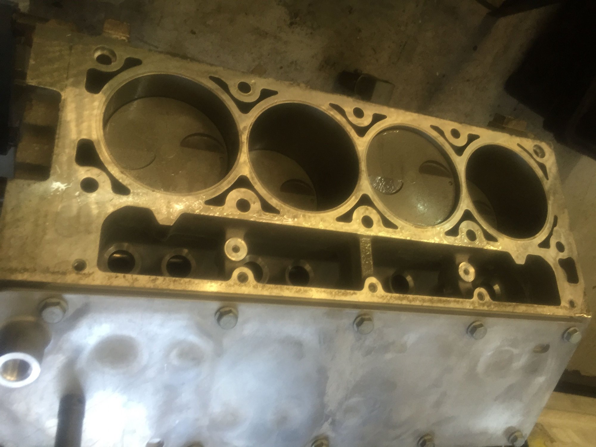

Got pics of engine today.. Also did a little bit of work on it and finally went through the box of parts and separated the old parts into trash and reusable engine parts.... Have two non dod covers, and probably 3 rear covers.... And a cathedral port nnbs intake.... Not to mention the seemingly 2000 engine bolts...
Pistons and valley cover installed....

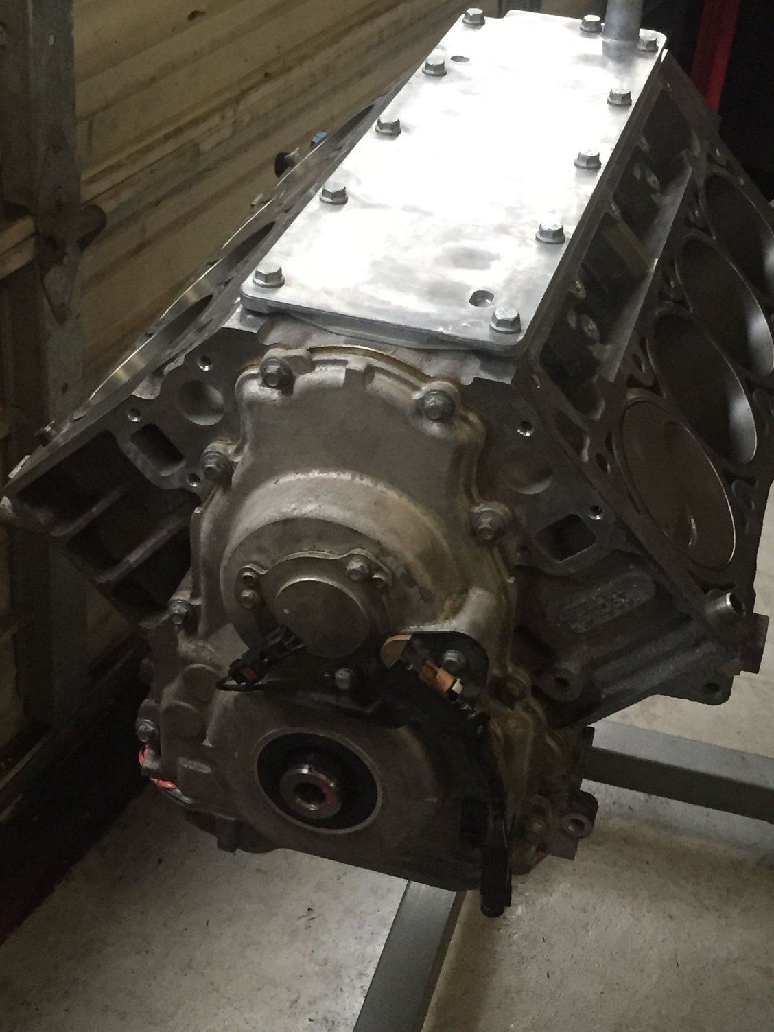

Didnt have much time today so went ahead and installed cam, and retainer plate.. And put a regular non vvt cam reluctor on it just to prevent the cam from mysteriously finding its way out the back of the block, at least until i can find time to oull the engine off the stand and get the rear cover installed
Back of the cam....
And the stamp on the block...

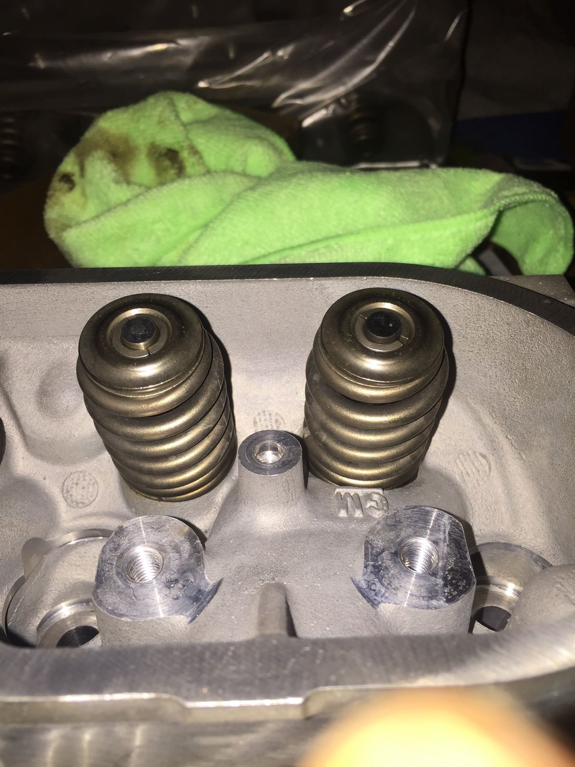

Brought my heads home to swap the springs, and finally get to use my nee trick flow spring compressor....
Stock springs....
This trick flow spring compressor is the shiznit!!!! Dont know how i ever lived without it.... Just wish there was a way to easily just swap one spring.....
Dont even have to remove the base to install the seats and seals....
Did all 8 on the one head in about 30 minutes.... And had a couple brainfarts along the way that slowed me down....
