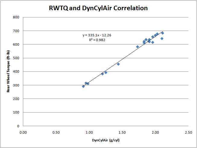

What you could do is make a graph similiar to how I did with dyn cyl air and what you rear wheel torque was from the dyno if you can get it close via rpm and looking at your hpt log.

With that you can make a PID that shows you what your calculated rear wheel horsepower is. The correlation is very linear so it should be pretty accurate.
With that, what you can do is go to the track and and with your trap speed, find another real horsepower value. Ideally they will be very similar, but if they are not, you could make a weight average equation that would put you somewhere in the middle.
