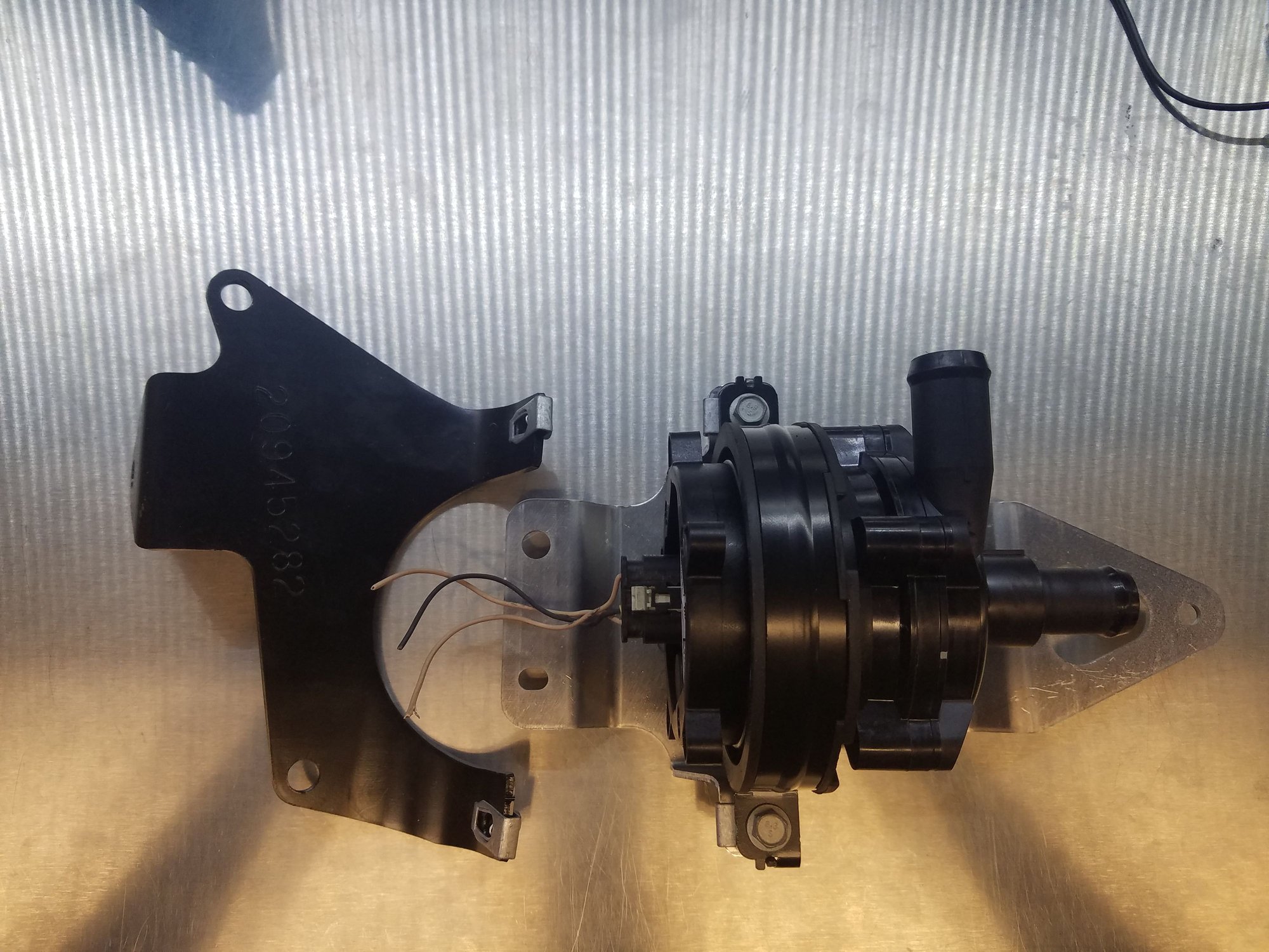

LOL, like this one? This is an upgraded HEX for the lightnings. I have the pigtail for the pump and wiring is just 2 powers and 1 ground... Having access to GM parts catalogs and GM service Information is soooooo great!!!!! Lmao.. Every part of this TVS2300 has been modified before installing. I still need to wire up the twin fans for the HEX....

I would like to see the full specs for this pump, specifically the flow vs pressure curve. If it truly flows between the ZL1 and ZR1 pumps at all pressures it could be a good option over the VariMax at about the same price.

Where are you mounting the pump...i like all these new HEX ideas!

Thanks bud, I don't have any other info on the new Z06 pump. I just know what GM tells me and also that I do know that it does have a different part number on the pump itself than the ZL1. If it was the same pump GM would not change part numbers. It looks the same on the exterior but the inlet does look different when comparing the 2016 ZR1 pump and the 2014 ZL1 pump...

This is the new Z06 pump with the included bracket... I have not looked into mounting it but it doesn't look like it's going to be an issue.

The black mount on the left is the oem mount for the zl1 pump and the aluminum mount on the right is the oem mount for the Z06. I'm planning on using the Z06 mount....

Could that mount to the bottom of your tank? Is it the right size?
