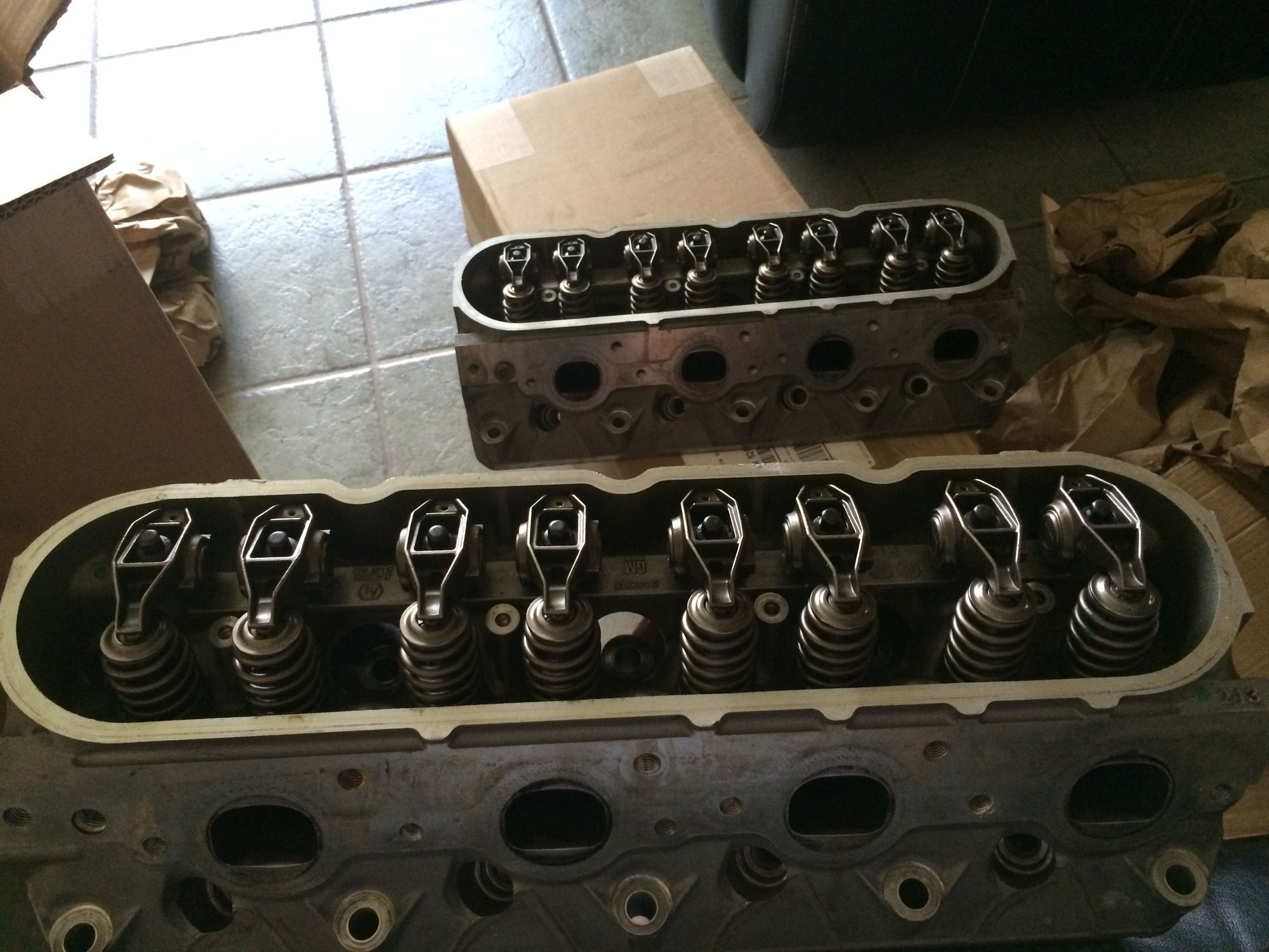

Swapped the 4.8 for a lq4 6.0 got some 243 heads, sent them to advanced inductions for there 232 cc cnc program got a custom ground cam from them
228/232 got a nice all around package from them as far as internal work

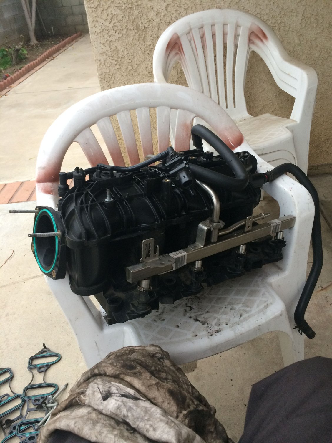

Did the tbss intake swap with 8.1 marine injectors x-link and 90mm throttle body longtube headers no cats x-pipe with dual slp exhaust and side exit tips

Stock 243 heads

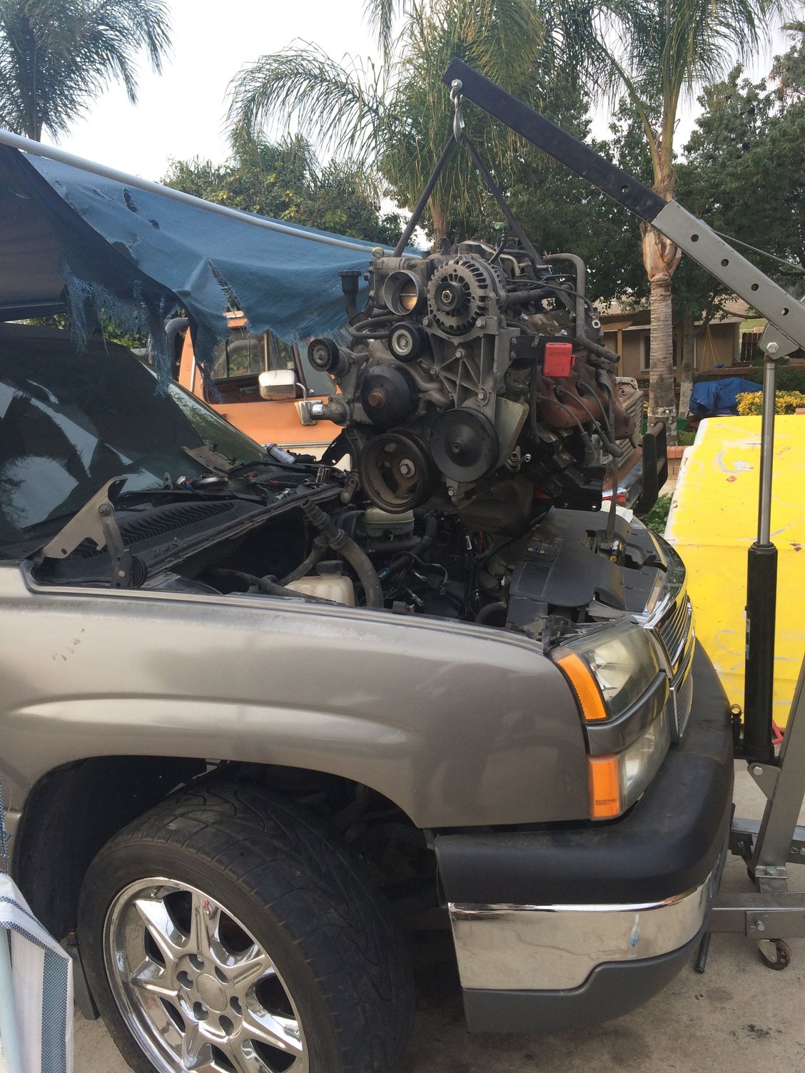

Pulling the 4.8
4.8 out
Tbss intake

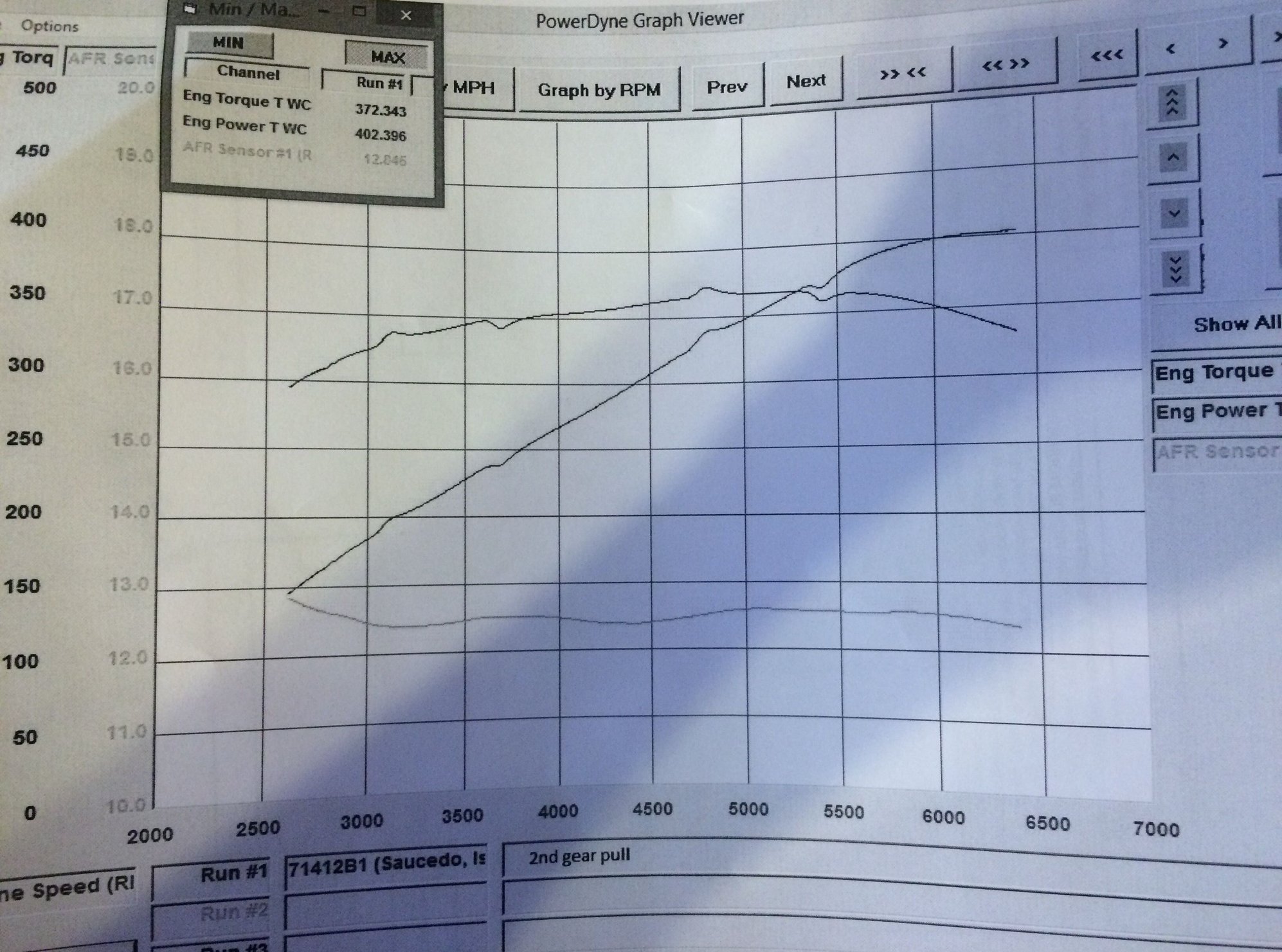

Default Dyno numbers
2nd gear pull <br/>Tuner was cunnigham motorsports <br/>Gonna save some cash and get a custom driveshaft <br/>

Default Nov 20 2015
Dyno pull was on nov 20 2015

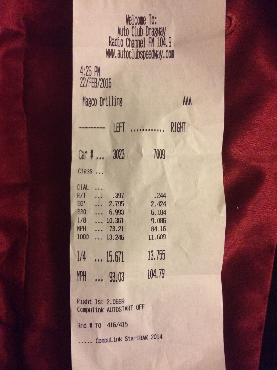

Truck was #7009<br/>What u guys think it was my best pass of the day 4 passes total <br/>Where can I improve

Hey man.
For improving your track time, try to work on your launch. Getting your 60ft down below 2.0sec will get you into the high 12's.
I am assuming the track passes were made with the Mickey Thompson's? Were you spinning? Try various launching styles/techniques and see which ones works best for you. Also, you'll probably need to play with tire pressure to maximize traction.
In terms of et, you're leaving a lot on the table with a 2.4sec 60ft, but its a starting point! Getting that 60ft down will yield significant results

Originally Posted by lycominghunter
Hey man.
Yea thats what the told me 60 ft is where u can make a difference
First run was at idle then the second one i power braked it to like 2k and i spun pretty bad i have a 3200 stall
Thanks for the info on psi who knws where i was at 18-20 is where im putting it this Sunday
