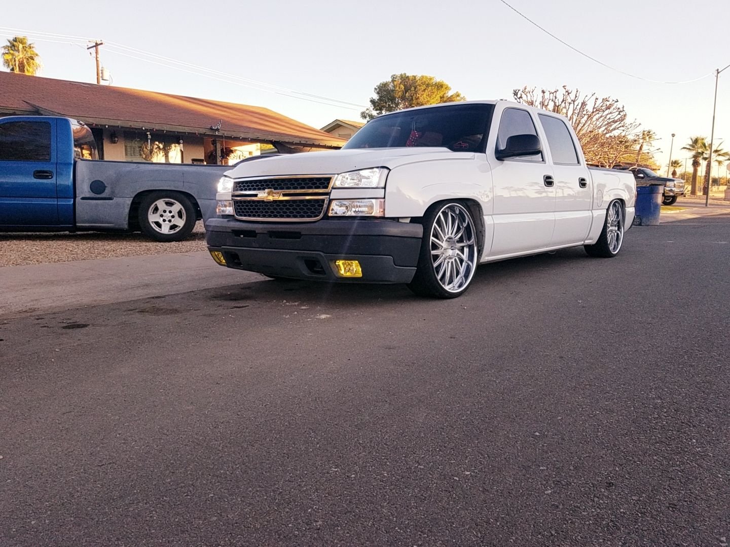

Days after Thanksgiving I worked a deal and was able to end up with this 2007 Silverado Crewcab classic. The truck had a few issues when I picked it up. 2 window regulators didn't work, windshield was cracked, check engine light for the knock sensors, oil pressure gauge was pegged at 80, and a few other smalls pieces were missing. I didn't waste anytime getting the bugs taken care of. Once all was back to stock condition I began my build. Here's a few photos of the current progress! Day 1
Day 1
The fun has begun...

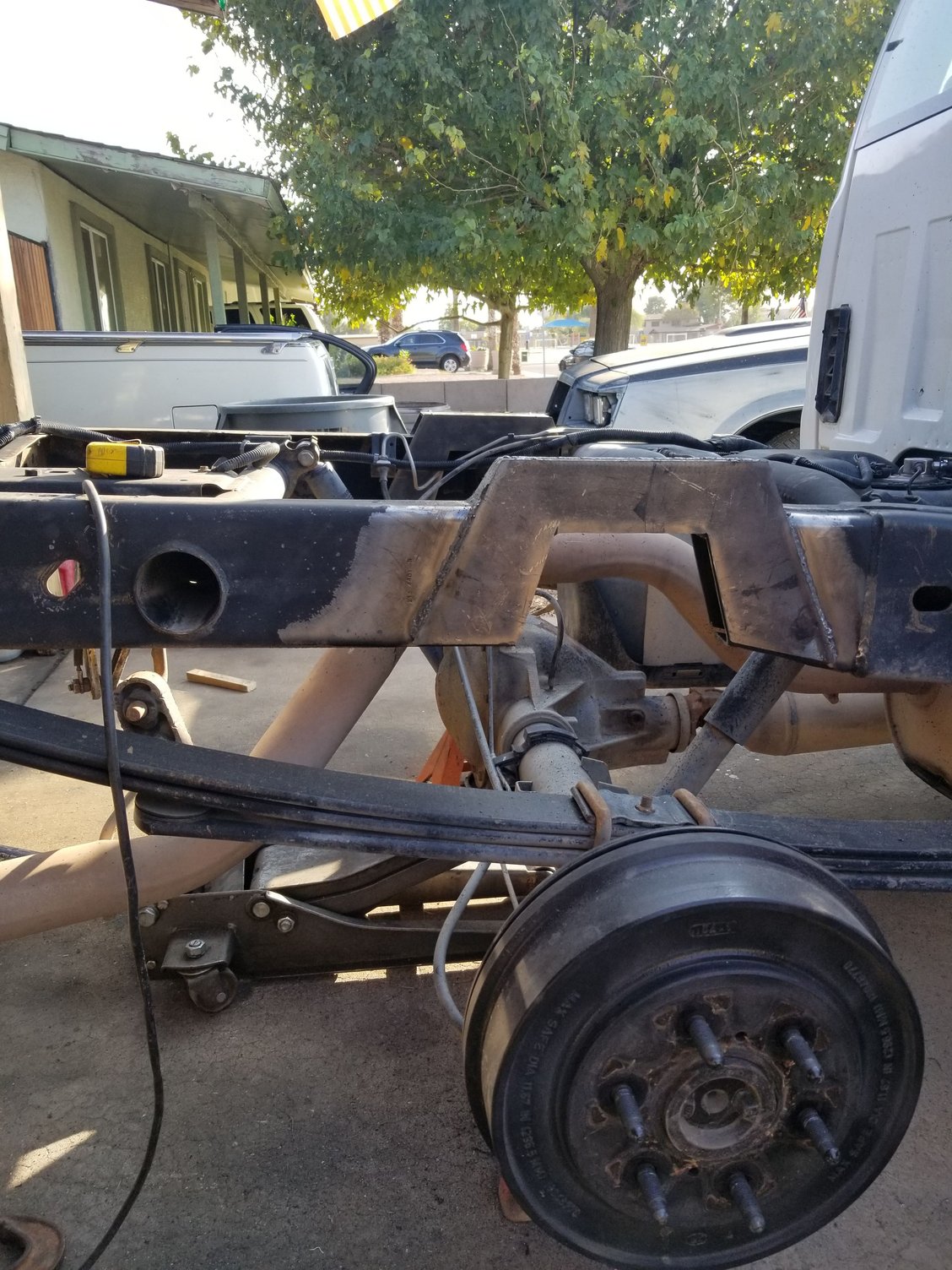

Underbed notches
Djm flip kit and shackles installed

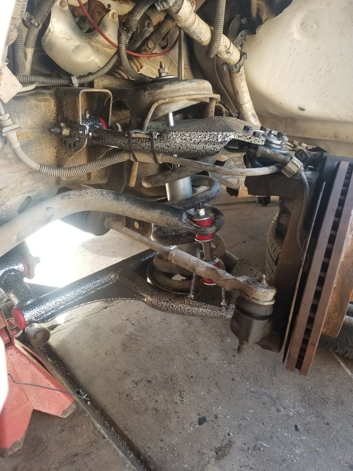

Djm upper and lower control arms 4 inch with mcgaughys drop shocks
4/8 drop rubbing on stocks lol limo tinted as well
Pulled these 3 piece DUB.ONE 24s outta storage
Xmas gift some new LED headlights, switchback turn signals, and fog lights
Picked up this donor 2003 Yukon Denali XL for a motor and interior swap. Then parted the rest out and actually made some money on top of all my new goodies
6 litre 132xxx miles

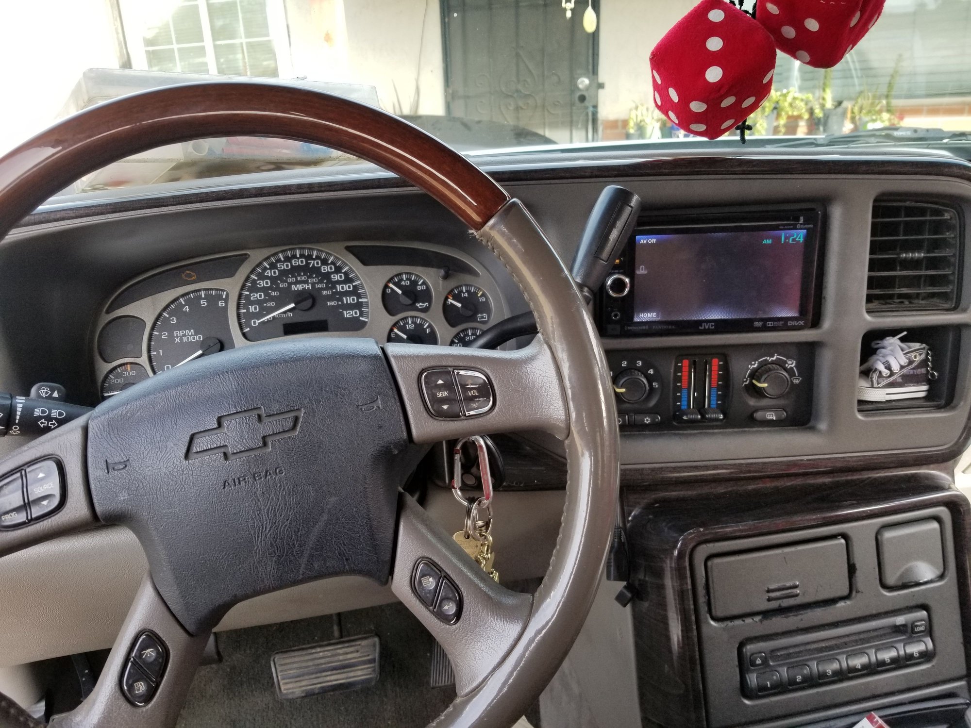

Interior installed in the truck. I used the Denali door panels, window switches, dash board, stereo bezel, gauge cluster, center console, leather seats, power folding mirrors with turn signals, and all the interior plastics. Even the double din stereo was pulled from the donor.(Thats an Escalade steering wheel with original chevy airbag)
Installed the HD upper pad on the bumper
Cleaning up and all new gaskets for the 6 point Oh
As of today the truck is in the shop getting the front bumper, rear bumper, mirror caps and door handles color matched. I'l keep up the progress on the build and post as i go. The motor will be going in as soon as the trucks home. Stock manifolds and 4l60e until the pocket book gets back in shape. Any input on the 4.8 to 6.0 swap would be greatly appreciated. Let me know what you think of the truck!
