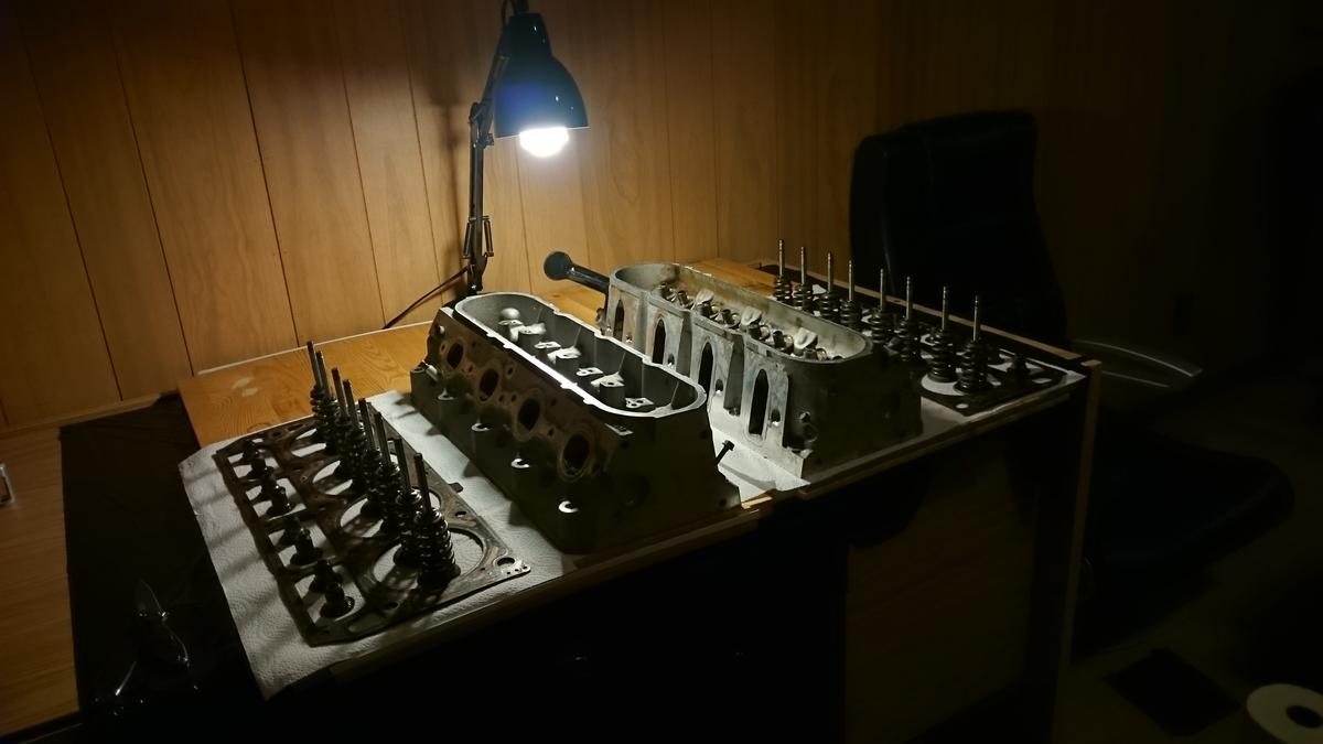

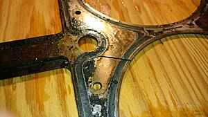

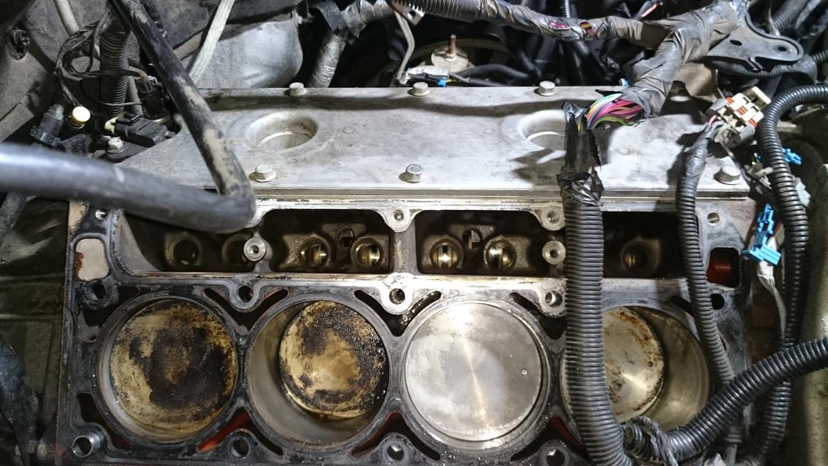

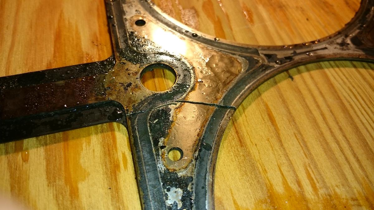

Okay, so I've been plugging away at this project trying to make some headway and so far so good. I've found the source of my issue. The head gasket was cracked between a coolant passage and cylinder 4. The piston was spotless, the combustion chamber was clean, and the plug was wet. Every other cylinder looked normal (for almost 200'000km).

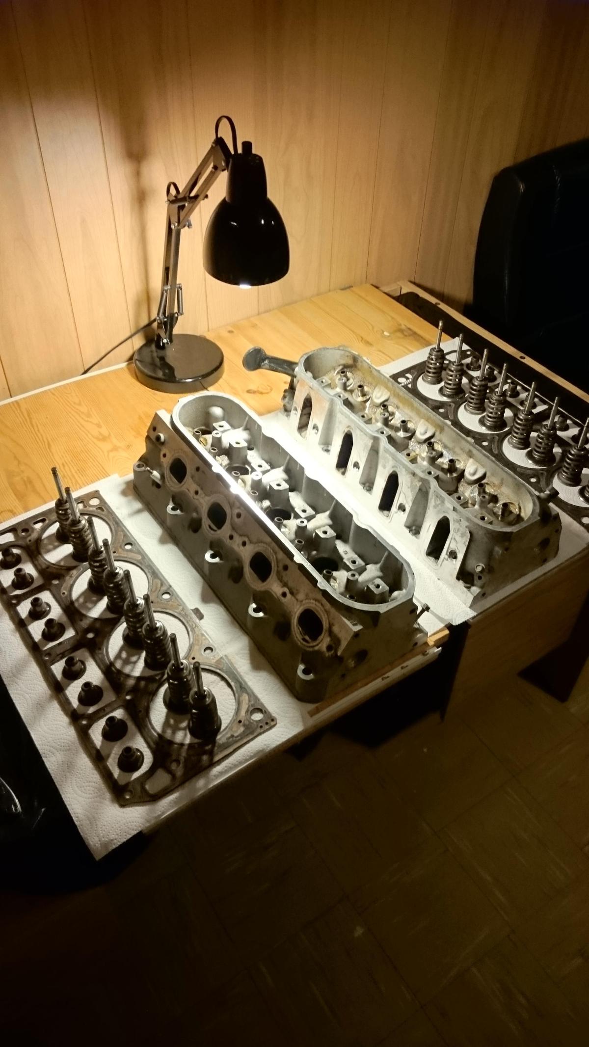

I took the heads to the car wash along with the intake, and gave them a good cleaning with degreaser an hot water. I took the heads down to the basement and started disassembling them so they can be dropped off to be resurfaced and inspected.

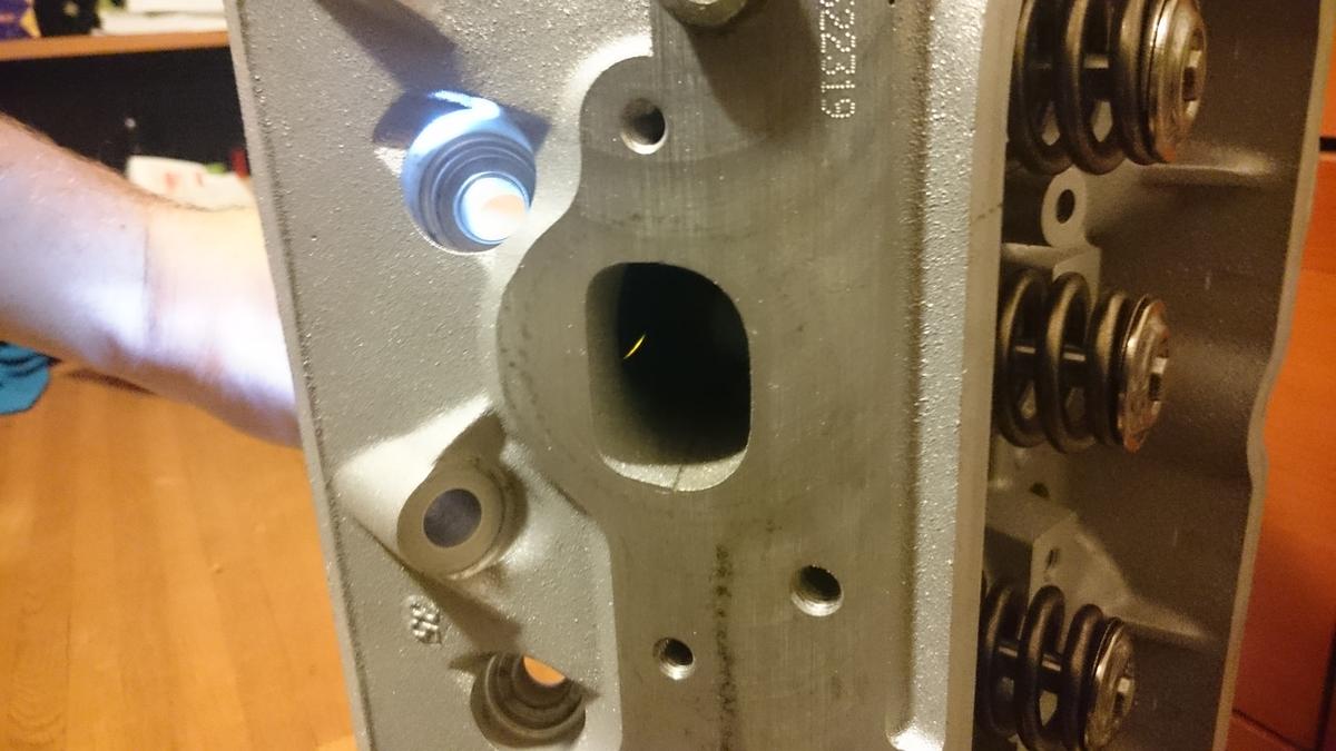

- I don't have time to argue, so I just pay the lady and get the heads home. Then it bugs me what 1994Vmax said about crooked valve seats so I grab my flashlight and take a peak.
Yeah. At least 6 exhaust seats are cut so crooked I can see light through them. I gave them all a tap with the mallet to make sure it wasn't debris or something. Nope, just poor quality work.
I'm going in tomorrow morning to demand a refund so I can take them to a shop that can fix their screw up. Or just order remans. If they offer to fix them I won't take it. I'll do an update when I actually get some usable heads.

I took them back today and showed the machinist what was going on. He acknowledged his mistake and used a different machine to regrind the seats. He had them ready to go by the end of the day so I'm not too upset, I'm more focused on getting this thing back on the road.
