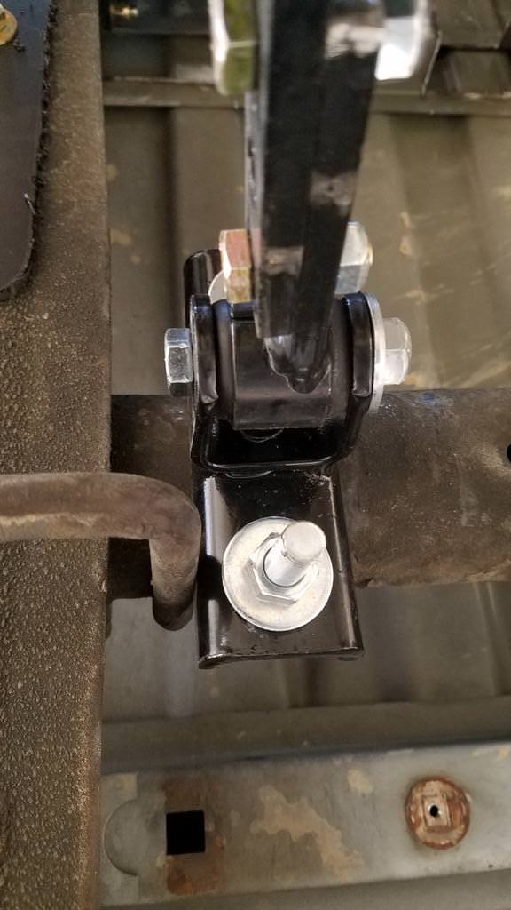

My truck was 1"+ lower in the rear from left to right. I got under the truck and this is what I was looking at. Sway bar end hitting the exhaust hangar.
I cut it off and re-tightened the bar. You can see how far it moved outwards on its own from the original position

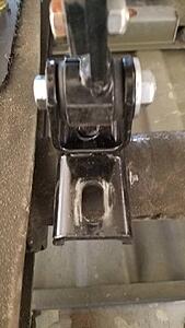

Also, the other side need to be repositioned

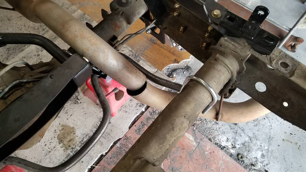

At first, I cut just the end of the exhaust off, but then it lifted and sat against the suspension brackets, so we just cut it off back to the muffler
we cut the exhaust back to about the green line, right to the other hangar

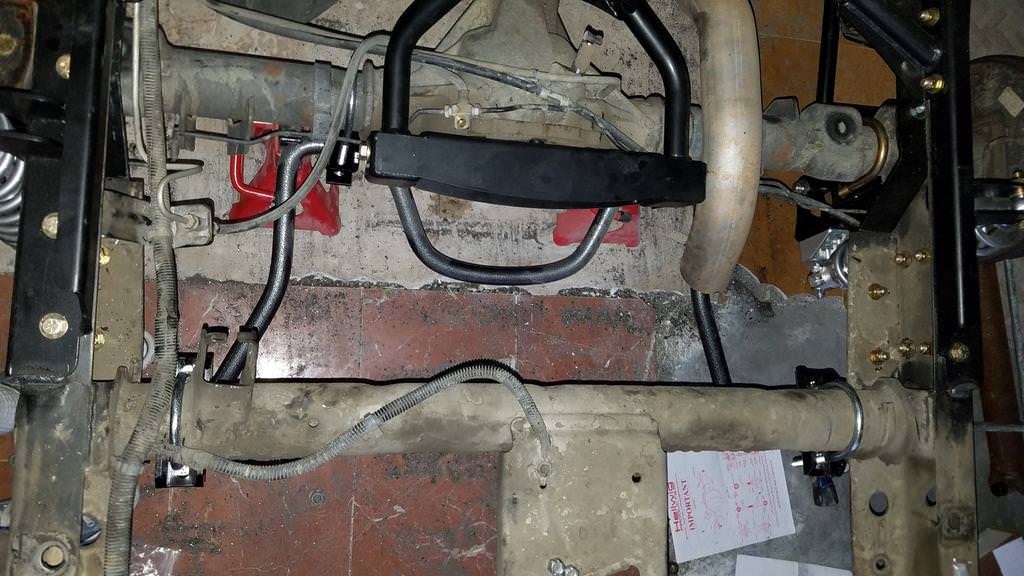

This is what the bar looks like from above, crazy swoopy shape
