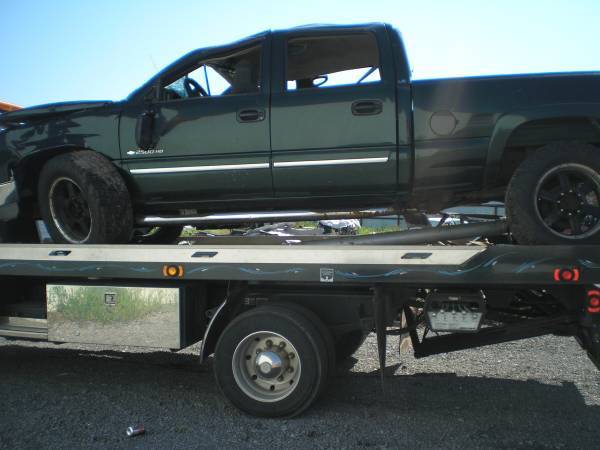

Found this truck 10 minutes from my house. They guy is parting it out. Here's what I'm thinking I'll take off of it.
Engine/trans with all the wiring and ECM
Front drive shaft
Hydro boost
Transmission lines
Will I benifit from taking the wiring and ECM? Is there anything else off the truck I may need? This truck is a push button 4wd and mine has the floor shifter. I'm not swapping the transfer case so I didn't think that part would matter.

Old Jul 17, 2015 | 07:47 PM
lxcoupe's Avatar
Joined: Nov 2004
Posts: 1,127
Likes: 22
From: California
I can't see how the wiring or ecm would be needed, if you can get it for free then you can sell it. The only wiring you'll need for the 80e is a vss connector and 2 wires with ecm terminals at the end.
Old Jul 17, 2015 | 08:16 PM
kyle's v's Avatar
Joined: Apr 2011
Posts: 285
From: Arkansas
Can I not use all the wiring and ECM from the donor truck and be a plug and play type deal? Maybe I'm thinking wrong..
Old Jul 17, 2015 | 08:56 PM
signguy62's Avatar
Joined: Jun 2014
Posts: 103
From: NJ
You could but why? Your current harness and ECM will do.
Old Jul 17, 2015 | 09:07 PM
lxcoupe's Avatar
Joined: Nov 2004
Posts: 1,127
Likes: 22
From: California
Possibly, but totally unecessary. That LQ4 is 24x as is your Z71 so every single sensor/ connector will be plug and play.
Plus if you use the 2500 ECM you'll have to have the VIN rewritten, all in all an unncessary hassle.
Old Jul 17, 2015 | 09:20 PM
kyle's v's Avatar
Joined: Apr 2011
Posts: 285
From: Arkansas
I figured the engine sensors we're all the same. I knew the big difference was the transmission. So it would still be easier just to make my transmission harness work?

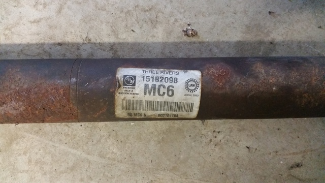

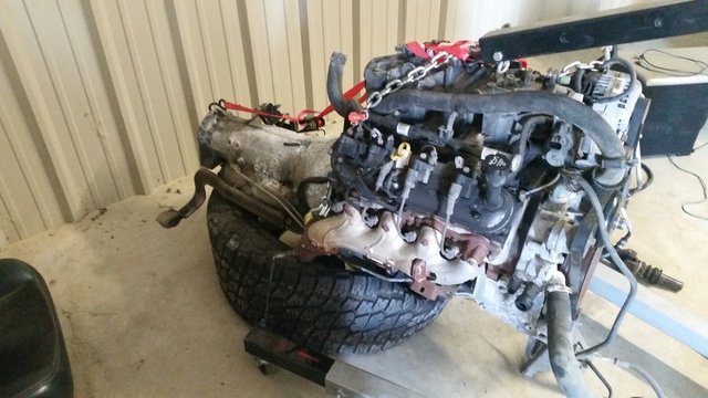

Picked up the engine/transmission on Monday. I also got the front drive shaft and gauges.
I'm assuming this drive shaft will work? Here's the part number on it.
