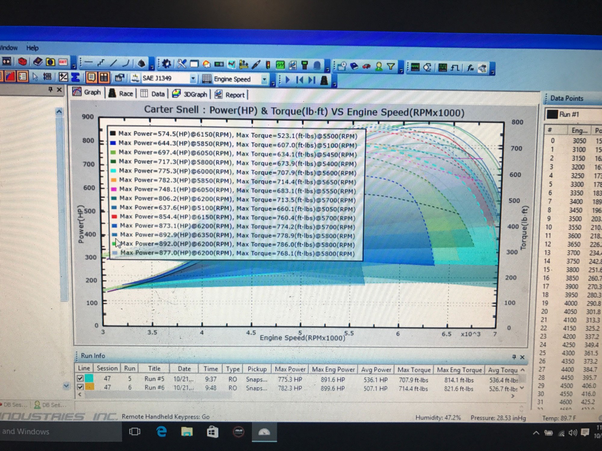

Default Dyno done!
Well finished up tuning the truck on the dyno this morning, went very wel!! 18.5lbs made 892rwhp 786tq, gonna need c02 to up the boost anymore! Not bad for little 5.3 and 76mm
