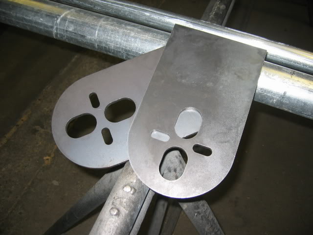

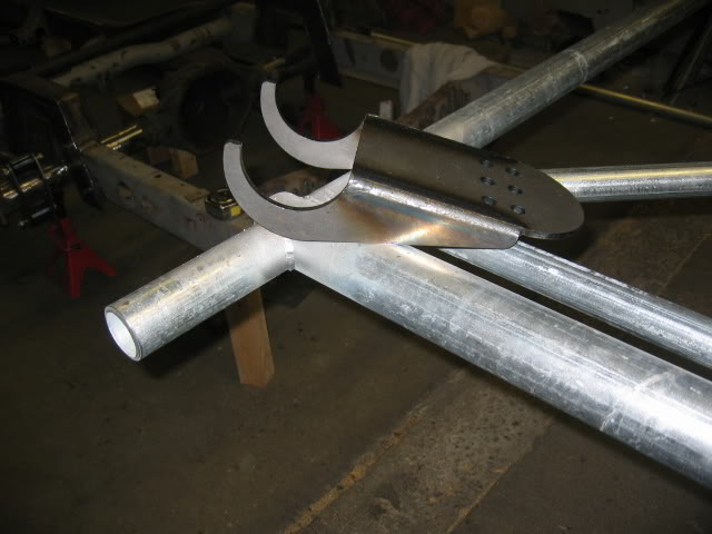

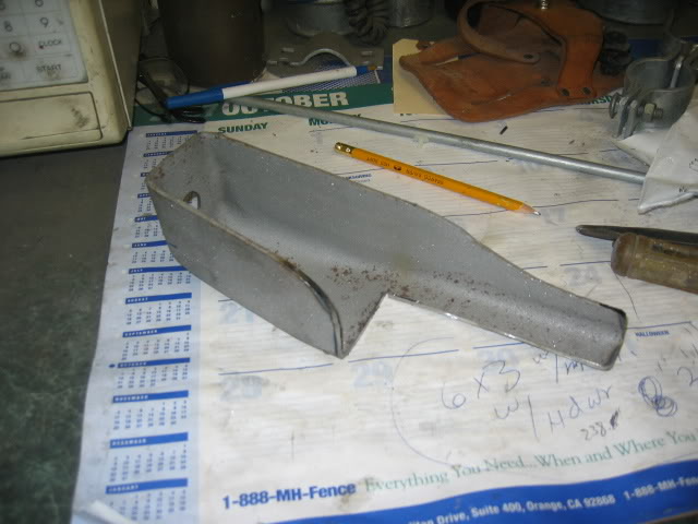

Got my new brackets from SD.com, awesome services :thumbsup:
Ahh much better

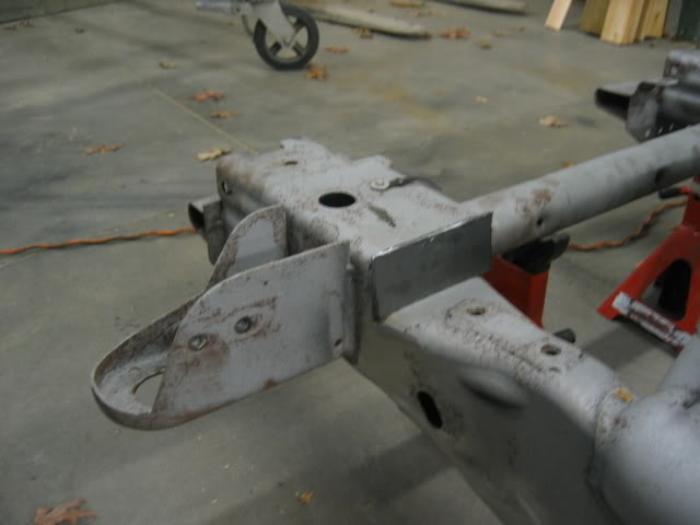

Front Torsion Plates

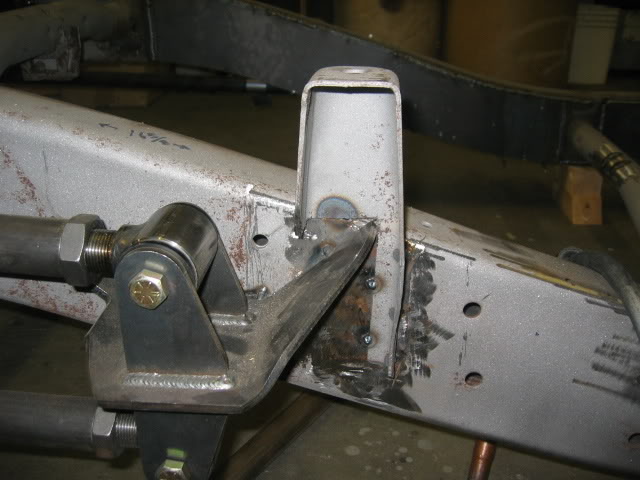

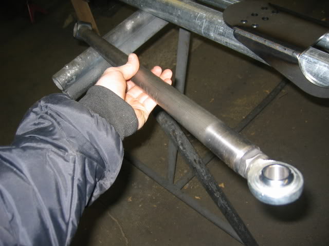

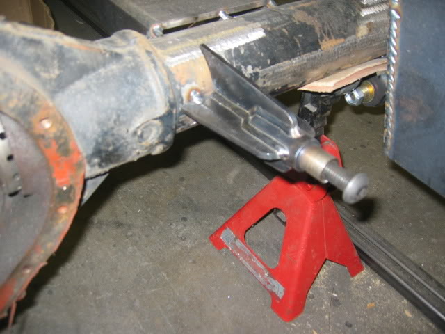

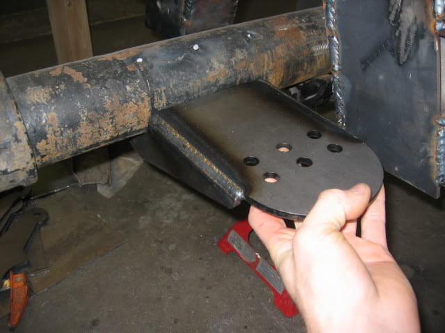

Although awesome service they did send a 2" too long panhard no biggie
I just cut the tabs down, and thread it all the way in. Worst come to worst I order a shorter one.

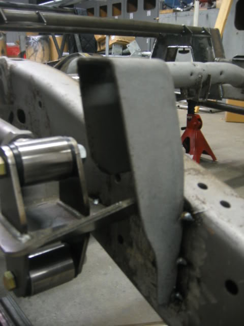

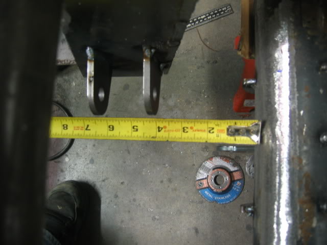

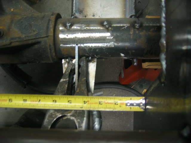

:wtf: I need 19.25" for the shock at ride height and 22.25" full extended since 4.5" up is ride up, that leaves 3" to max out the bag, how the hell can I fit it? Im thinking the shock will be a little high and Ill body drop the bed accordingly.

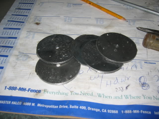

Cut some plates to fill the hole from the stock round crossmembers

rear shocks . . . have you thought about mounting them at an angle like the older Dodges are? . . . longer travel

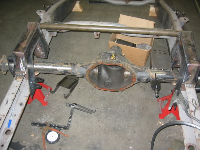

Kind of pissed about this, but the rearend's welds didnt come out as good as I hoped. I think my heat was a little low.

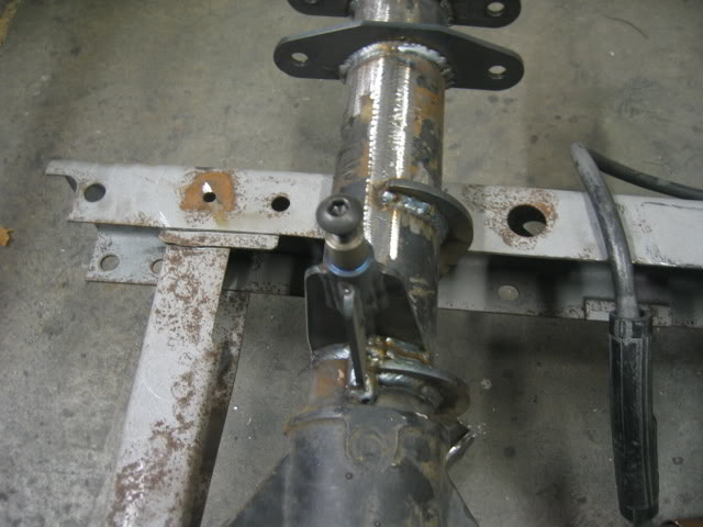

Cluster **** here, since the mounts were soooo close

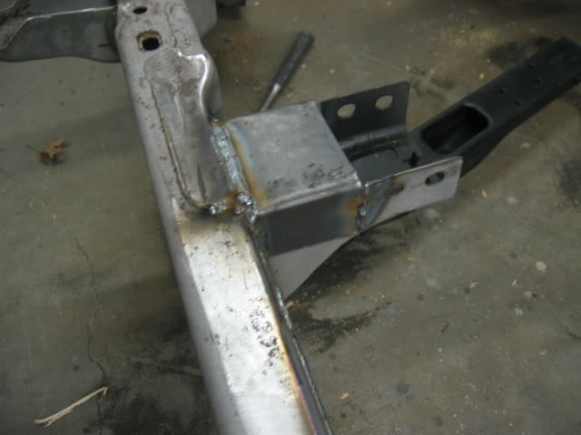

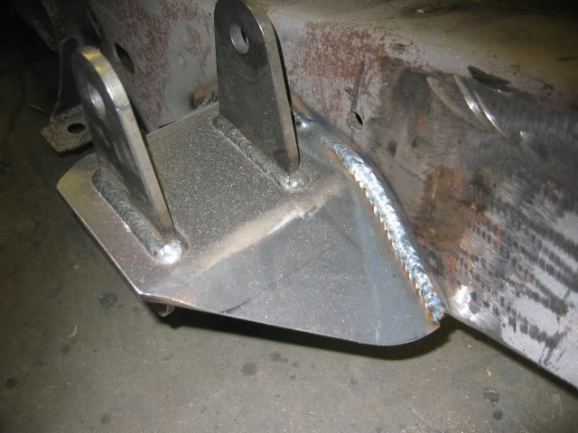

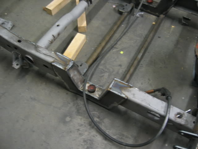

Cut a plate for the underside of the front body drop

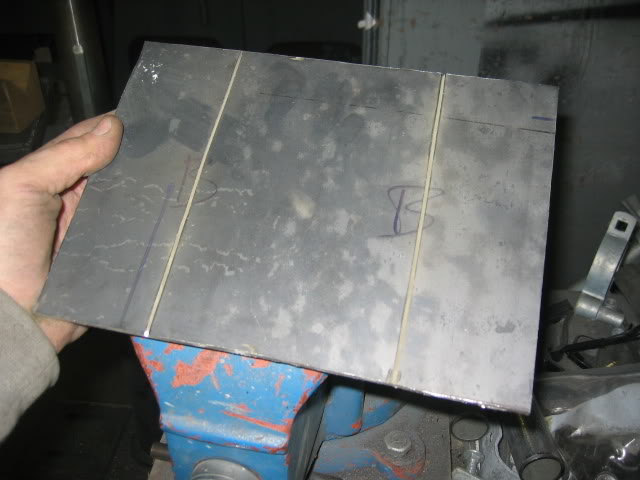

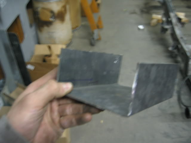

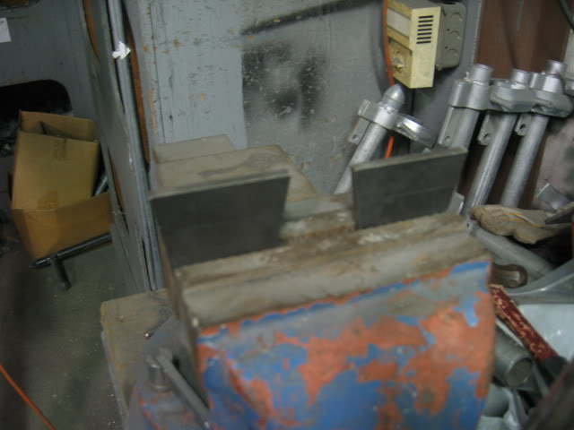

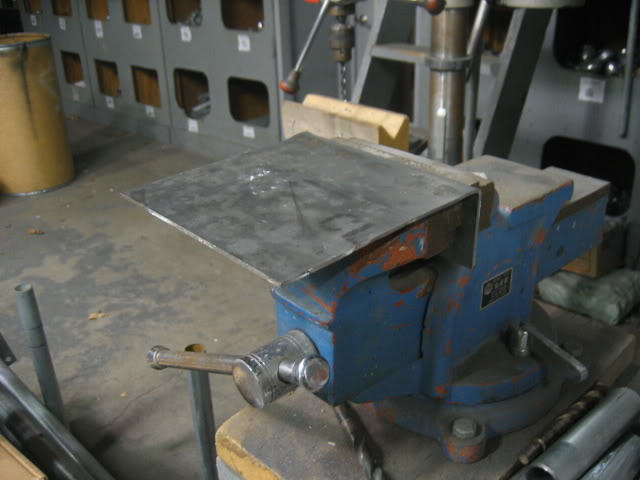

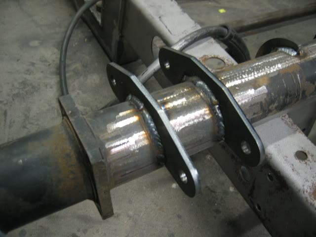

Needed to make some plates for the transmission crossmember, used a grinder on each bend since its 1/8" and I dont have a break to bend it. Made a slit

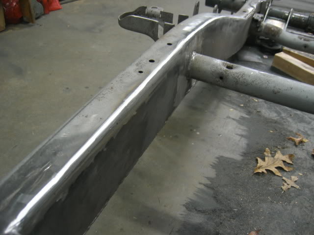

Then spent a while welding grinding, welding again grinding again to get the boxing finished up. Its getting there.
i cant due to the way the mounts for the panhard are
