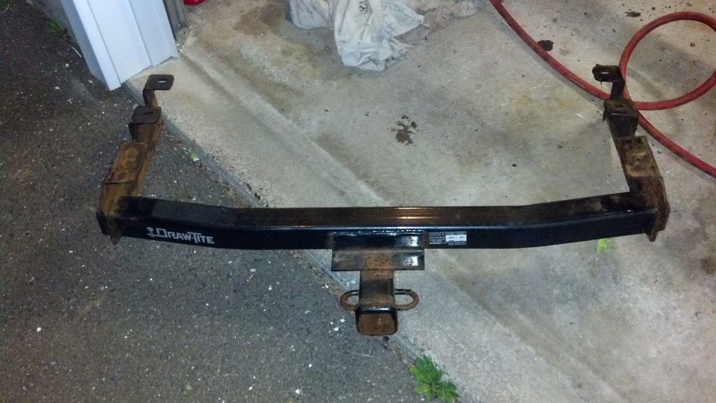

Some of the cross members of the frame look a bit iffy, so the trailer hitch will hopefully keep everything together rock solid.

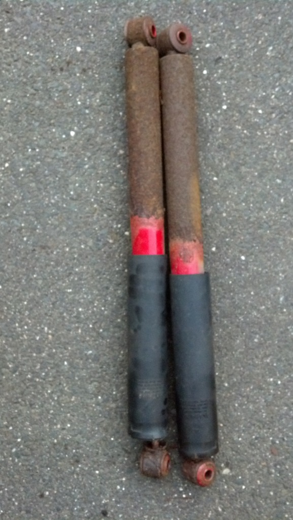

Tonight we took on the task of removing the shocks when we realized that the shock tower mounts are paper thin, and kind of scary...
We searched but could not find these parts (probably because they are welded to the frame) so we are devising a way to strengthen them by welding other reinforcements on. Suggestions appreciated. The shocks need replacing, not because of their function, but the rust has worn them down.
We plan on cheaply replacing them, because when I salvage enough money to purchase my rough country lift kit, it will come with some nice shocks, but that could be a year from now. We also removed the fuel pump ground from where the spare holder thingy was. What a B@#ch!!! man! Long story short I ended up snapping the bolt and we had to heat up the nut with a blow torch, and use vice grips to get it out. That's all for now, but tomorrow my dad is borrowing a sand blaster from a friend at work. With it I hope to get into all of the nooks and crannies that I can not reach with a hammer and a chisel. I will post how that goes tomorrow! C Ya!

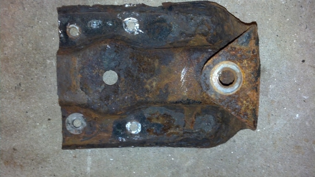

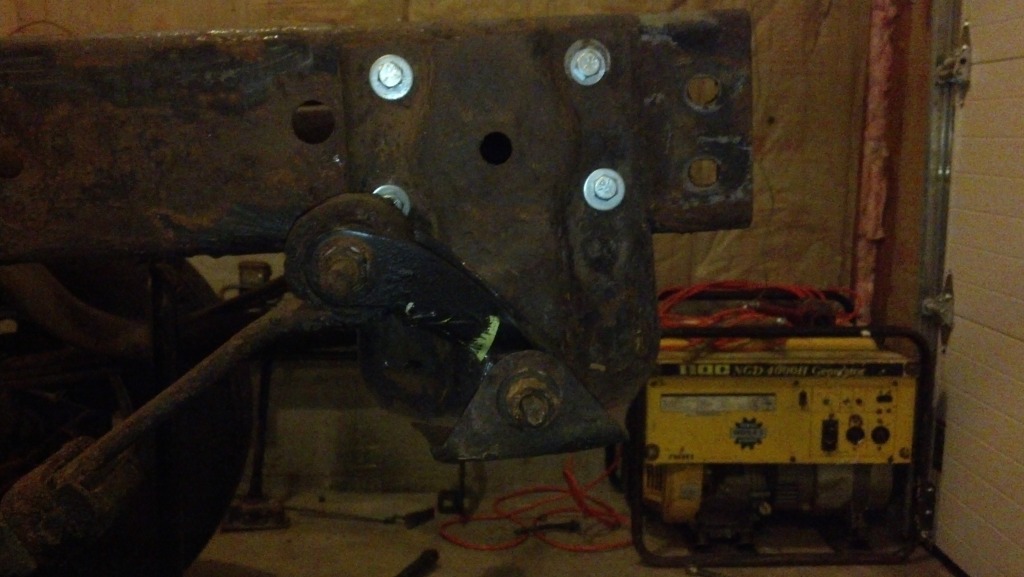

Back, tonight we took off the leaf spring brackets!
This one is not so bad, but the other one is messed up on the bottom. What we decided to do was cut off the rivets and replace them with some bolts that we can take off easily when we get the new brackets. It was easier to lose the rivets now then when the bed is back on.

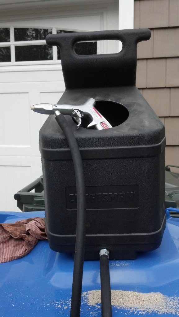

That's really all that we had time for today, we messed around with that sand blaster that my dad got from his friend, and it kept getting clogged. So we bought a cheap one from Sears for $60 not expecting much, but it didn't work for S#!T Not sure why could have been our compressor not being strong enough, only a 2 horse... Also could have been us using play sand... we are going to try and buy some finer sand specifically for sand blasting tomorrow. That's all for now hopefully I can get to the POR15 by next week!! Anxious to drive again!
Well I'm excited, I got the sand blaster working after reading numerous posts that people were complaining about the same problem that I had. Turns out I had to move out the ceramic tip because if it is pushed too far in, then it clogs the nozzle.
Ya might be able to see from that pic. I was also able to use the play sand as well; this is also good because the play sand is only $2.50 a 50 lb bag or something like that, whereas the media sand is $22 a 100 lb bag. Hopefully if all goes well today, and we get most of the frame done. Looks like it will rain though...

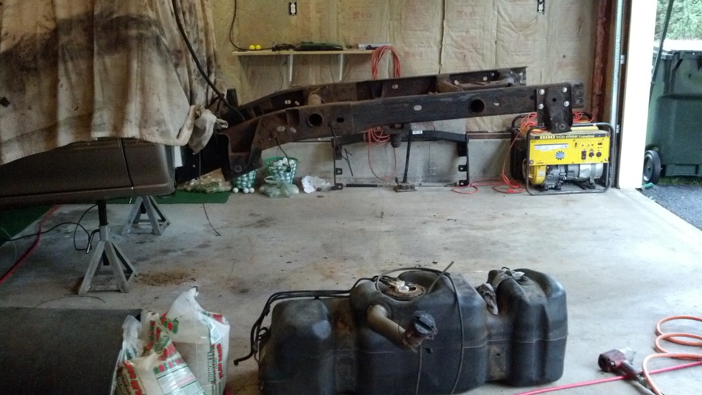

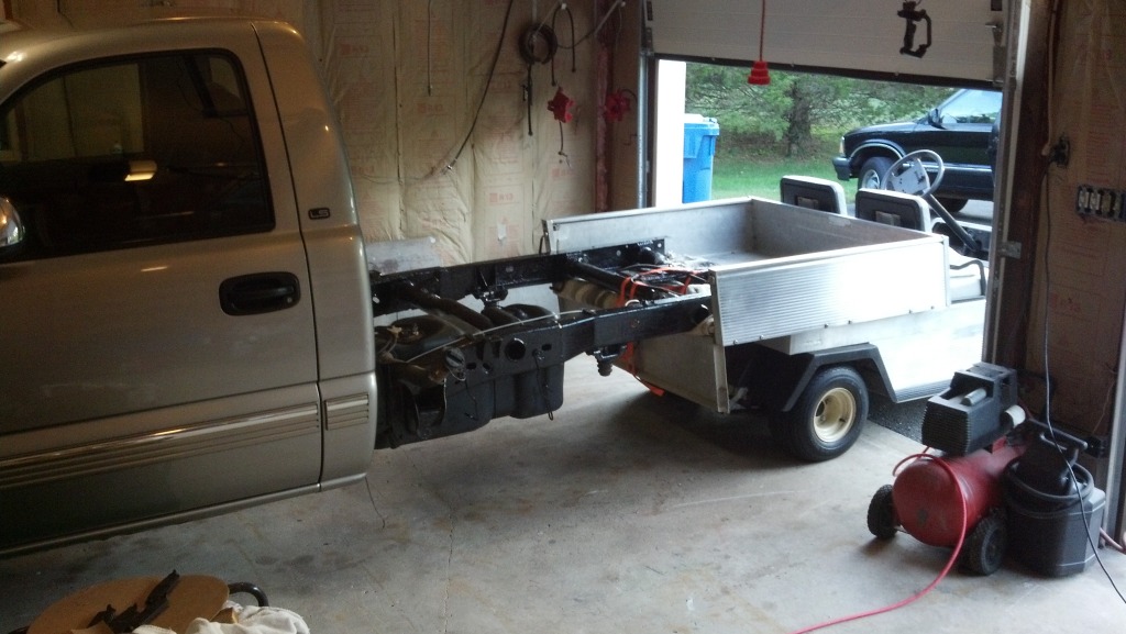

Good God did it rain! I was able to get most of the blasting done that I wanted to though. We ended up stripping the rest of the rear end apart.
The truck looks naked! In the process of removing the tank that you see there we ruptured the rusted fuel lines, so its going to be a while before this truck goes anywhere. Which is disappointing because that is a $200 job. Anyway, I blasted the drive shaft as well as the rear axle and leaf springs. It really looks great, cant wait to get some paint on them. By the way these are pictures before I hit them with the sandblaster.

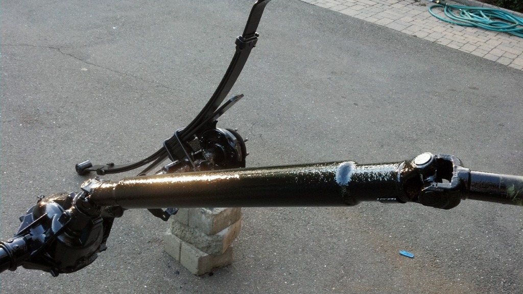

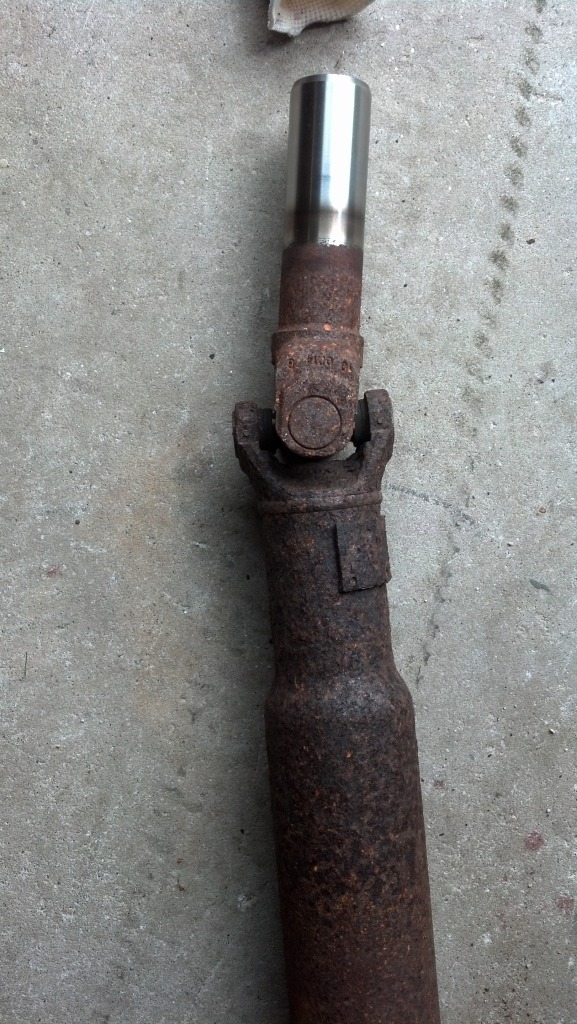

Will only do a light coat on the drive shaft as not to throw it out of balance, cant be any worse than the way it is now with all the rust on it lol.

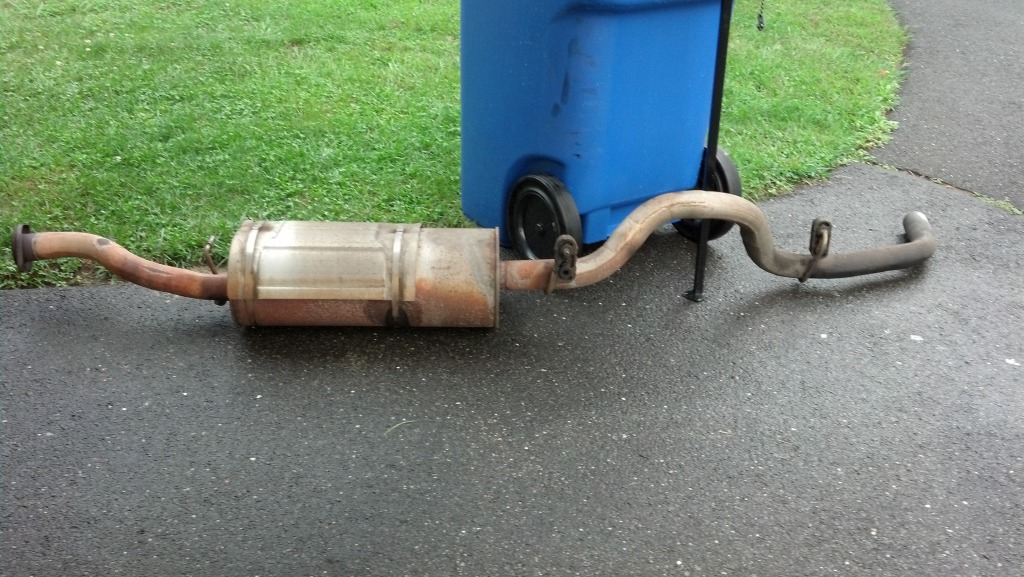

Exhaust system came out too, not after also snapping the bolts off of it!

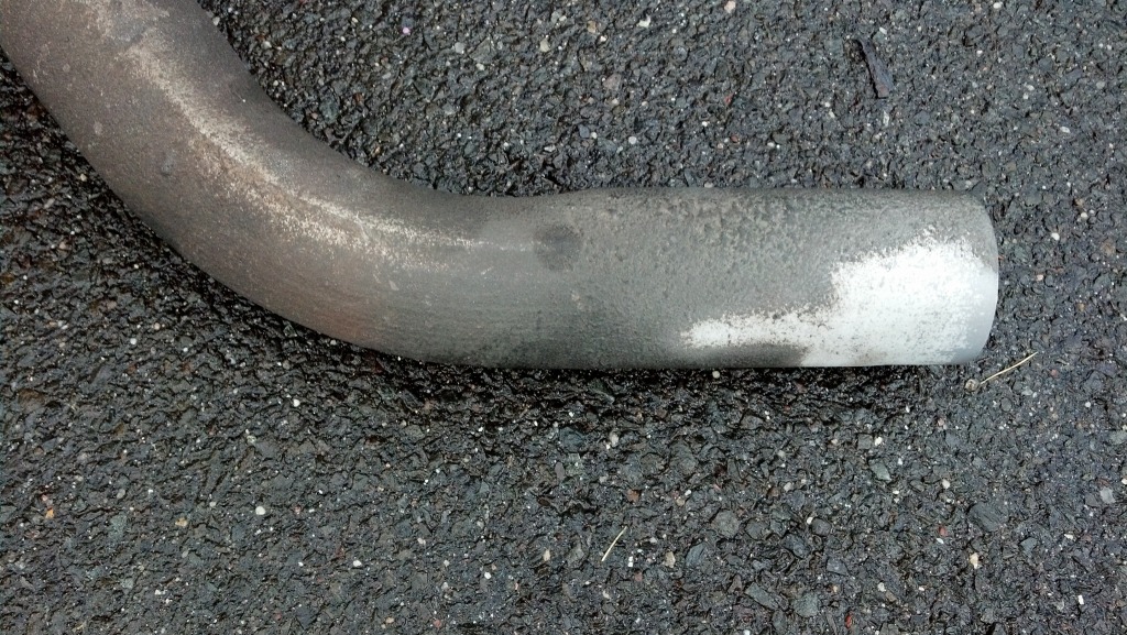

Started to sandblast, that was coming out good, probably going to prime and paint a gloss black or something until I am able to put an exhaust system in it.

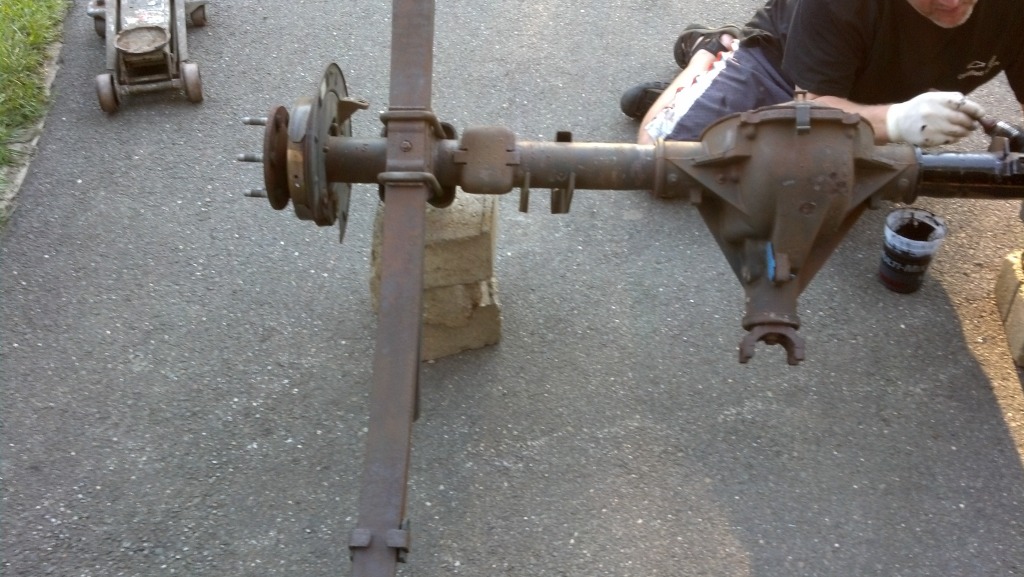

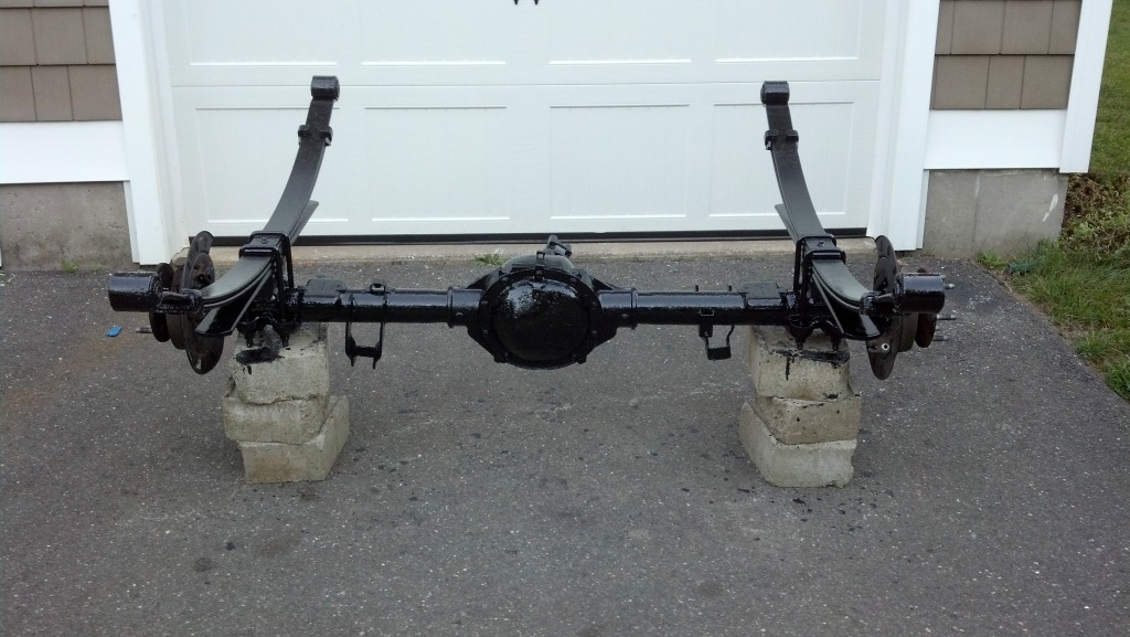

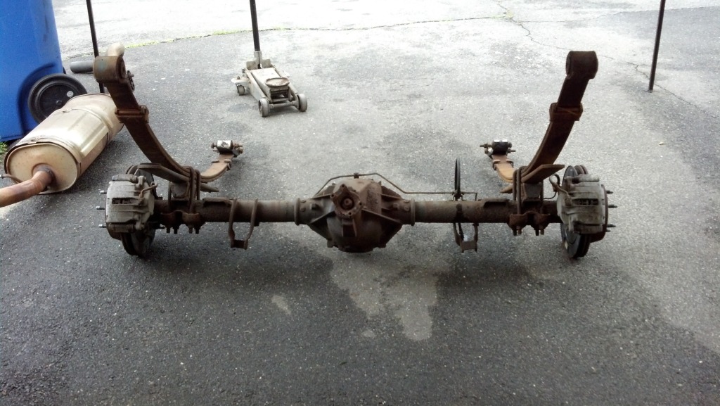

Well homework has been kicking my a$$ lol but I have a few things for ya. This is the removed rear axle and leaf springs before and after POR15.
I mean really it looked pretty crappy, but what about now????
Looks like literally new! This is after it dried too. Not so sure about the gloss, but its tough as nails so far.

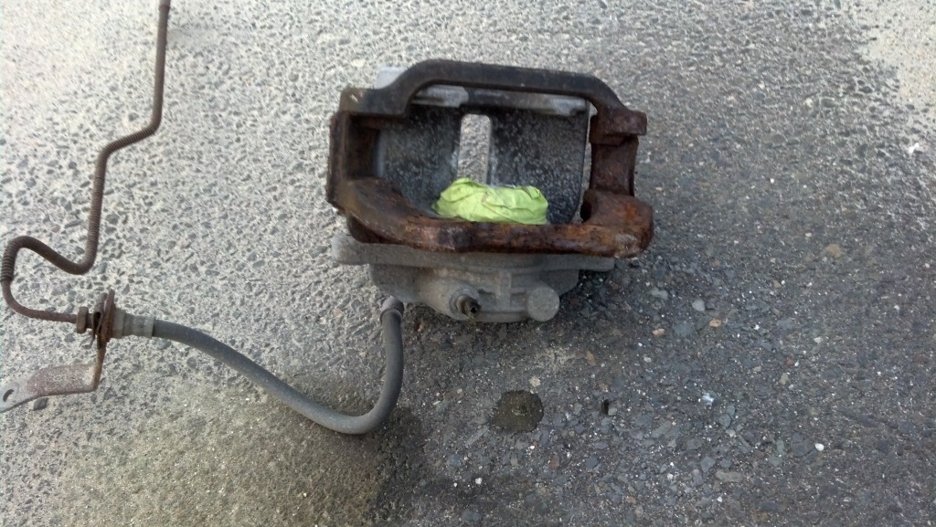

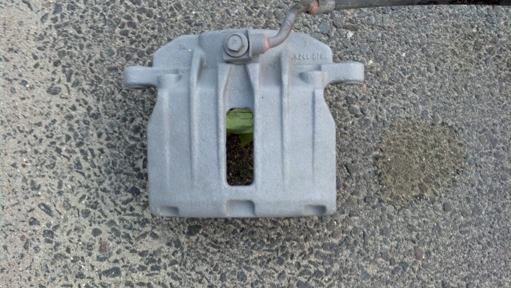

That's one with the drive shaft on it as well. I was blasting the calipers tonight when it crapped out!! Pissed, we will return it tomorrow. But I got some done, it went from this...
To this.
Sick right!! It really does a good job, when it's working well. Going to get them finished, and paint the brackets black, and the calipers are getting some gloss red. That's all for now.

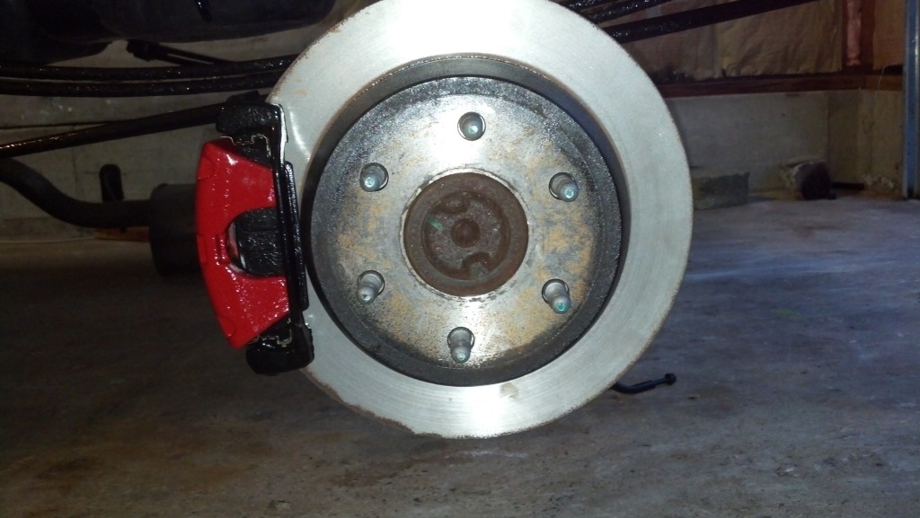

Well it's been a while since posting, that's because I've been busy with the truck, and school. While that picture is still fresh in your mind I will show you the finished caliper and bracket.
