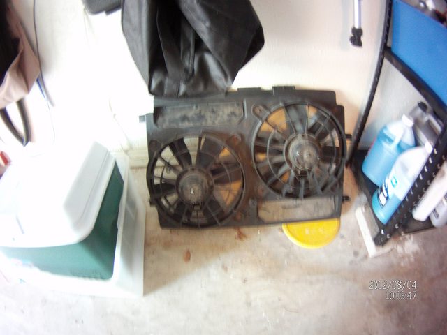

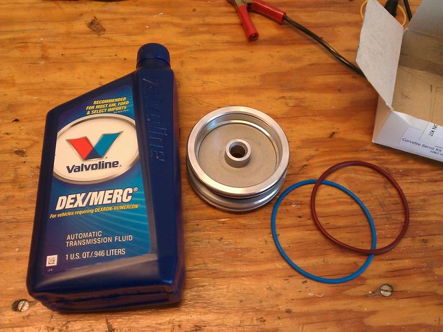

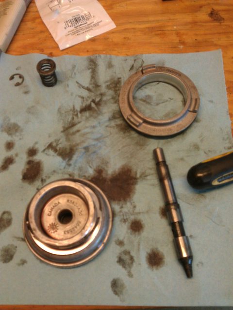

Got a few more things done today. Corvette Servo is in, Aux input is in. Diff fluid looks ok, so I didnt change it. Also ordered some LS1 fans on ebay. Got a really good deal. Thinking of making my own harness though and having it hardwired as opposed to computer triggered because paying $100 for a harness + $35 to have it tuned seems a bit stupid for some electric fans.....
Still need to do a brake flush, and a few other things but its moving right along. I will report back on the Corvette servo to see if its worth it. Still looking for a nice catback.....

1. I <3 the corvette servo. Makes the truck drive much better in my opinion.

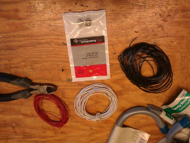

Could you please give us a little more info on how you did the aux mod ?
Old Jul 29, 2012 | 06:01 PM
  #26
mvrk10256's Avatar
Joined: Jul 2012
Posts: 117
From: Austin,TX

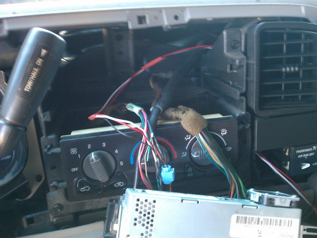

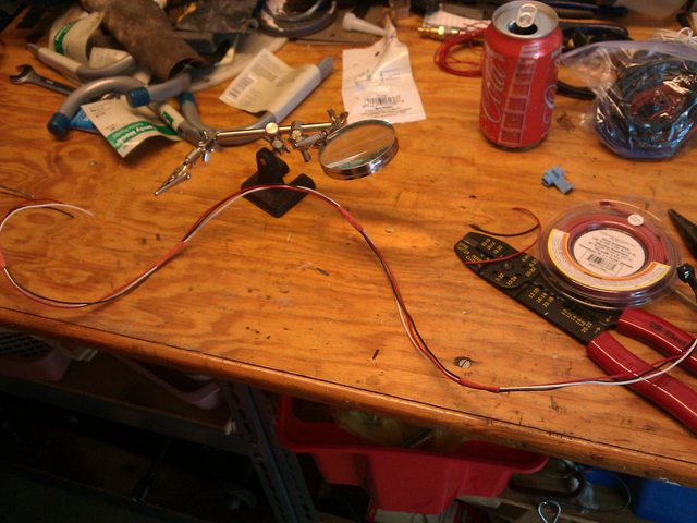

Goto radioshack. Buy a 1/8" input plug. Wire left/right/ground to the 9 pin aux input o0n the back of the headunit. Put a dummy tape into the tape player. Done.
There are a few DIYs:
Hooray! My aux-in doesn't suck anymore. - Chevy Truck Forum | GMC Truck Forum - GmFullsize.com

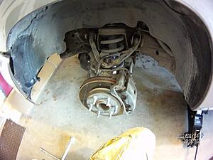

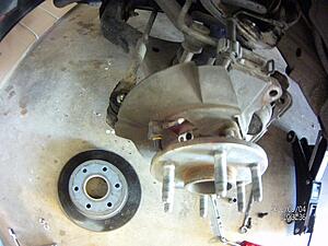

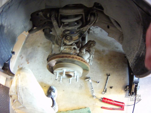

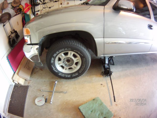

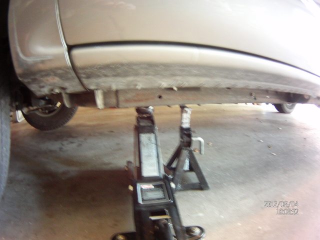

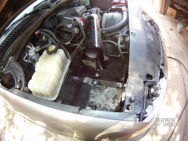

As some of you saw my other thread. I am having the ABS/BRAKE light issue. Checked the speed sensors in the front wheels and was kinda surprised. They both showed open, and occasionally they would flash about 200ohms. I am not used to sensors like thsi, I am used to them showing a specific resistance all the time, and it changes when you spin the hub. Thoughts?
More bad news. Pretty much both tie rod boots, and upper and lower control arm bushings are crap. The boots have cracked, and were pushing out grease, I repacked them the best I could, but it will have to be changed at some point. Anyway some pics from today:

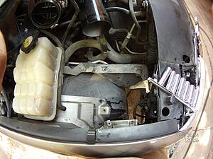

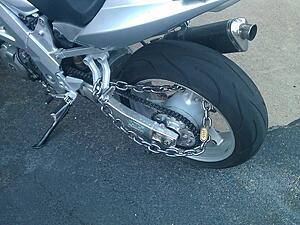

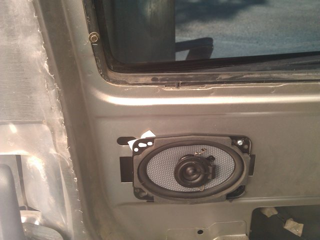

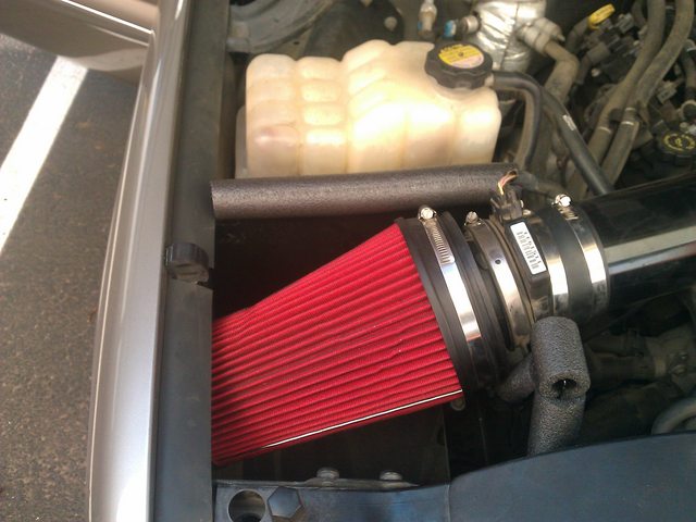

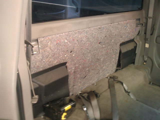

Got some infinity reference series for the rear. What a bitch to install. Also did some home improvement on the intake. Hopefully this will drop IATs a bit.
extra security measure now that i live in an apartment. They are clearing run off from my covered parking spot so thsi will normally be bolted to a large metal post.
a little extra insulation.
I hate ghetto rigging stuff in the parking lot. I wish i had a house. and all my tools and stuff. Ended up using velcro on all 4 sides.
