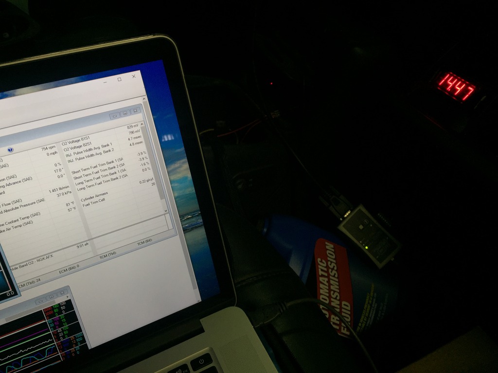

I'm new to tuning but is this right? I hooked up the analog output to the first two inputs on the HPTuners interface. Then I went into displays and right clicked the first empty spot. I selected the NGK AFX.
I started it up and here's a pic idling. The box displays 14.47 but HPTuners reports 9.01. Which one is correct? Do I need to calibrate the software?

Does it matter which order the wires go on the HPTuners interface? I've got the black wire in the top spot, yellow in the second.
the wideband is correct and you need to put in a calculation into HPTuners to get the software reading the correct amount.
https://www.google.com/url?sa=t&rct=...,d.cGc&cad=rja
here is an excel file that gives you the data you need to enter and sync hptuners with wideband. its a little tricky to get it exact as its always jumping around but you can get close

I looked at that Excel file and the correct math for my wideband is volts/0.7143 + 9.
Also, I did some searching on hptuners forums and found that I had accidentally put the ground wire in the wrong slot. Hopefully tomorrow I can go for a drive and play with it some more.
