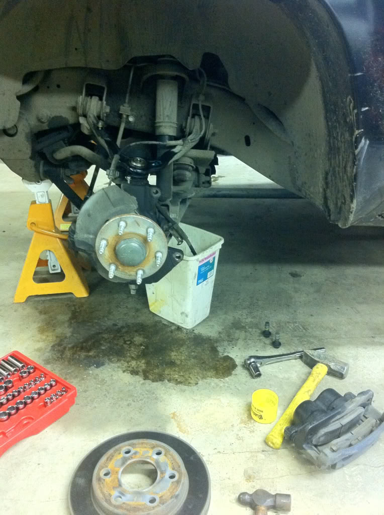

The first thing I did (after dawning the proper safety gear of course) was jack my truck up and take my tires off.
I brushed off all the dirt and sprayed penetrating oil on all the bolts. I removed the brake caliper and rotor.

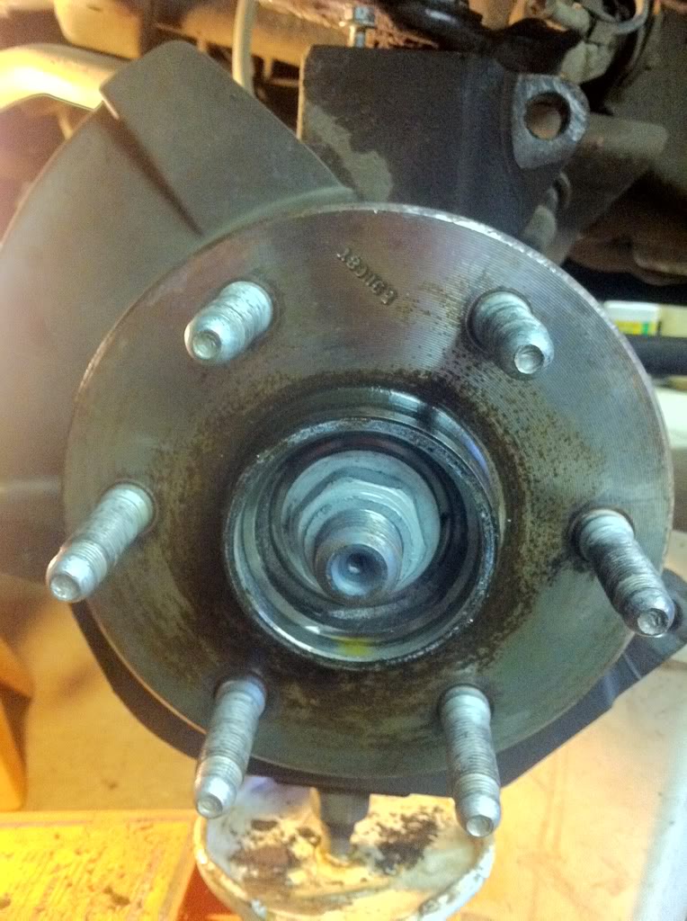

Removed the cover on the end. This is a 35mm nut. It's on there really tight. I think 140ftlbs. I removed it with an impact gun.
It was wedged in there do I used a screw driver to tap it loose.

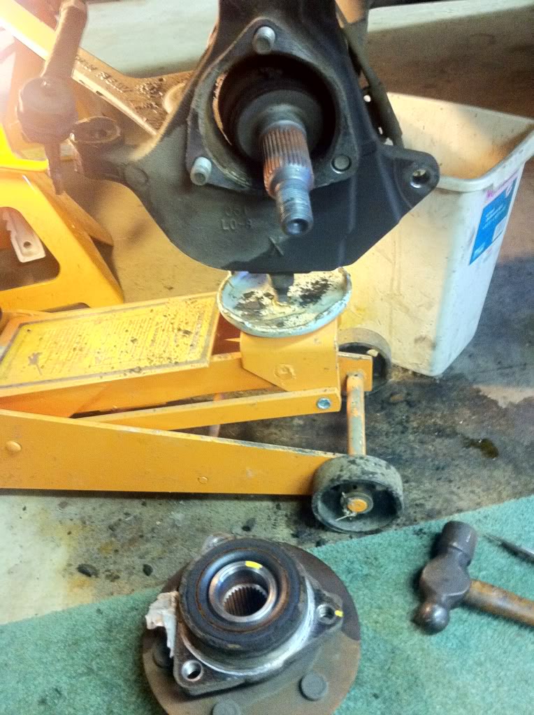

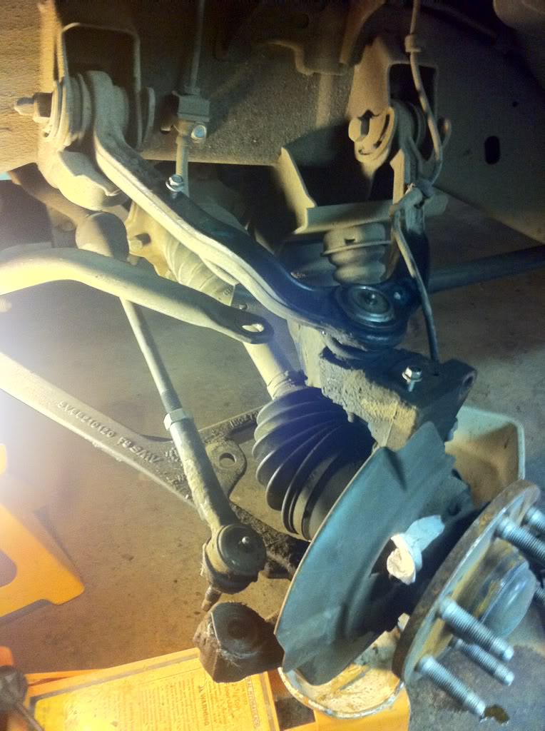

Here's where my troubles began. The next step was to remove the spindle. I managed to get the upper ball joint to break free by beating the side of the spindle with a 3lb sledge hammer. I spent quite a while trying to free the lower ball joint. I put a jack underneath it supporting the weight of the truck on the ball joint. Then I hit the top of the spindle as hard as I could. It just wouldn't break free.
I finally had to go to Walmart and buy a 10lb splitting maul. I just didn't have enough weight. It still took a few hits, bit I finally got the spindle out.

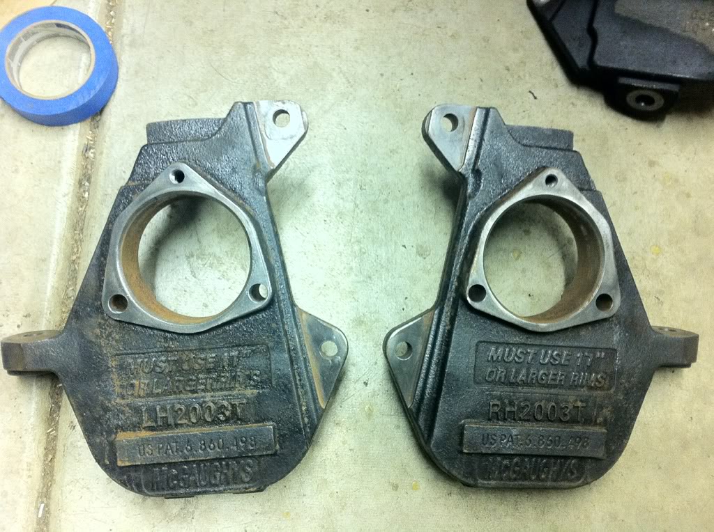

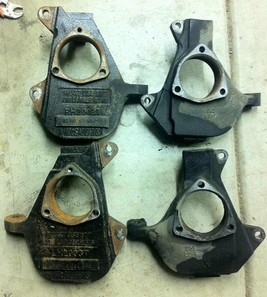

Here's a pic of the spindles.
On top is the Hellwig sway bar. Not only is it bigger, it's solid as well.
I went and cleaned up the spindles. I bought these second hand and they had some surface rust.

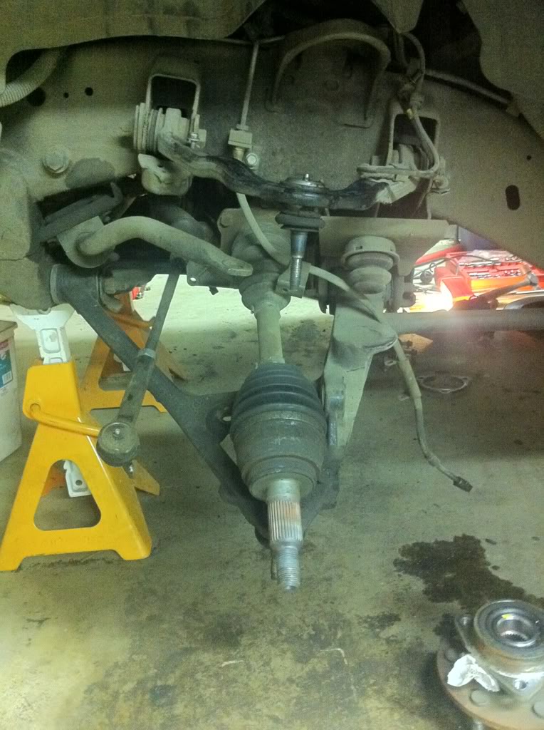

I was trying to avoid removing the cv joint. I ended up having to though because I'm going to have to clearance the upper ball joint. I finally got the lowering spindles on. I torqued the upper ball joints to 37ftlbs, and the lower to 92ftlbs.

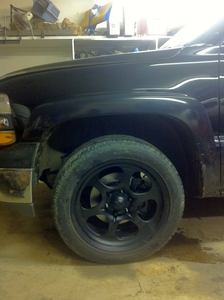

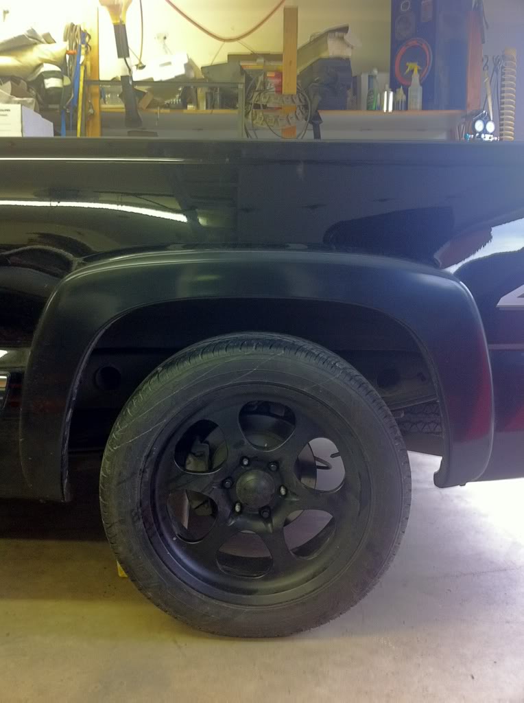

Here it is back on the ground. I'm really not impressed. Part of the problem is I never took any before measurements. Right now, it's 34.5 inches from the finder lip to the ground. That's exactly what it is in the rear as well. I haven't installed the lowering shackles yet.
The person that had it before me lowered the rear. I think he took the blocks out and put 2wd U-bolts in. It surprises me that it's perfectly level.
What are your guys's thoughts on putting in lowering keys as well as the shackles?

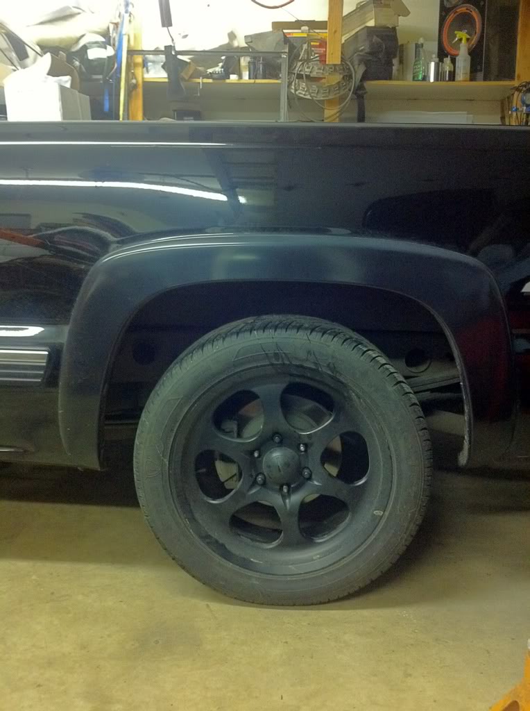

Well I installed my rear shackles and it didn't sit as low as I thought it would.

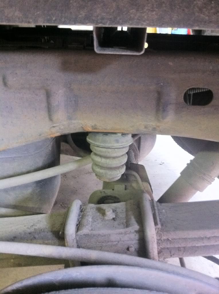

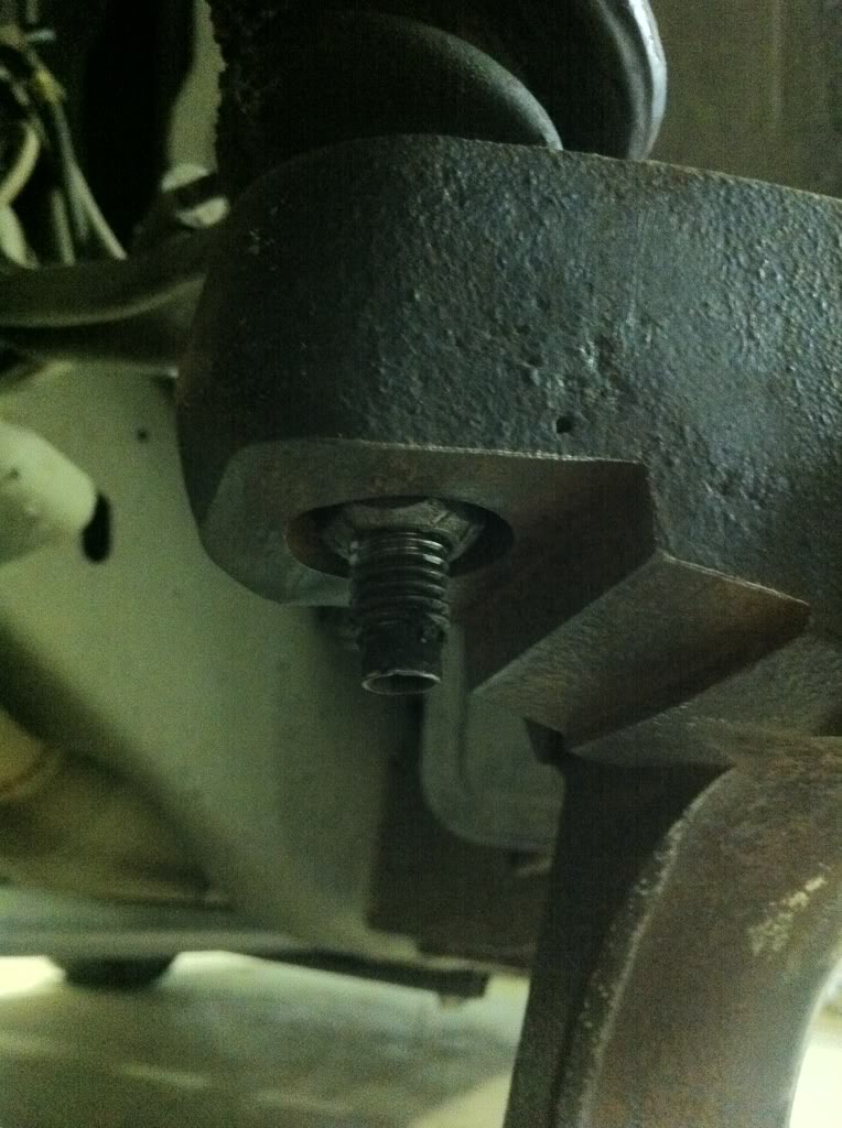

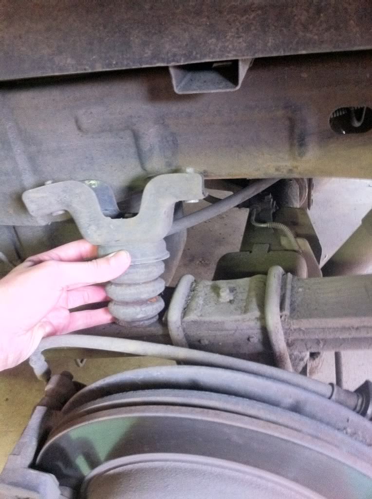

I realized it was resting on the bumpstops, so I removed the bracket.
...and mounted the bumpstop directly to the frame. Chevy even has a hole already in place and everything!

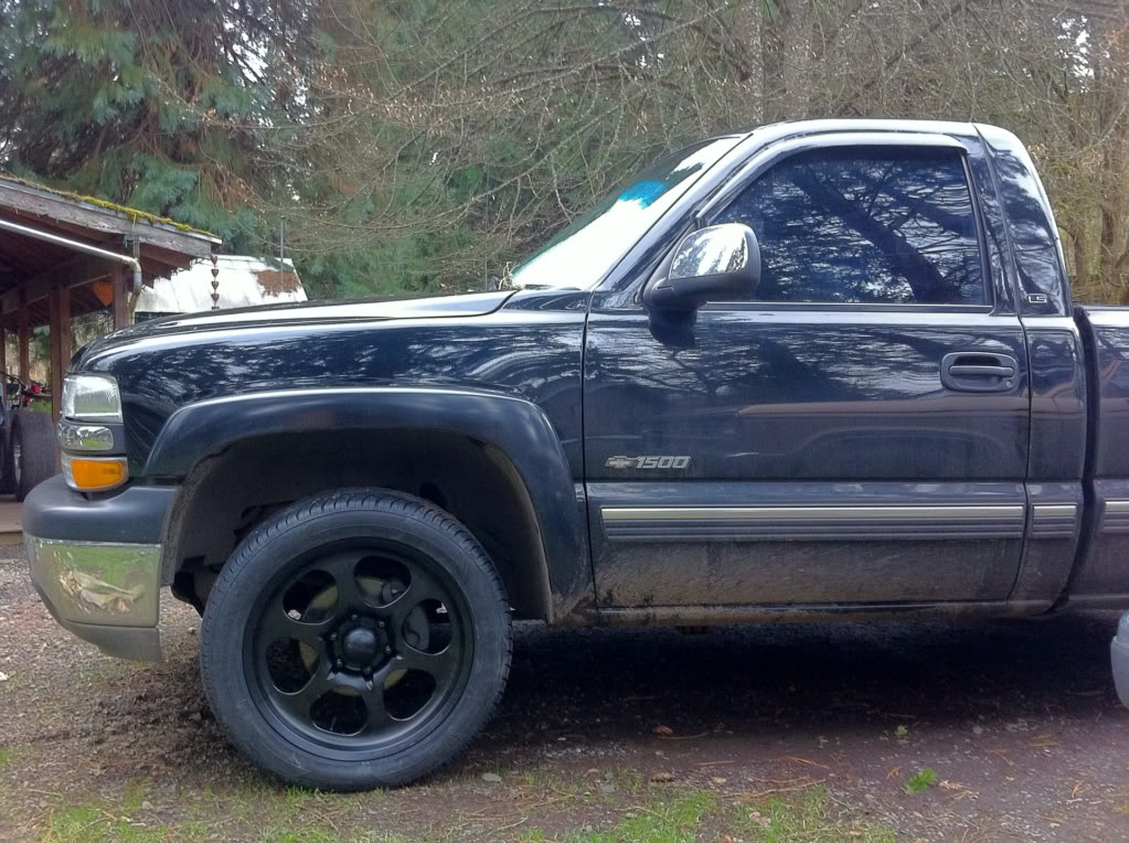

It doesn't look like much but the truck is sitting about an inch lower in this picture.
The idea has always been to make my truck look like its 2wd. I don't want it slammed, just lower.
The rear now measures in at 33 inches from the fender well to the ground. The front measures in at 34 inches. I'm planning in cranking down the torsion bars 1 inch to make them match. I hope this doesn't effect handling too much.
