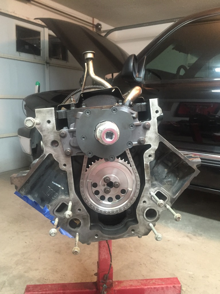

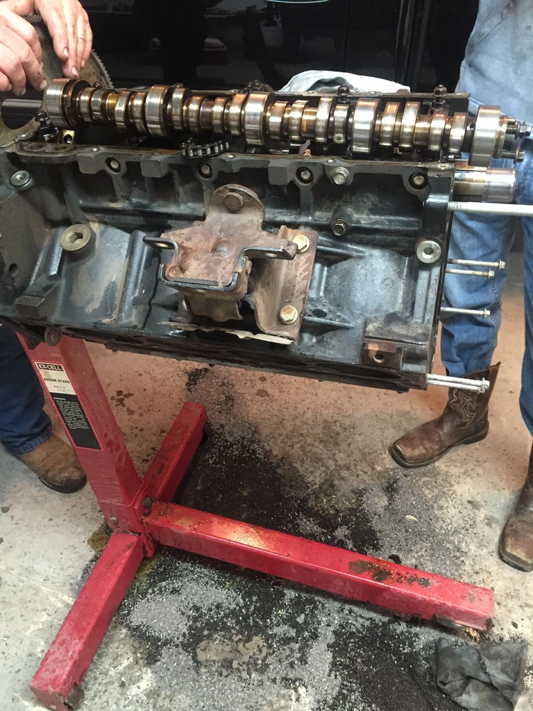

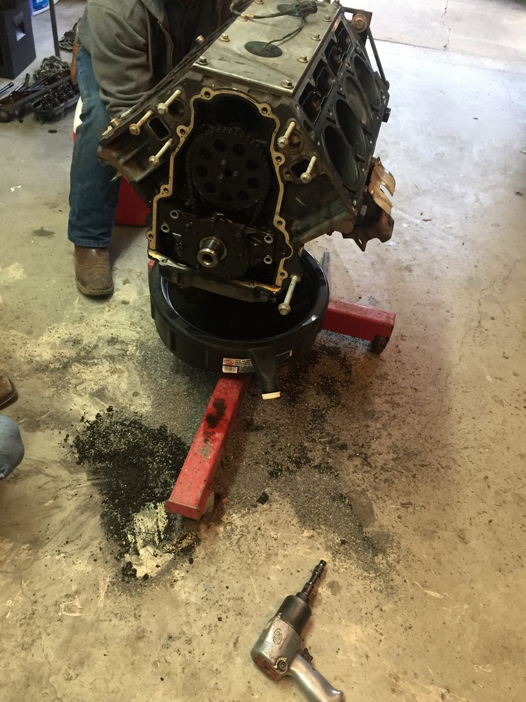

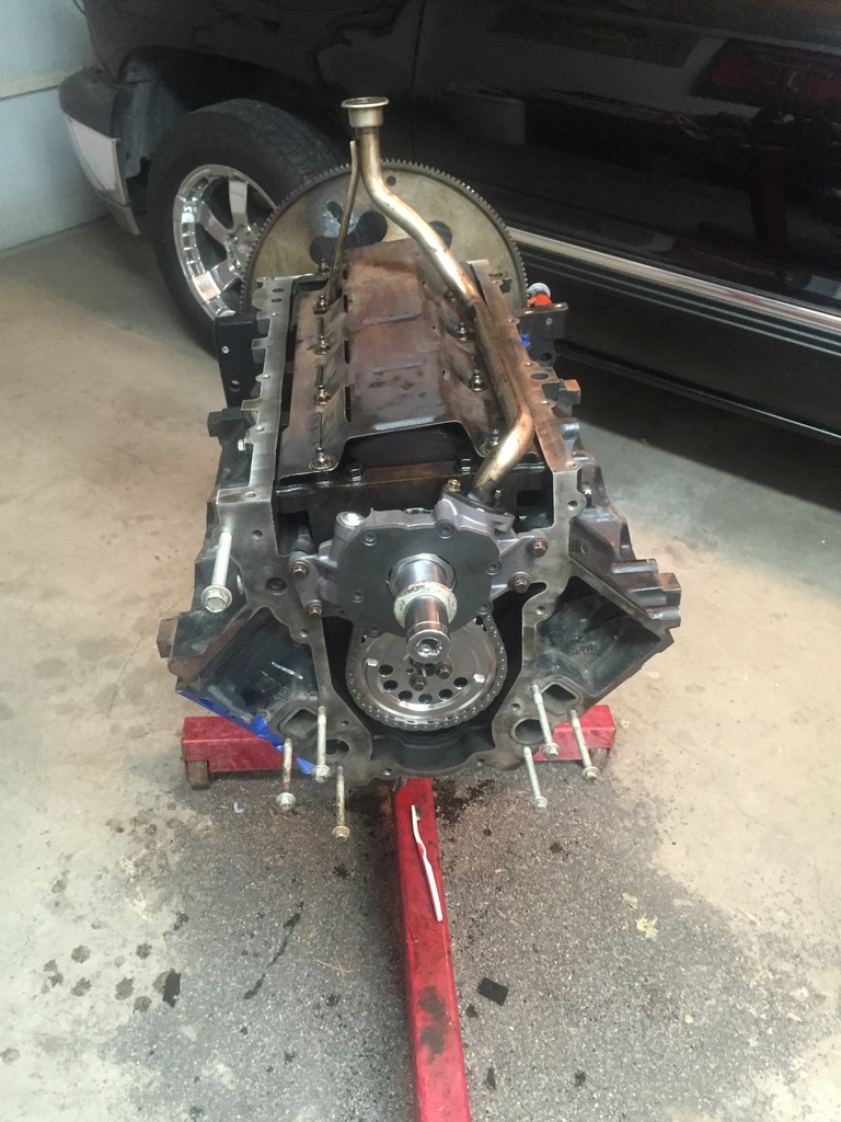

From: Amarillo, TX
Been doing some work here and there. Got the block stripped down and did some cleaning on it. Ended up replacing the rod bearrings since i was already there as a cheap insurance. Removed old cam, oil pump, timing chain. cleaned the block, painted the oil pan (will paint block same color). Got the new cam installed, new oil pump, new timing chain. Will put up pictures this week when i get the block painted.
