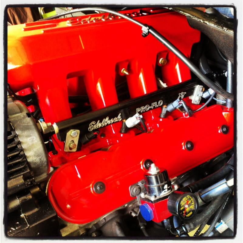

Behind the intake

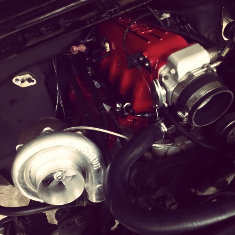

Looks great man! I am liking this build a lot. When are you going to fire it up?
thanks man. looking to fire it up within the next few weeks.
relocating the battery,and wiring the efans this weekend
