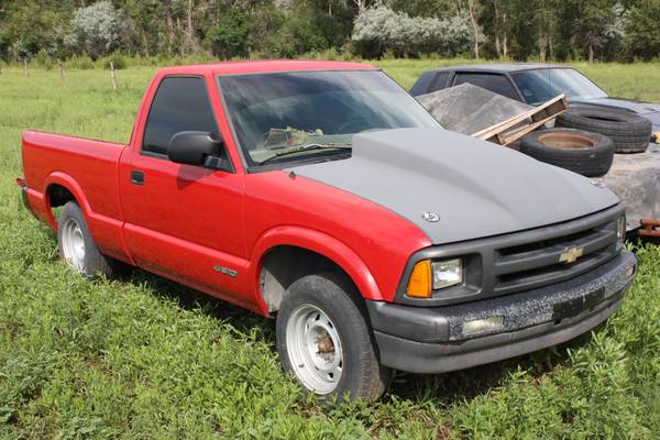

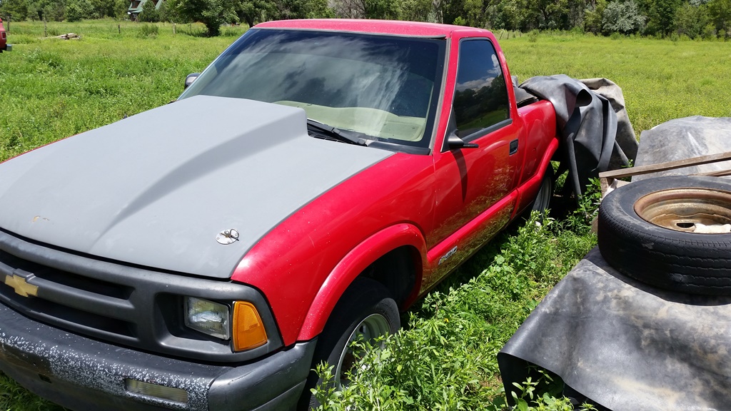

I got this 1996 s10 2 hours away for 400 bucks. came with clean title and used to have a SBC in it so it came with 4" cowl hood, swap motor mounts and headers, also radiator that was used on it.
This is how it was when i picked it up...

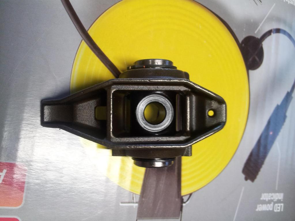

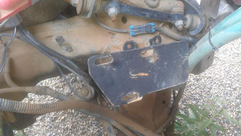

here are the mounts that came with the truck(yes i have a lot of cleaning and painting to do!!)

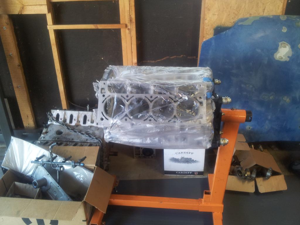

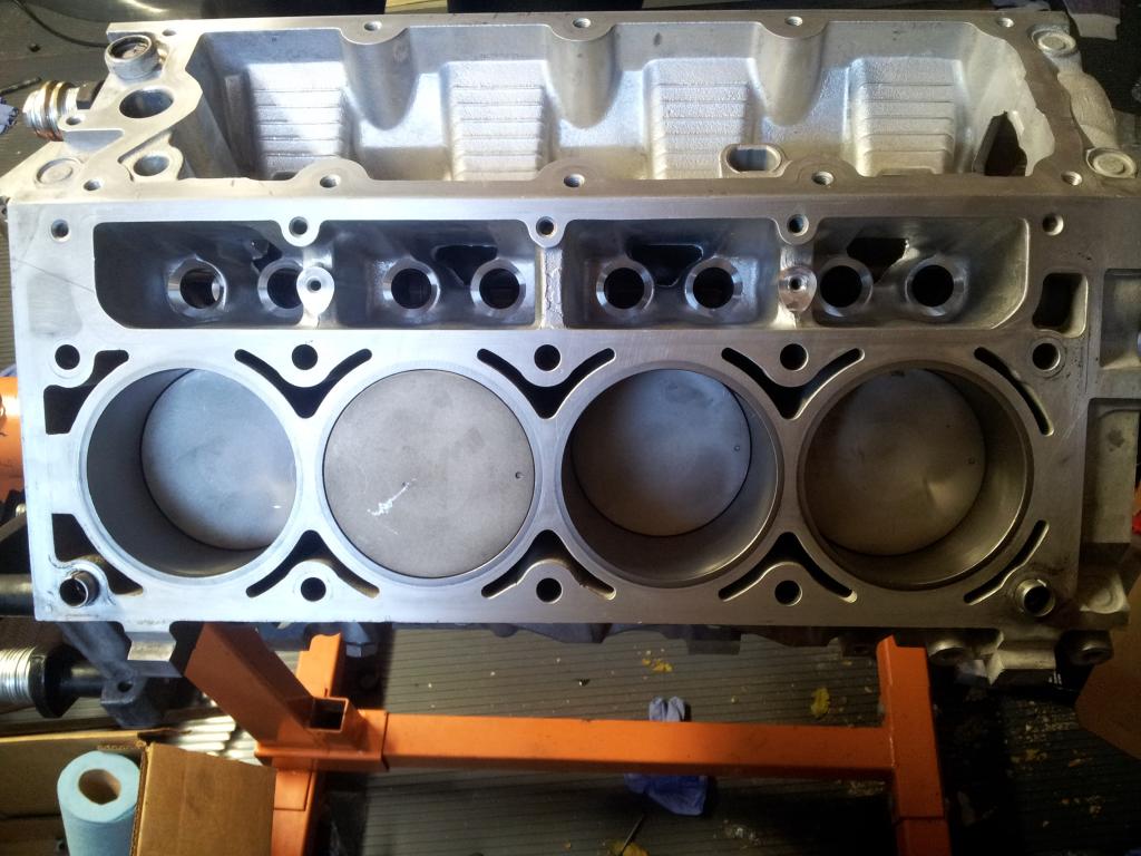

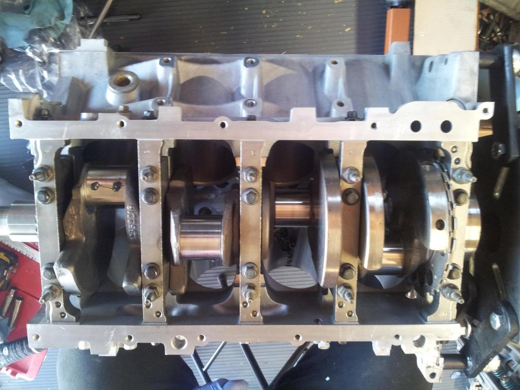

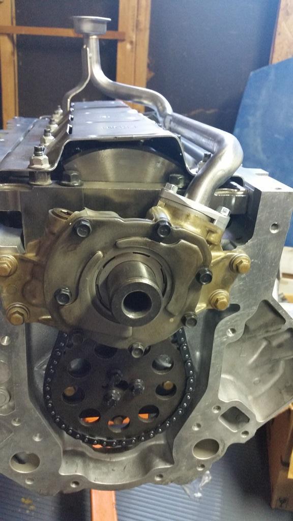

Picked up a LS1 straight from the machine shop (had 58k miles before going there) with mostly everything for $1,500 bucks and got the long block together this weekend but i forgot the stupid head bolts to get the heads on and measure the push rods.
run down of parts for the engine i have bought:
2002 LS1 that came with LS6 intake.
2002-2004 Z06 cam with springs with 6k miles on them
Corvette alternator/PS bracket
GM power steering with pulley and resevoir
Power bond corvette harmonic balancer
LS7 lifters
Trunion upgrade kit for the stock rocker arms
LS2 timing chain
ARP rod bolts and timing gear bolts
oil pan kits from CPW
shorty headers from CPW
LSX polo swap mounts from CPW
updated rear cover with new rear seal, gasket, and bolts
i think thats it well atleast what i can remember

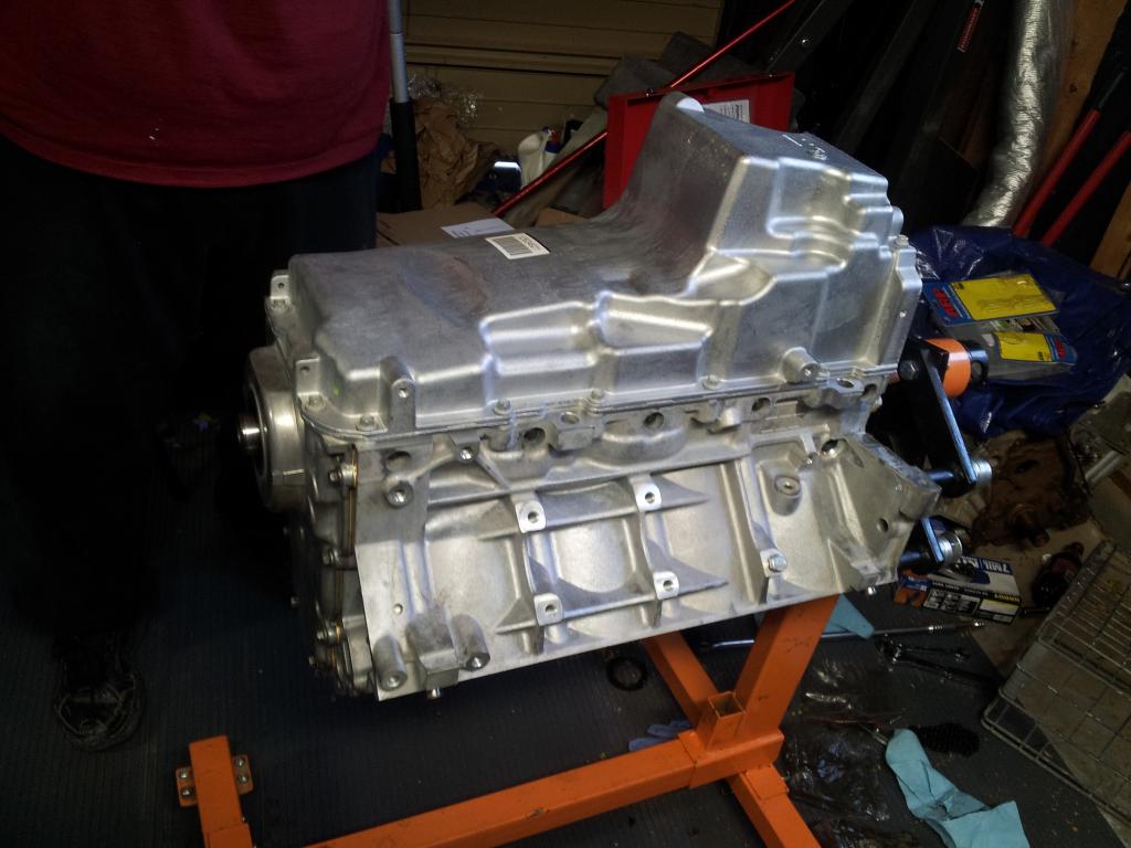

This is how the engine came when i bought it. still in the bag from the machine shop same with the crank

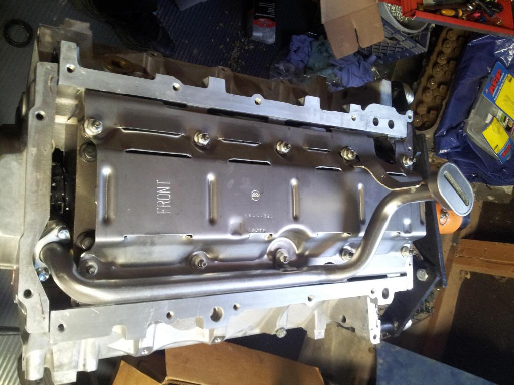

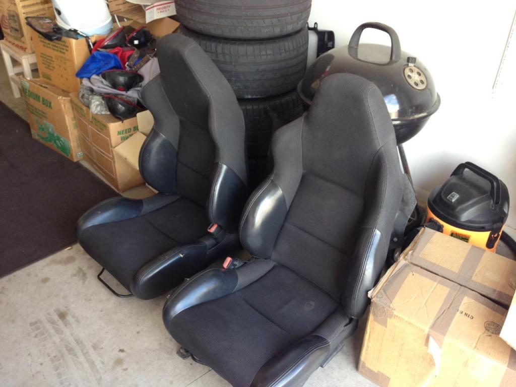

I also picked up some SRT 4 seats with just a little bit of wear for i think $180 bucks just have to make brackets or something to get them installed.

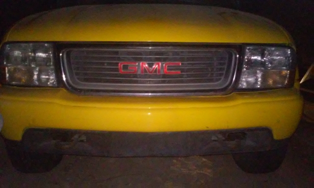

And this past weekend i got a 2003 GMC Sonoma front end with core support, lights with connectors and pig tails, grill, bumper cover, and bumper all for $170 bucks

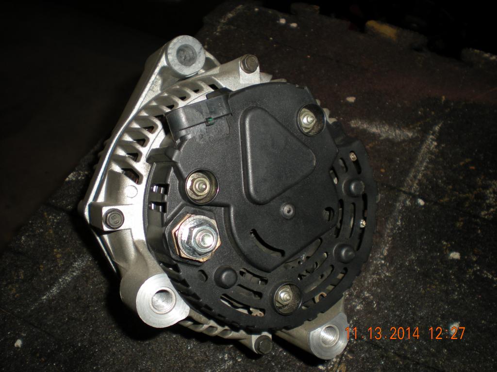

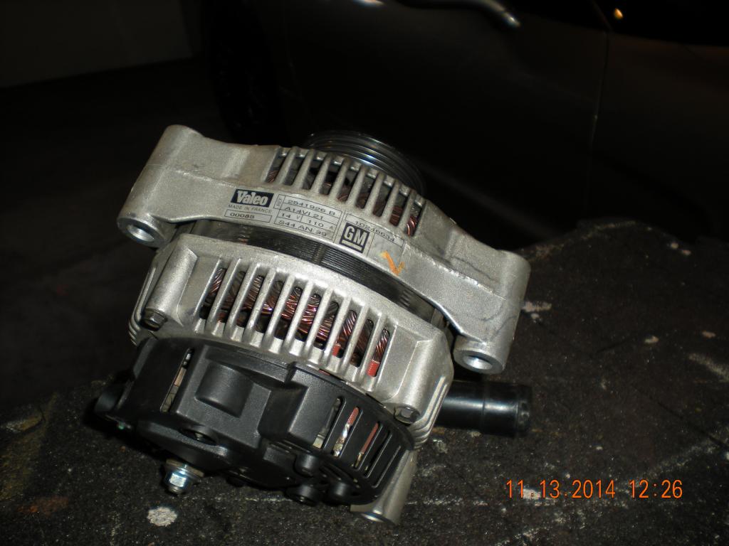

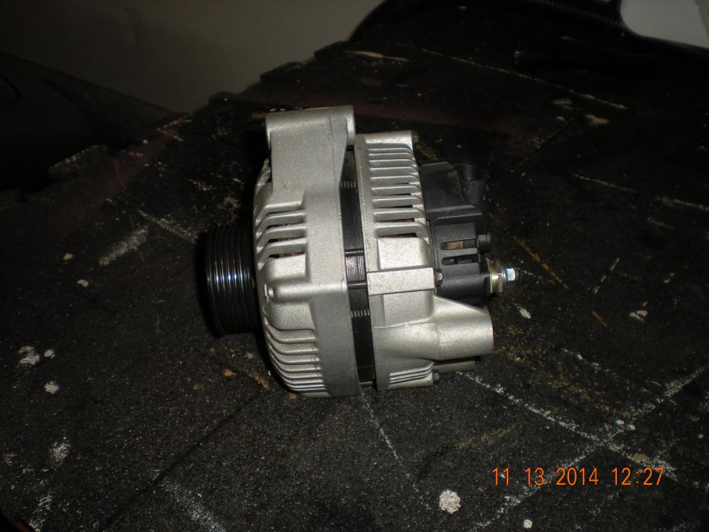

just picked up a 2000 corvette alternator for 125 bucks shipped. The person i bought it from it from said it has less then 10k miles on it and he upgraded his alternator due to supercharging his car and putting a system in it.

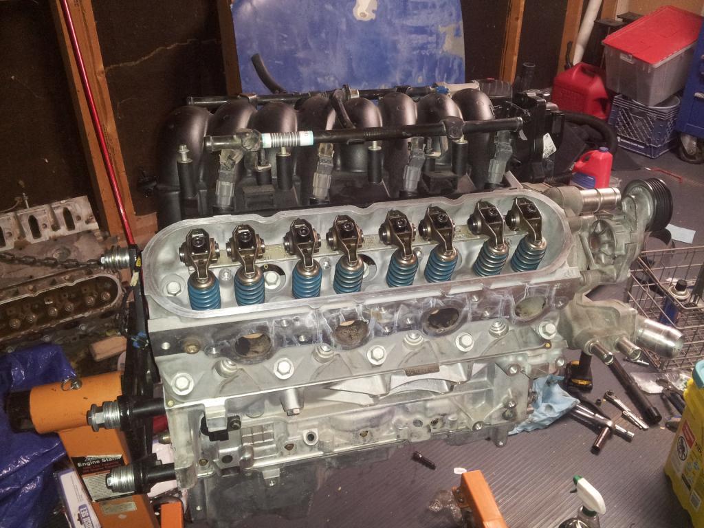

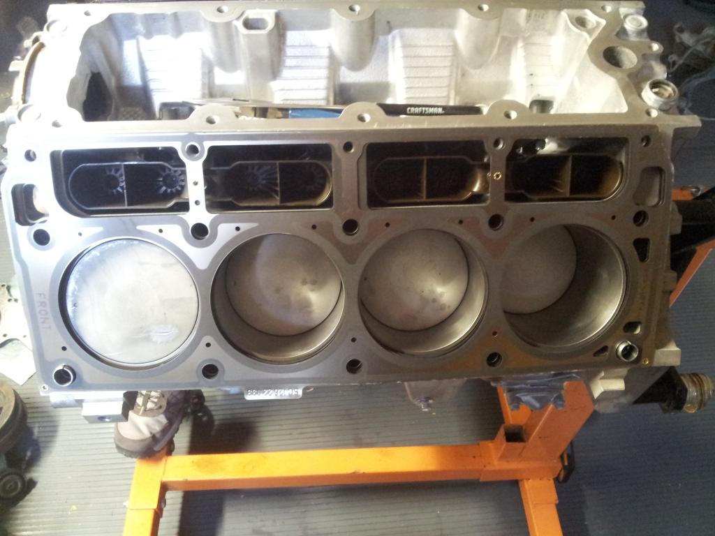

Okay my dad and myself got a little more stuff done on the truck. going to order pushrods today and hopefully put the engine and tranny in the truck saturday.
LS9 head gaskets on
Heads installed

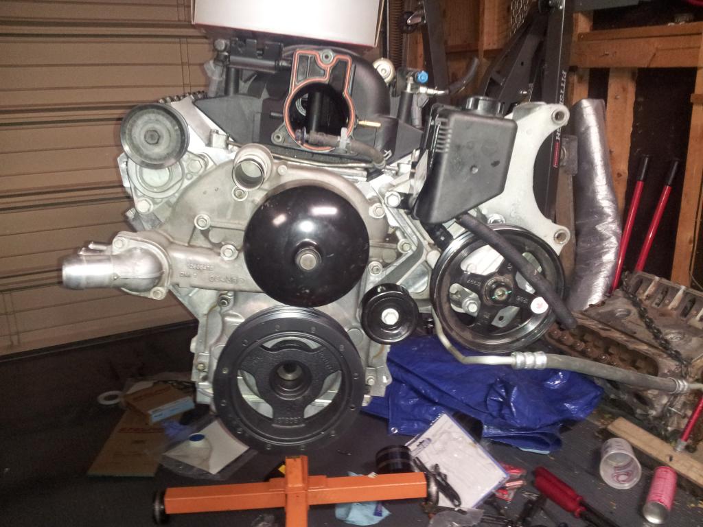

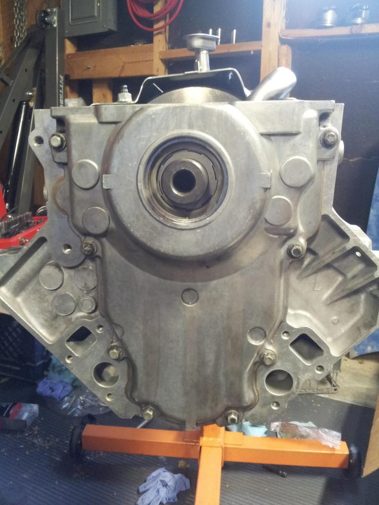

front of motor with corvette bracket, ps and water pump on. crank pulley just sitting there until i receive the install tool in the mail

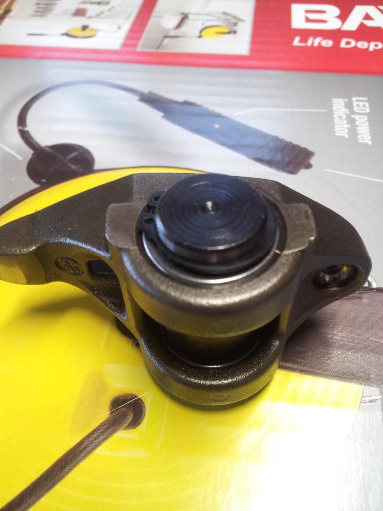

stock rockers arms with trunion upgrade installed to measure push rod length

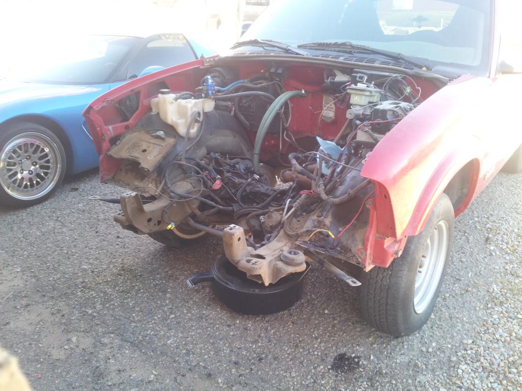

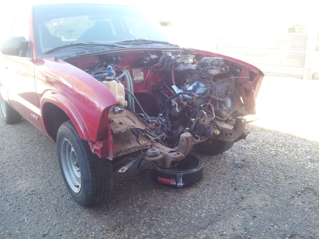

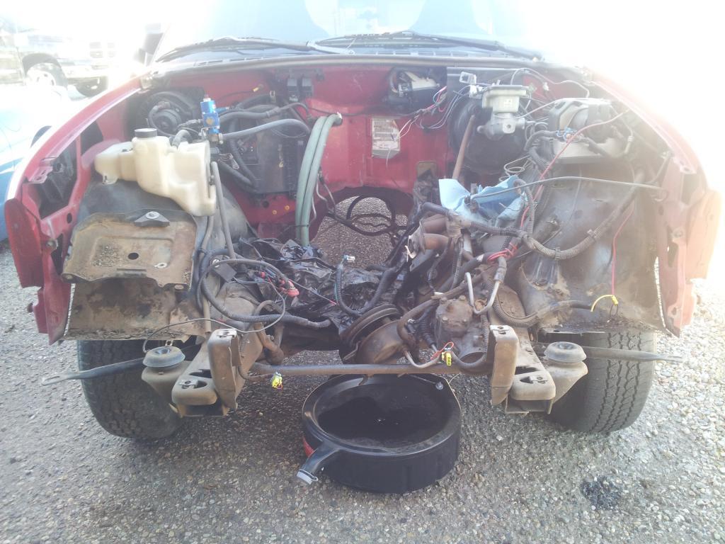

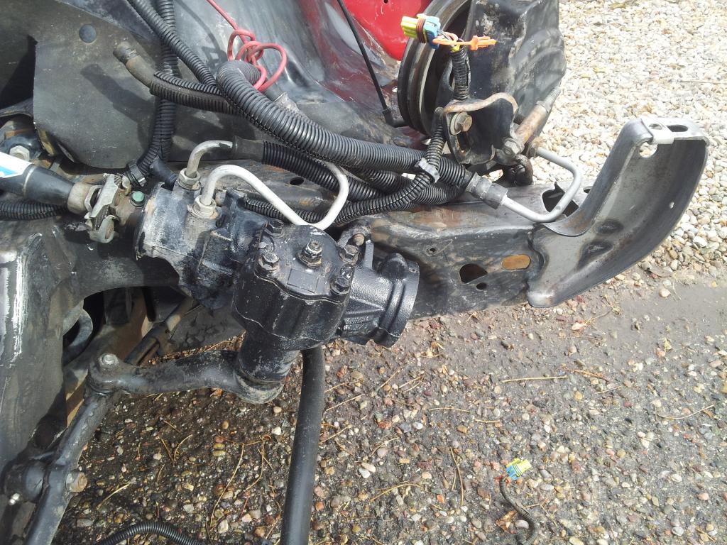

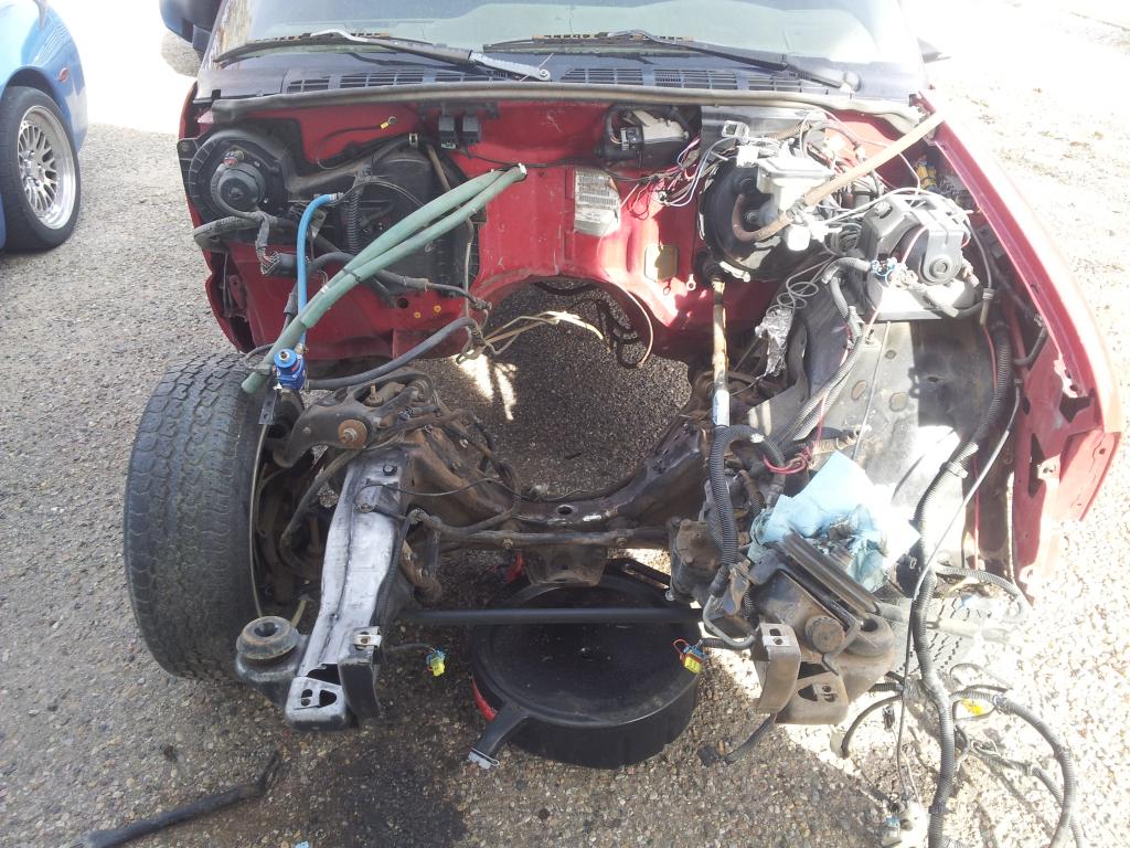

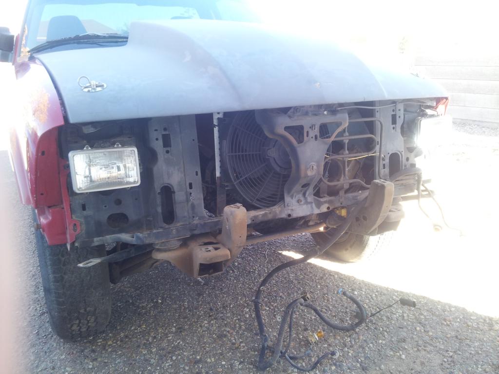

and started tearing the front end apart in 30 degree weather this morning to start cleaning and painting to get the engine in
before
some of the bolts gave me hell so is taking longer.

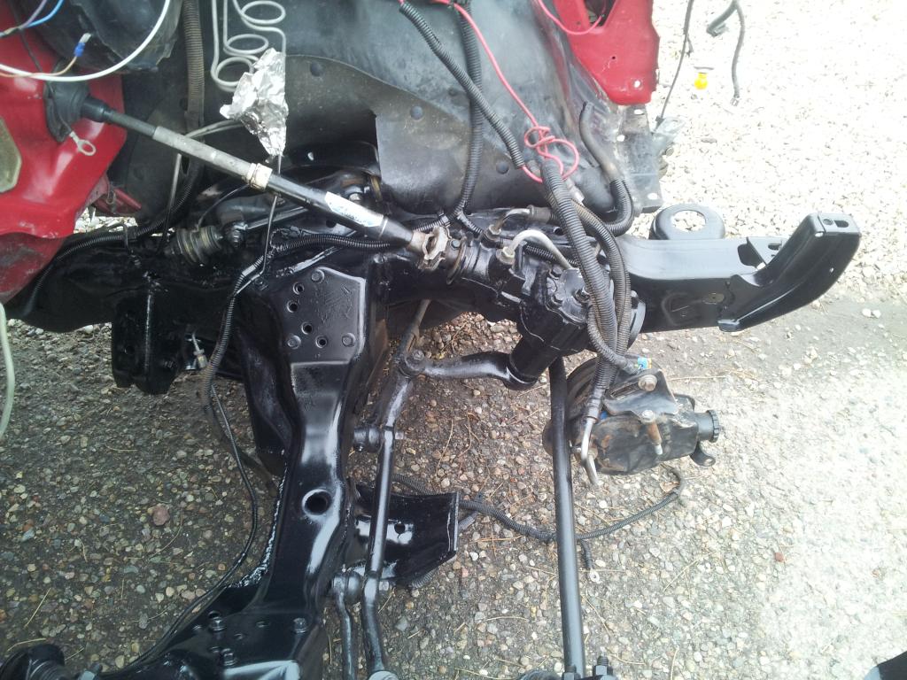

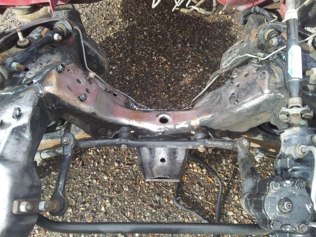

got more of the truck taken apart last night in 27 degree weather and started cleaning the frame some.

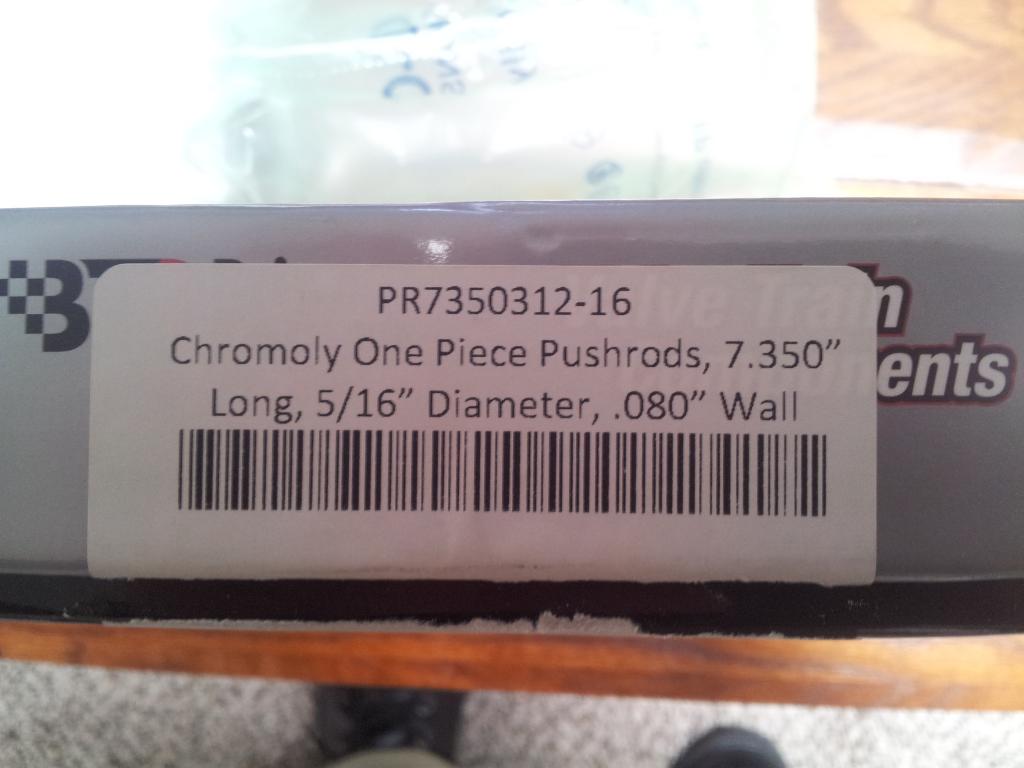

Here are some pics of the pushrods i got. will be getting a lot more pics this weekend as i took tomorrow off so i can get the engine bay ready and painted and also saturday we are putting the engine in the truck.

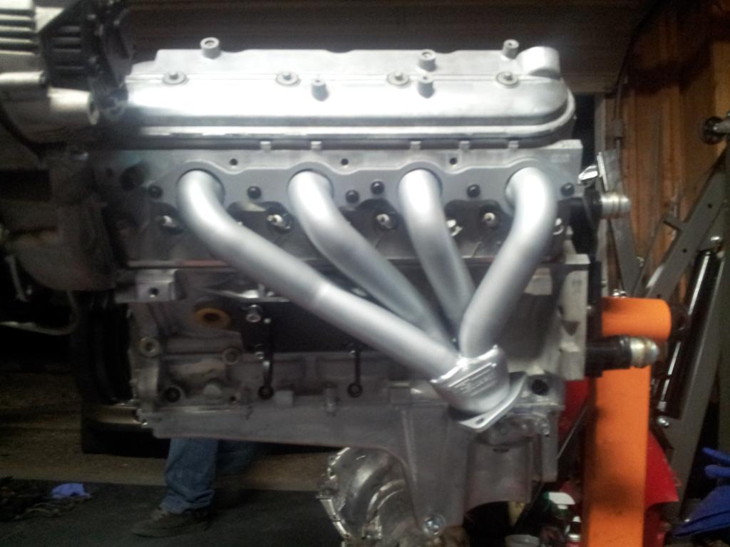

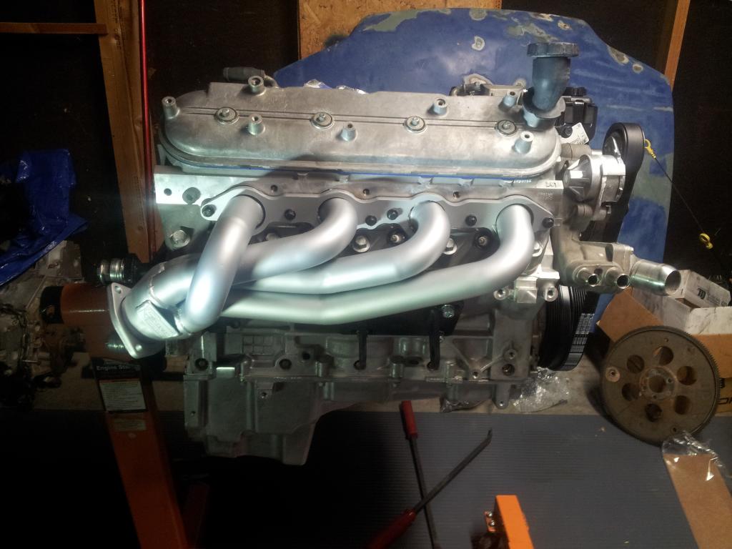

Took yesterday off to get the truck and engine ready to go in. Not able to put it in today because i didn't know the stock flex plate wont work for my 4L80E. but here are the pics

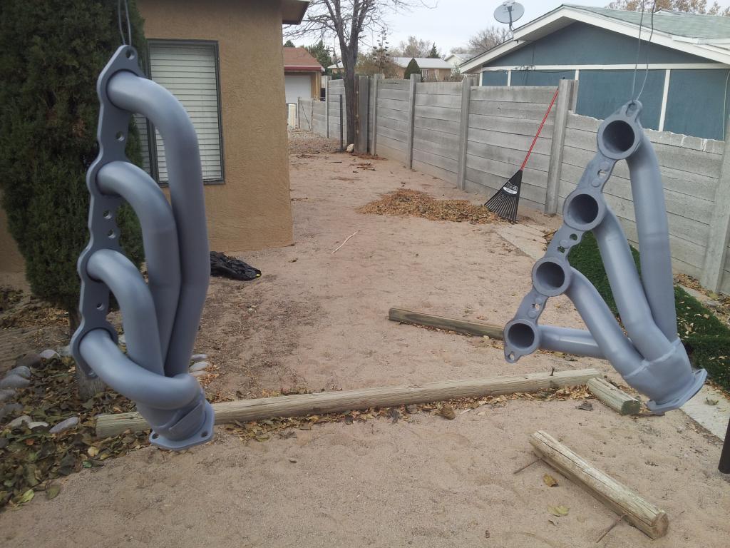

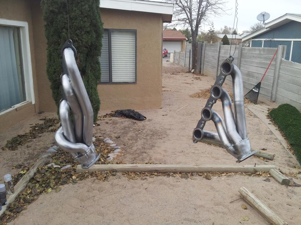

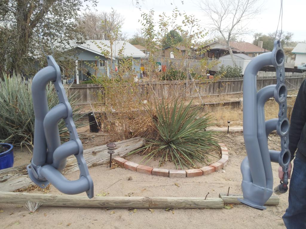

decided to prime and paint the sanderson headers instead of leaving them bare metal
before

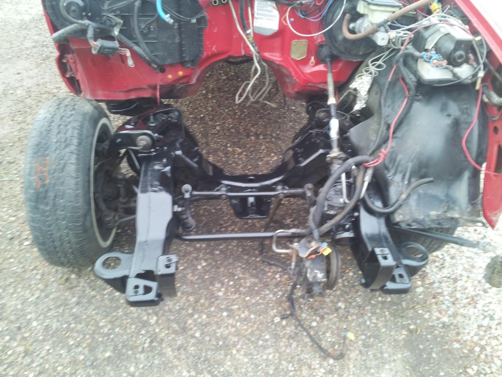

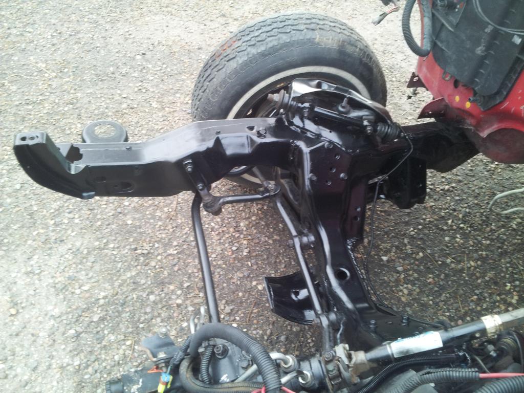

Here is the frame after cleaning
Here is the pics of the frame painted

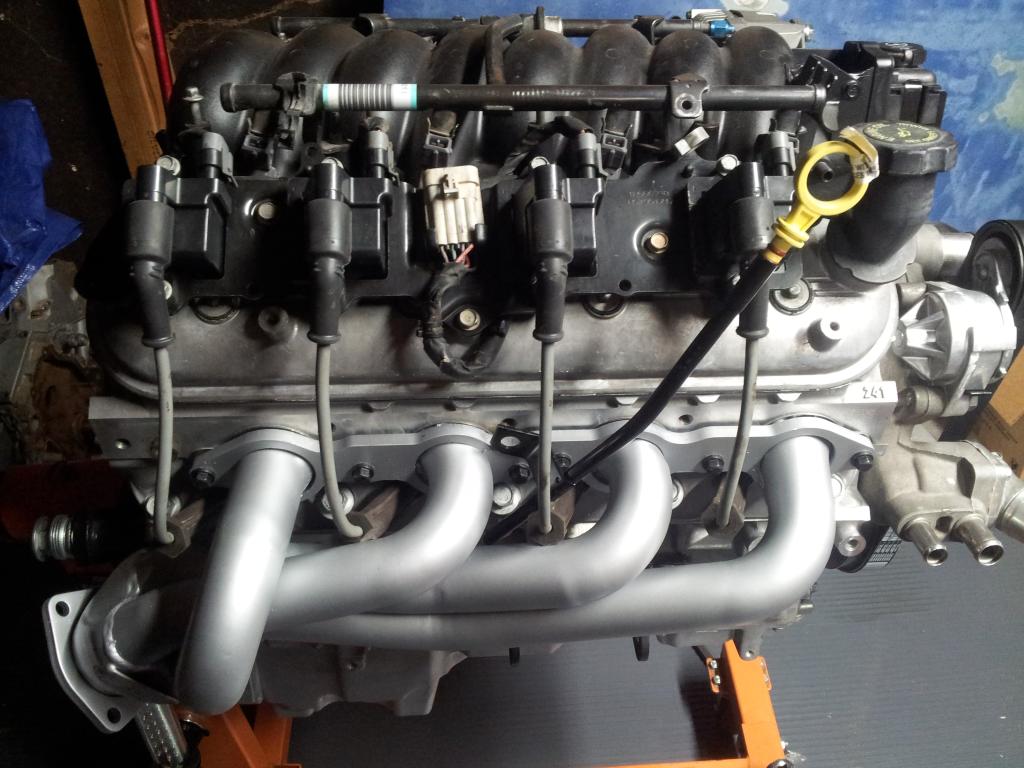

Got the front of the motor together
Here are some pics of the headers bolted to the engine and spark plugs in
And here is one side with the coils and wires on and a pic of the intake manifold sitting on the engine
