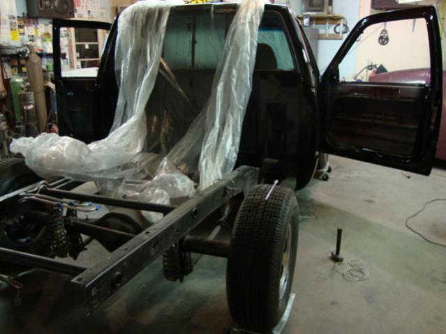

Painted the doors today.

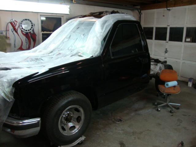

Default Doors back on...
Doors are hung on the truck. It seems whenever I paint a vehicle, I forget how much time it takes, start to finish... Not sure if I will finish in time for spring.
Attached Thumbnails 1995 sleeper truck 6.0-dsc00196.jpg   1995 sleeper truck 6.0-dsc00197.jpg
