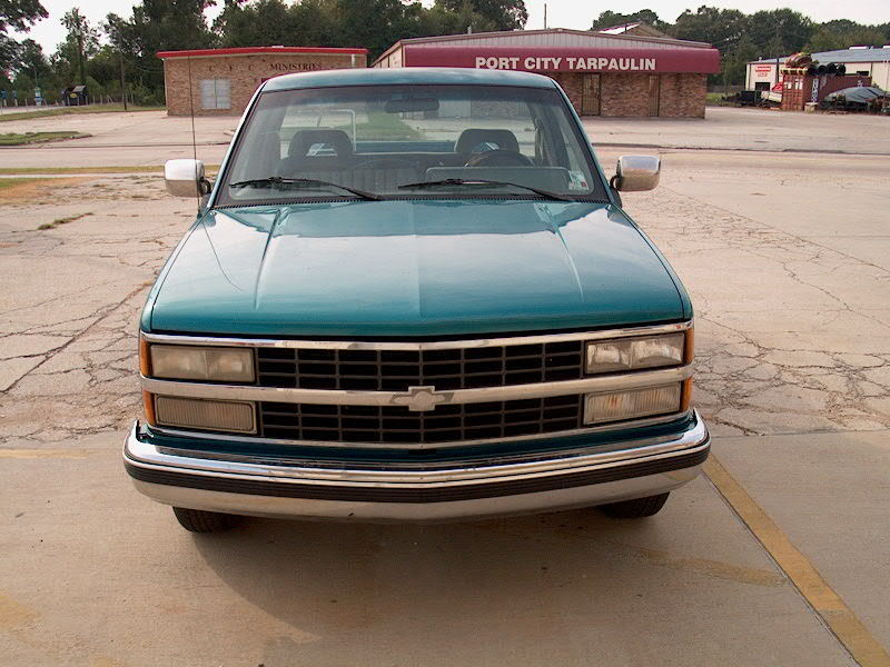

I got the truck in 2005 I think. I was 15. She had a three speed auto, a 4.3L V6, and a bad case of ugliness.

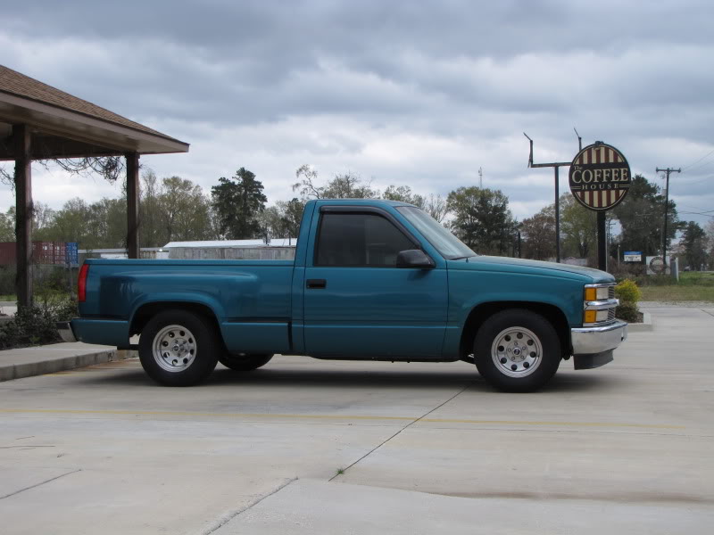

Skip to, say, 2008. Wheels, tires, grille, bumper, etc...

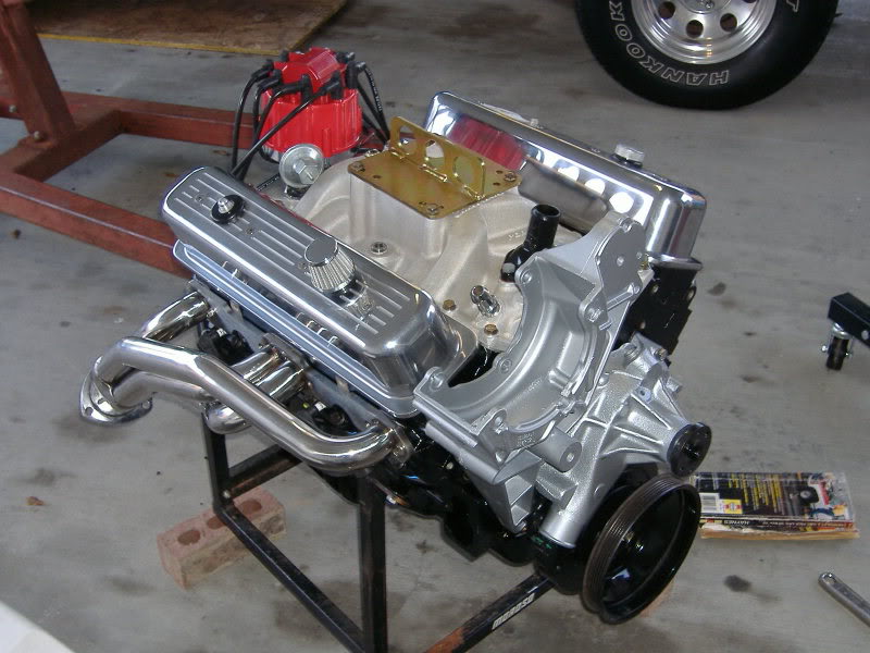

I was tired of chasing gremlins in the 4.3L and TBI system so I got frustrated and did some shopping, got together with my local engine shop, and we built this. Its was a Vortec 350 with some stock heads, a ZZ4 cam, Edelbrock intake, roller rockers, Comp push rods and a .30 over rebuild kit. It was around 10:1 with a Holley 4160 600CFM carb. The engine dyno put it at 367HP @ 5400 and 425TQ @ like 3400 if I recall correctly.

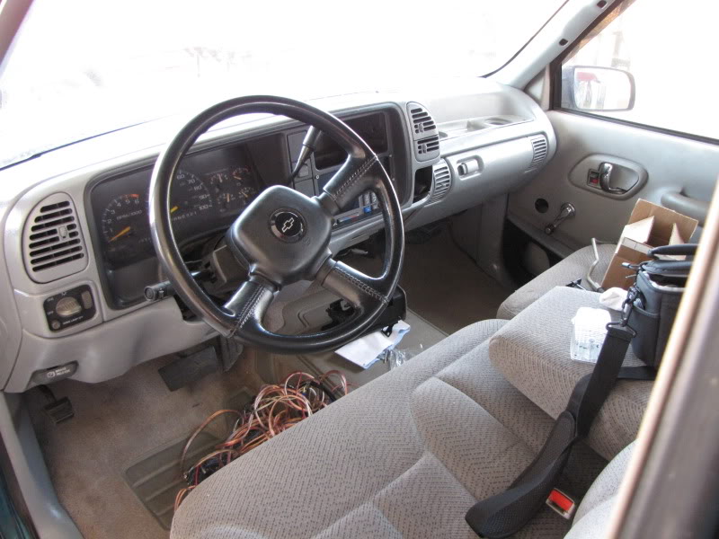

Oh, and around the same time, I switched it to (mostly, anyways) the 96 interior.

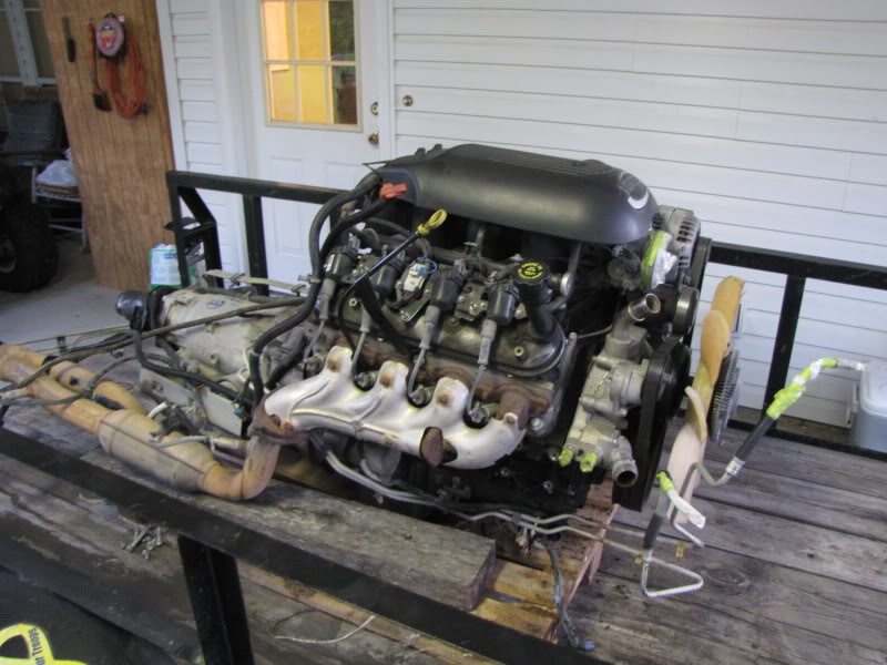

So, fall of 2010! Brought this home, courtesy of a local truck forum:
Cant buy them much more complete than that! Probably could have stuck a battery to it and fired it right up.

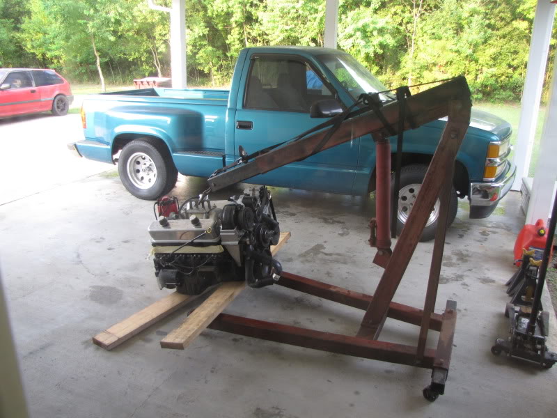

Bye bye, 355.

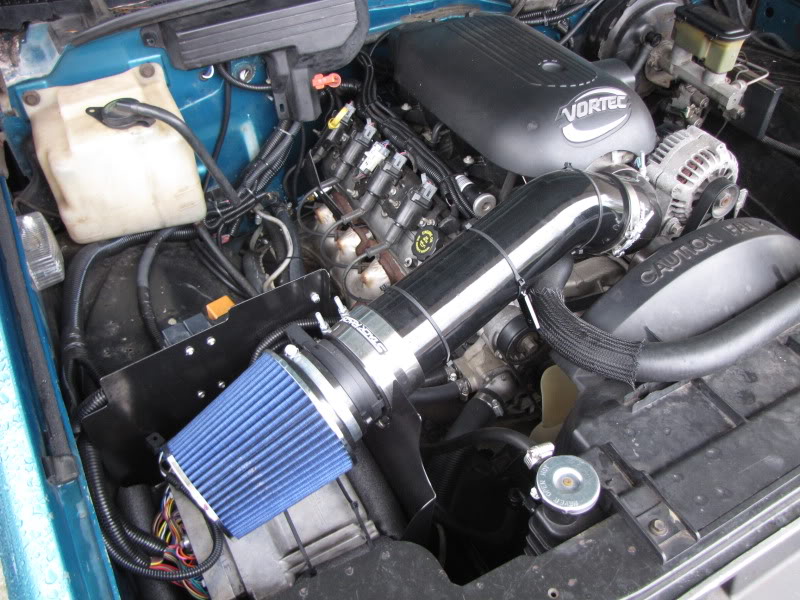

And shortly after (November 2010):
I have never loved driving my truck so much. She runs great, all the time, and has good power to boot! Smooth, reliable, and 17MPG with a tune and a heavy *** foot.
Anyways, I did the swap myself. Fuel and trans lines were made with Summit Twist Tight 200PSI hose and Summit AN fittings, a harness from PSI (started to make one, got lazy), Airtex Vortec 350 fuel pump, Vette servo, basic Ebay CAI, etc. PCM work by Geoff at EPS in Baton Rouge, LA.

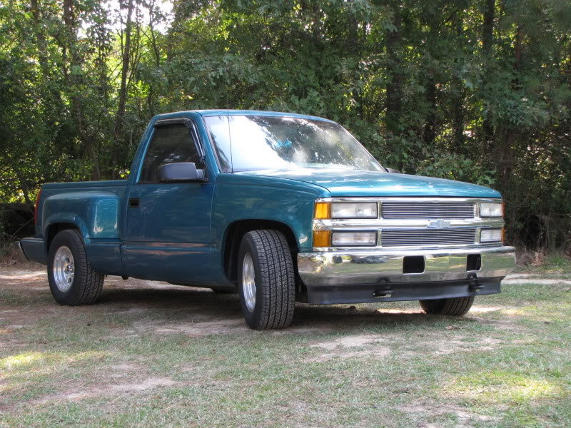

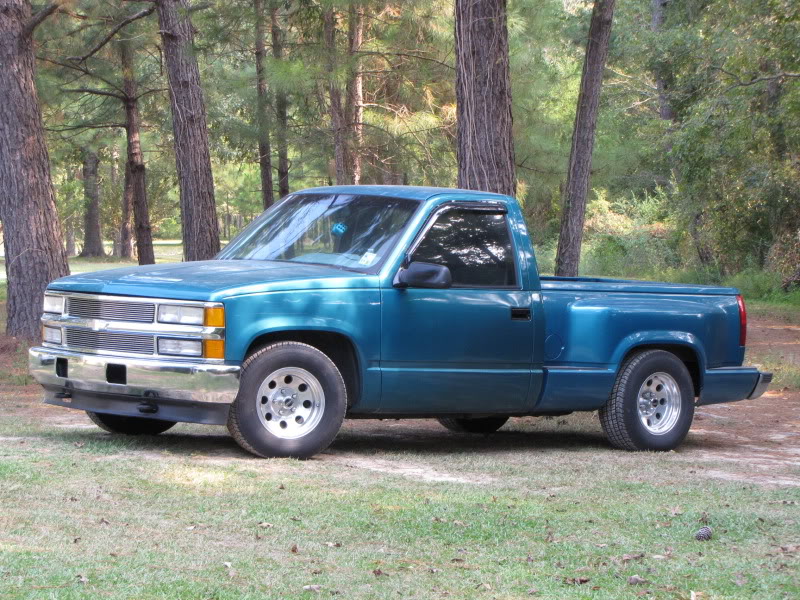

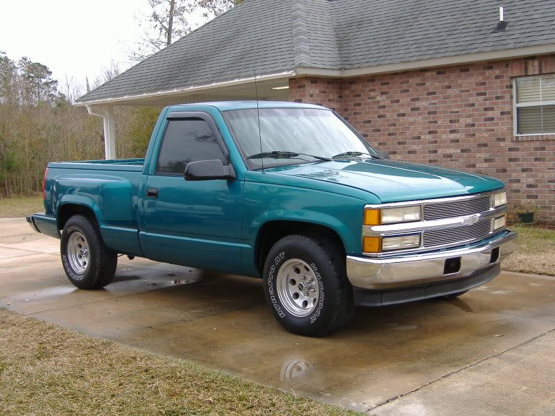

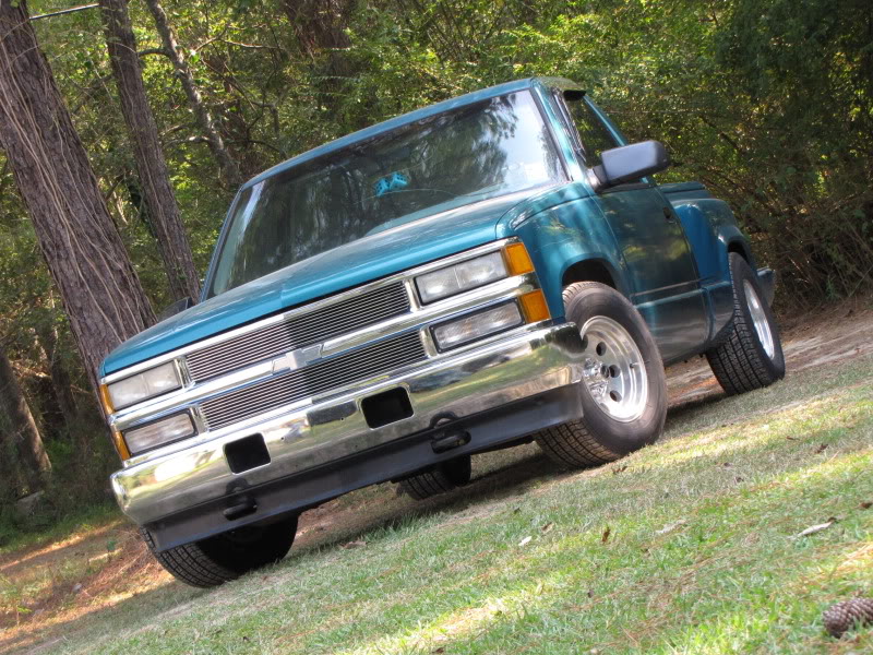

And here she is, one week ago.

Originally Posted by KDavis04ss
how much was the harness from PSI. Was it good quality easy install? Nice truck man
Thanks! I think it was $440. It was really nice quality for the money. Dropped right in. A couple connectors were pinned backwards or wrong, I think the MAF and the MAP but I caught it with my scanner and fixed them. Minor issue. A pin pulled out of the OBDII plug so I called the guy at PSI and he sent me some new pins to fix it the next day. Good service. I'd recommend them.

Did you use the LS A/C compressor?
Nah. Have to notch the frame and stuff to make it fit, wasn't worth it. Some people have made custom mounts for the old R4 compressors by cutting up a SBC 350 bracket. Novak also sells a really nice aluminum bracket with all the hardware and other stuff, plus a brand new R4 compressor but its $578. I imagine they would sell the brackets without the compressor though.
Eventually I will get AC in it but I have had this truck with poor/no working AC for so long I'm used to it not being there.
