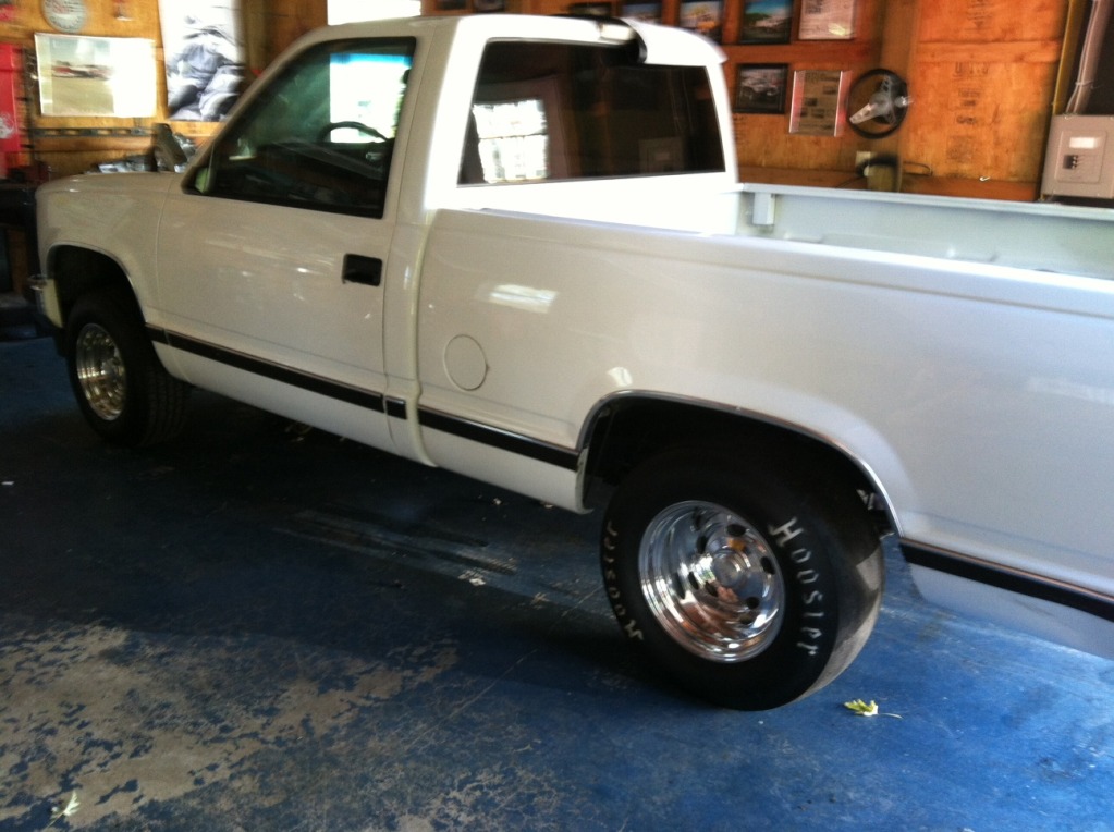

Ive had a 90 350 for a couple years and decided to make it a drag truck.i put a stock bottom end 454 with 1969 396 heads and a 400 trans.
I ran this combo in a SS454 truck 12.0 on motor and 11.0 on a 150 shot at 4400lbs. Im hopeing that after removing a lot of weight and a much lighter truck it should run 11.50's on motor and 10.50's on spray.Alls i have left to start it is a new starter.I need a 3000 stall,gears and a spool.

alright here we go.
