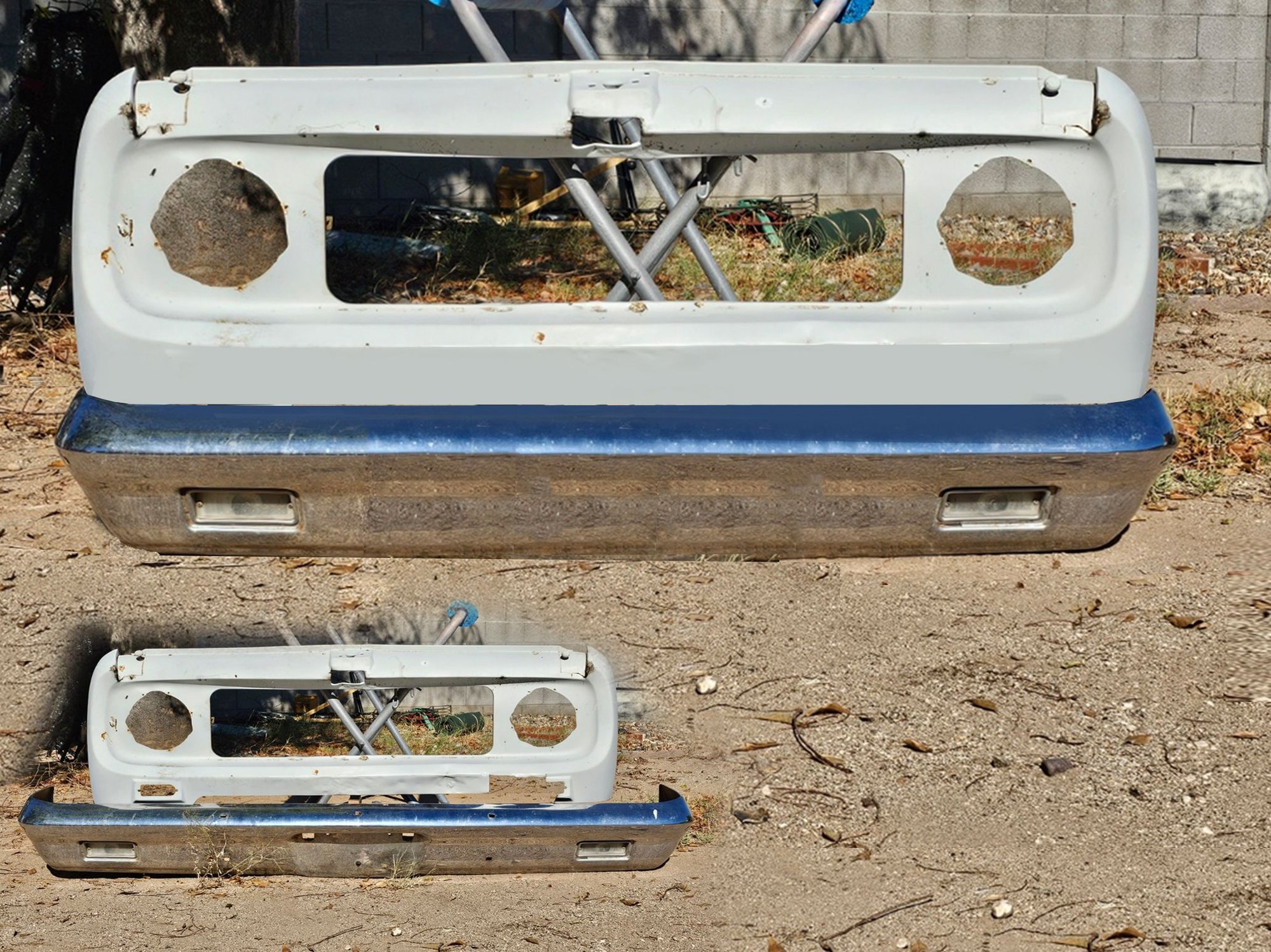

Here is the bumper shortened to fit the scout. I have not shortened the sides of the bumper asi can't really do that until i assemble the front end to see how far I want it to go onto the fender..
I had to 'strgihten' out the bumper as it was more V shaped then it looked.
Came out pretty good though.
I am not sure if i am going to weld up the bolt holes, or use them..

decided to weld the front solid and make a 1 piece front end
sat the frotn end onto the body and propped up the bumper to see how much i have to cut out of the sides of the bumper.
Thought this pic looked cool with the scout between the other cars.

Little more trimming to the bumper..
i need to fab up brackets now to hold the bumper to the frame so i can make final cuts and adjustments on the bumper to fit the fender well openings and body lines better

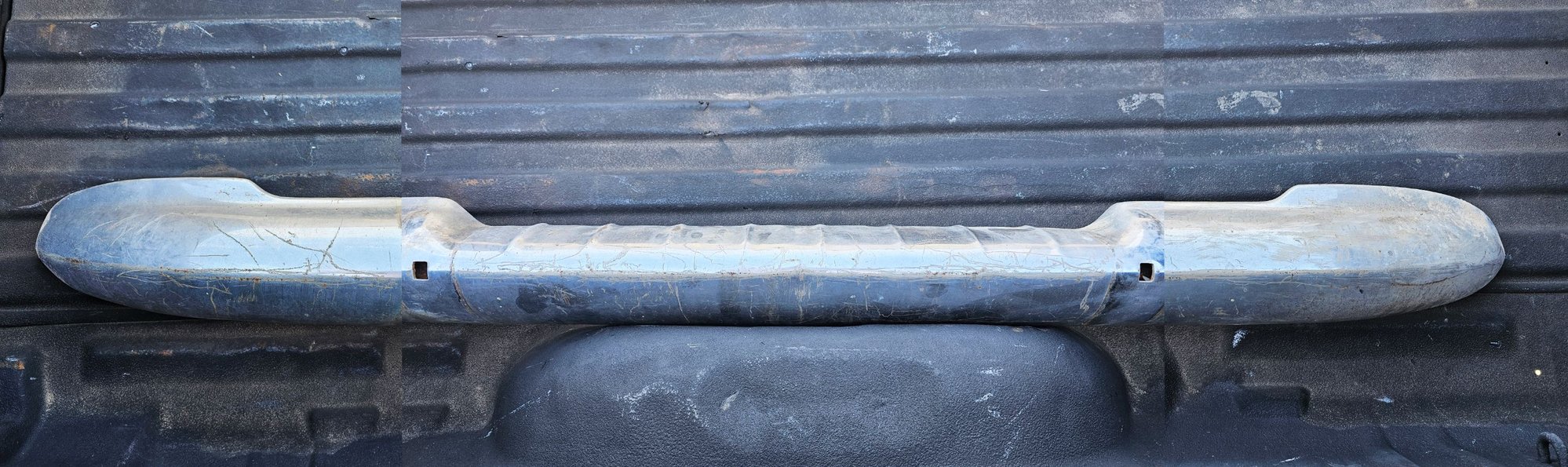

Just got this beautiful 1942 Cadillac rear bumper dropped off. I think I can make it work for the rear of the scout. I didn’t need this extra work, but, the front bumper is coming out so good looking, I might as well adapt a bumper to the rear end as well..
