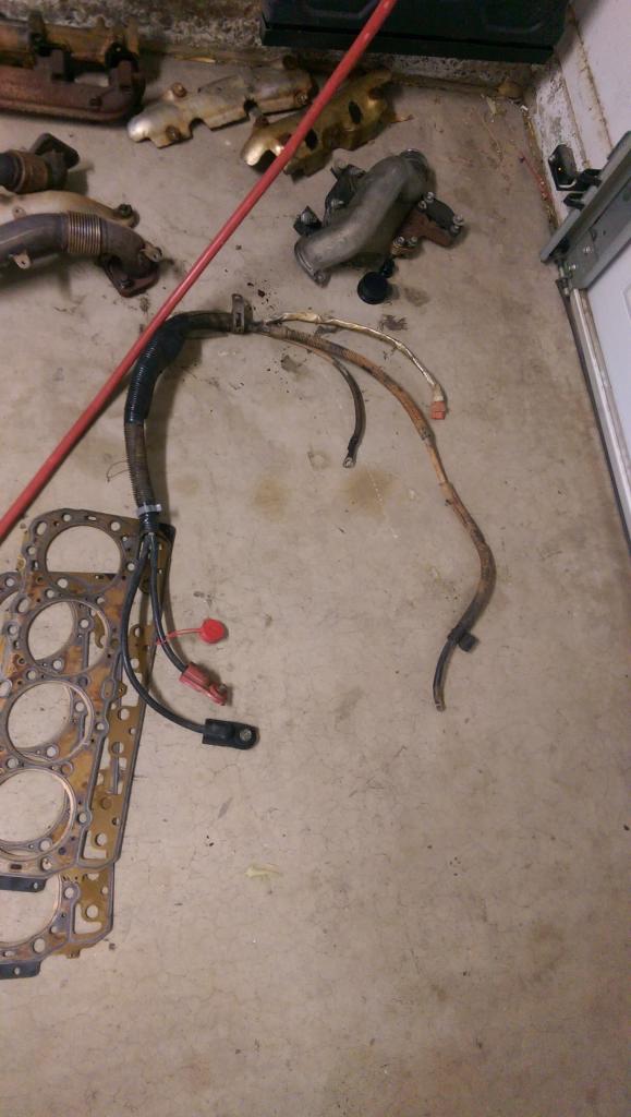

Doing piddly crap in the garage since I have no other parts to work with at the moment.
Deleted the passenger side battery cables tonight. The two positive cables are joined at the starter, this is the only point where the two sets of cables come together. I just cut the passenger positive cable from the starter ring terminal and taped everything up.
Before:
After:
Here's the part that was removed. Includes the block heater cord, not necessary here in Phoenix.

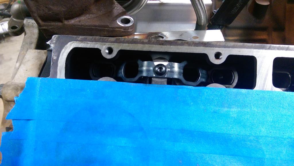

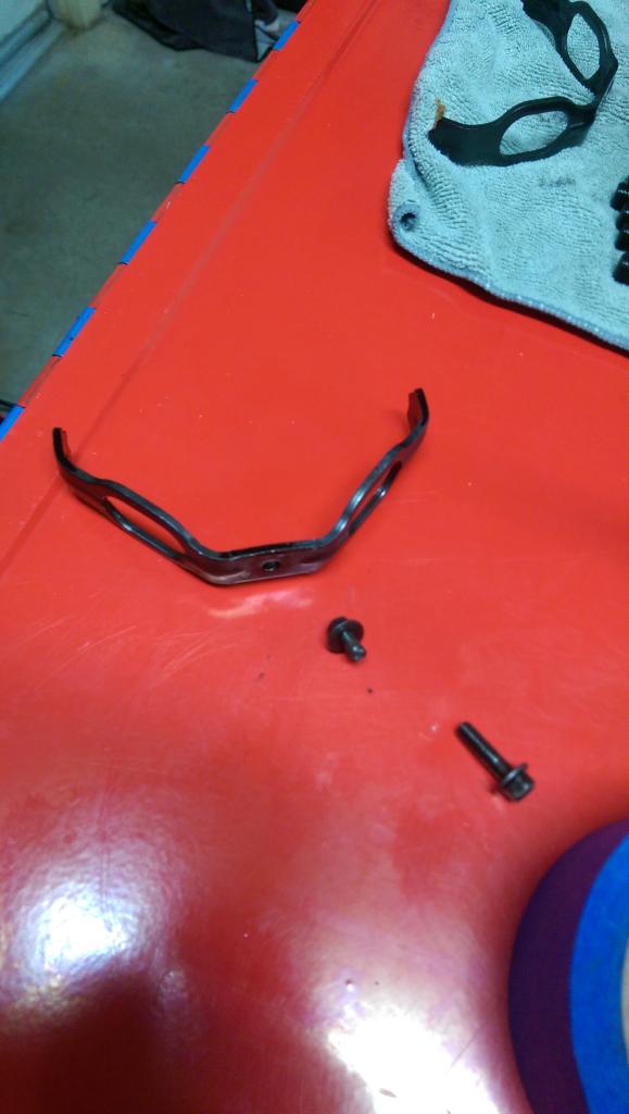

I KNEW it was going too smoothly. I pulled the lifter retainers to wipe them down and somehow broke one of the bolts going back in.
Drilled out the bolt hole in the block, retapped a little larger, and used another cap screw I had in my spare bolt bag. Took me about 2 hours to fix but it's done. Phew.

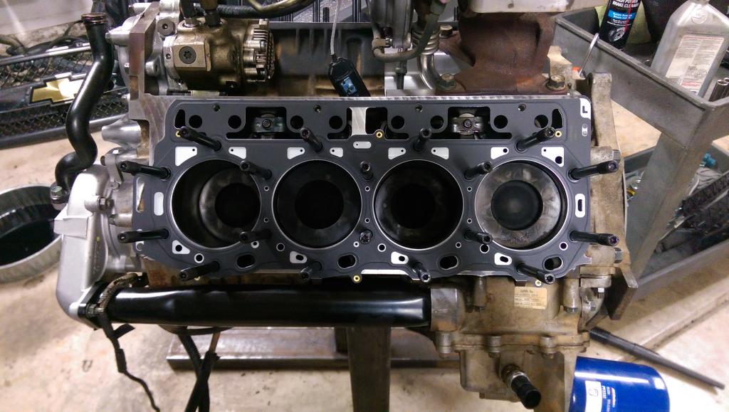

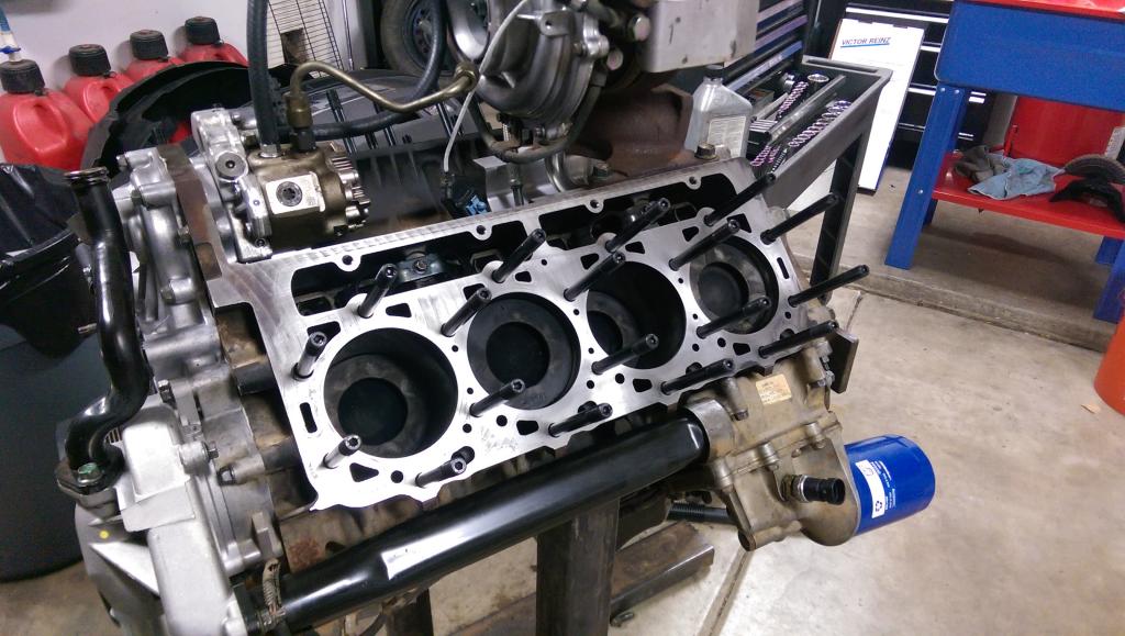

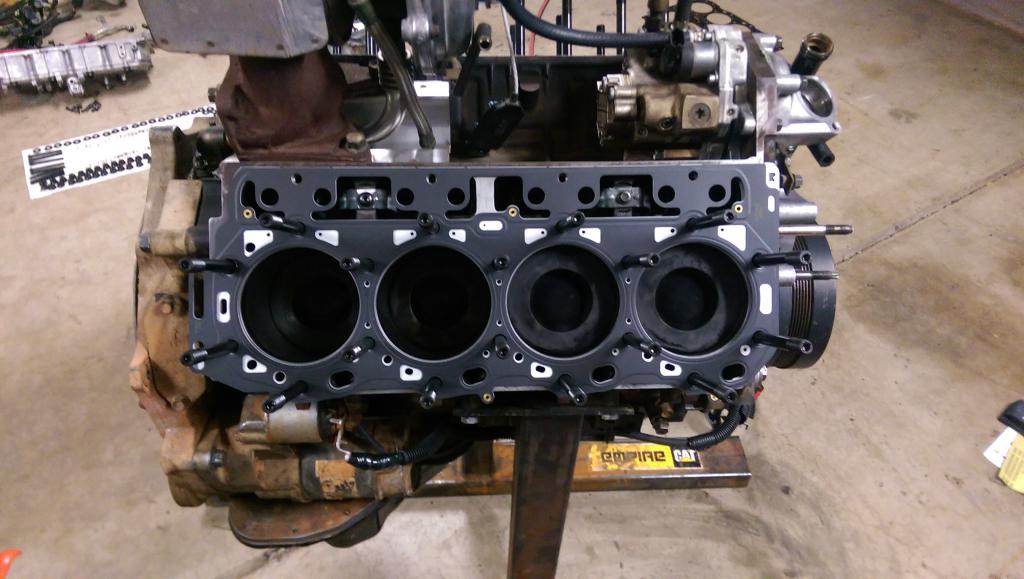

Deck is all cleaned up, alignment dowels and studs are in, gaskets are on. Ready for the heads to arrive tomorrow.

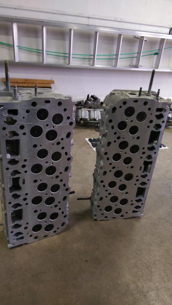

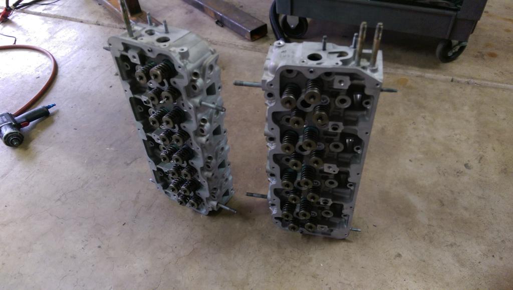

Heads finally arrived today! They are so pretty

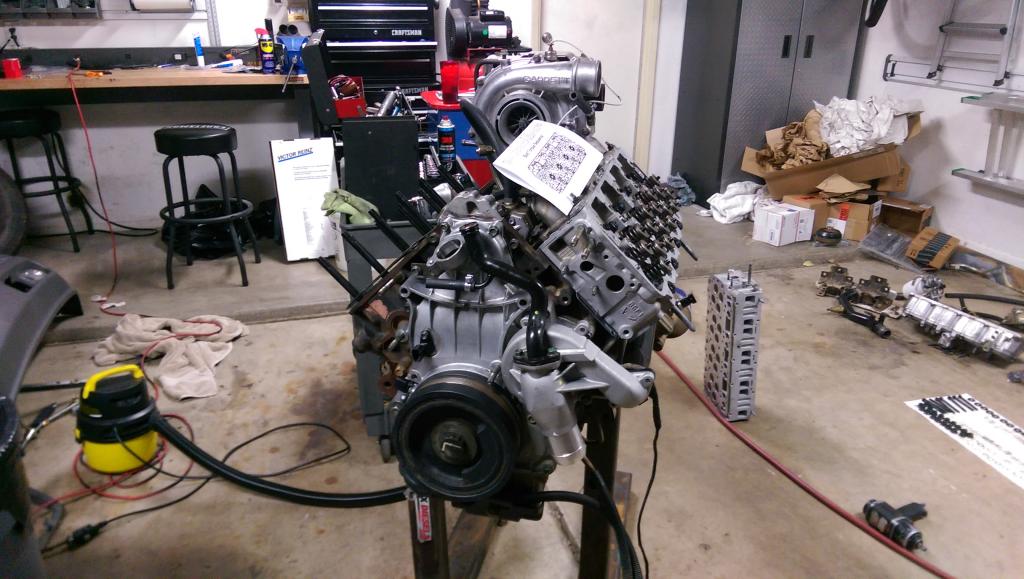

Here I am now, valve covers are just sitting on top to keep dust out.

Interesting 4 valves and 2 runners per cylinder! Never knew that about the dmax
I thought the same thing to myself.
