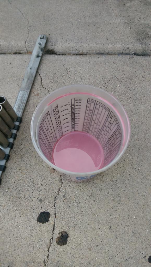

Spent the last few days dealing with a cracked trans cooler in the radiator. Had coolant in the trans and trans fluid in the cooling system. This is what I drained from the trans:

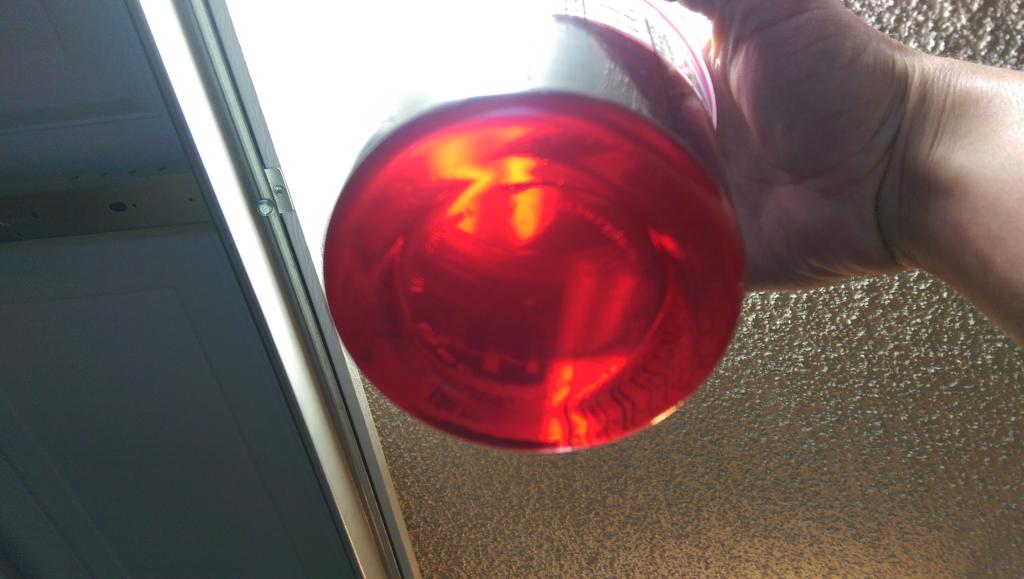

Talked to Mike L, he walked me through the flush procedure. A new radiator and 24 gallons of trans fluid later, it was coming out clean

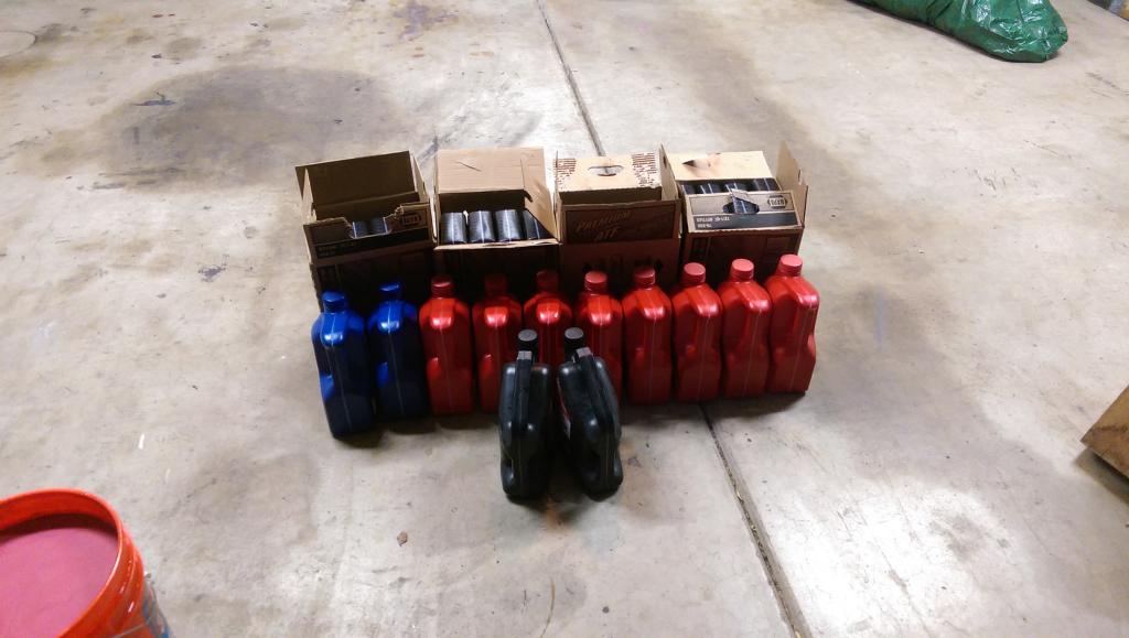

In case anyone is curious what 24 gallons and $500 in trans fluid looks like, here you go:
Put a few miles on the truck yesterday, everything seems to be running fine. I think I may have dodged a bullet.

damn, that is alot of tranny fluid!
