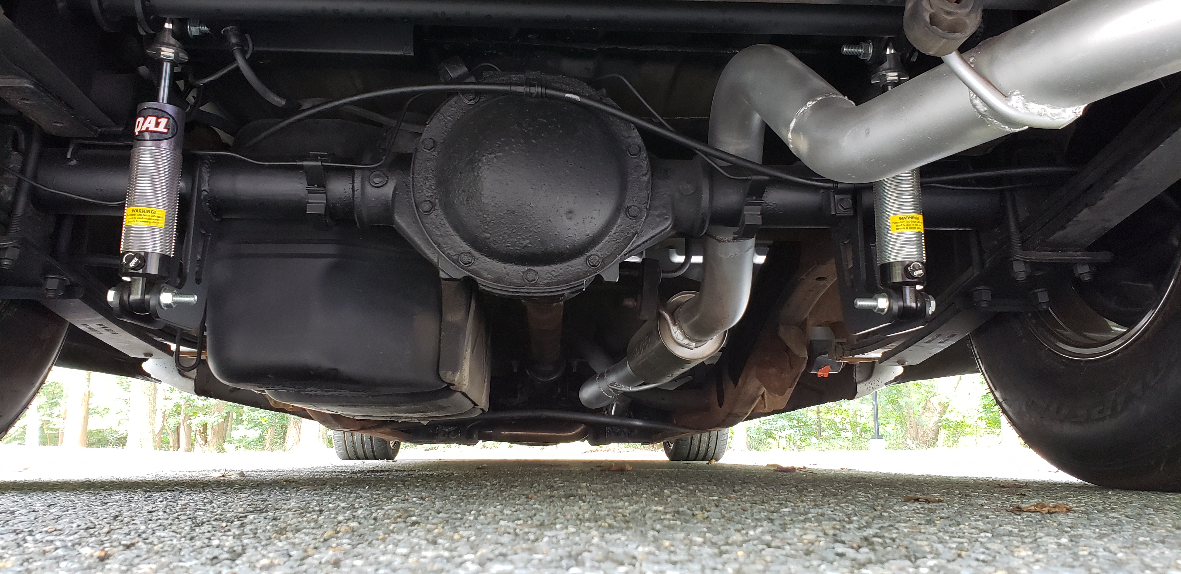

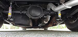

Got the rear shock relocation done and 4.10 gears installed with a trutrac

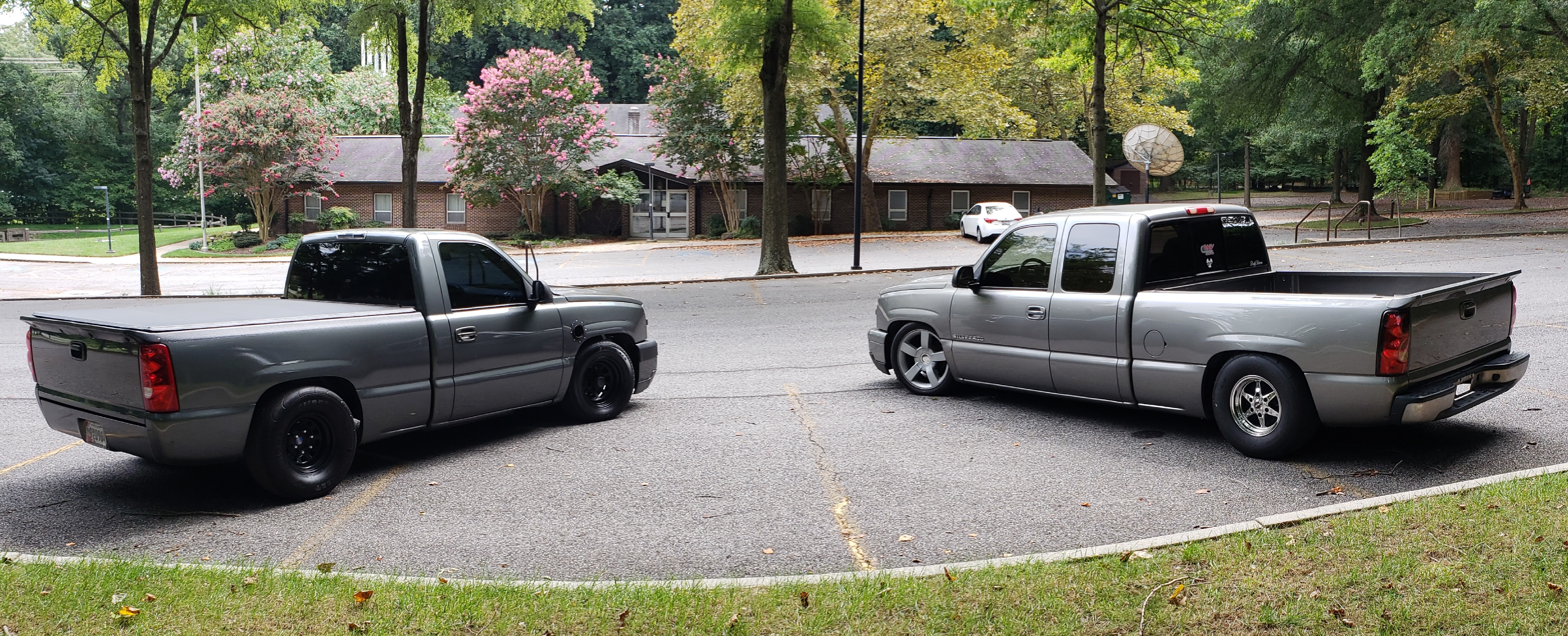

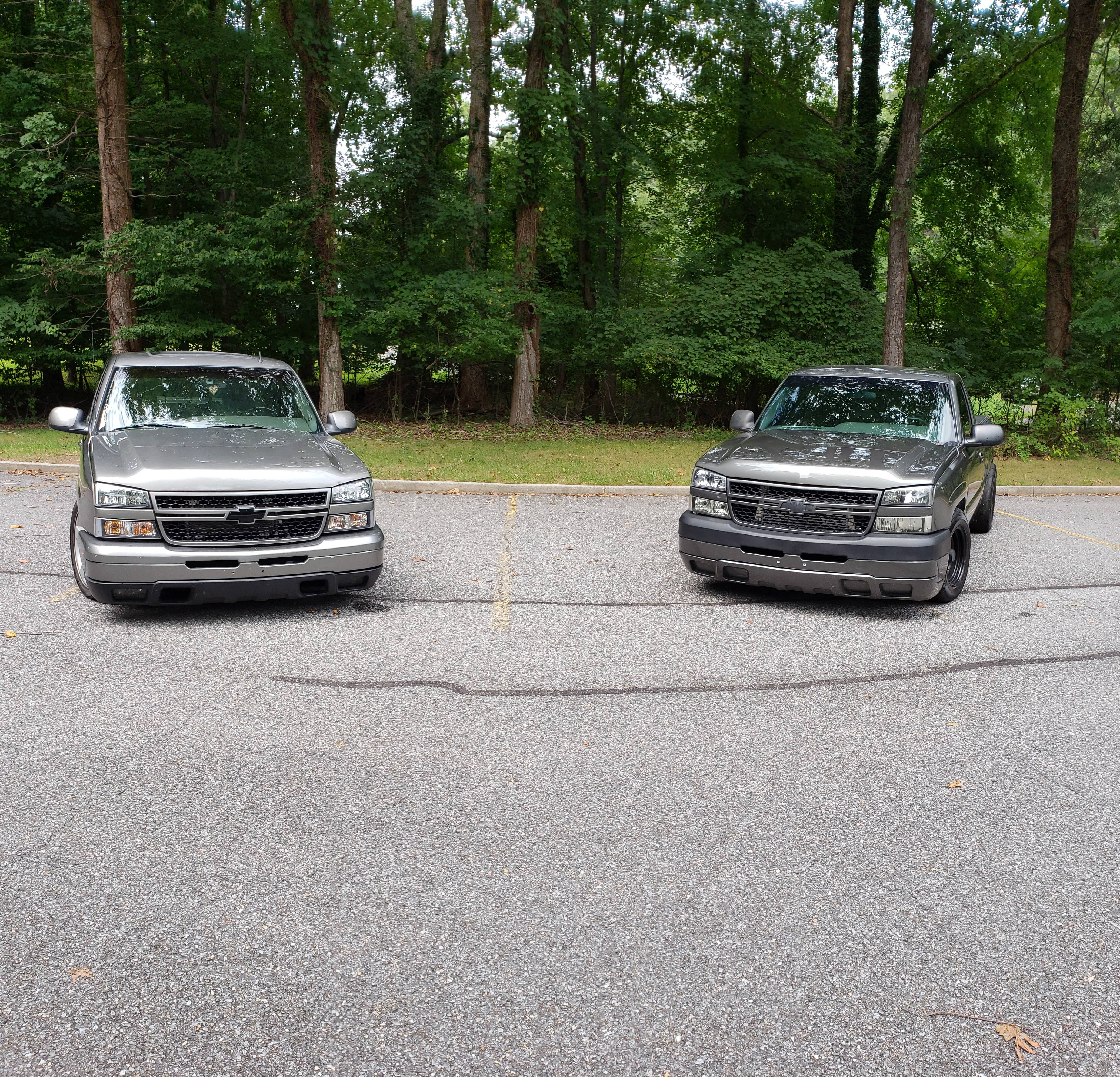

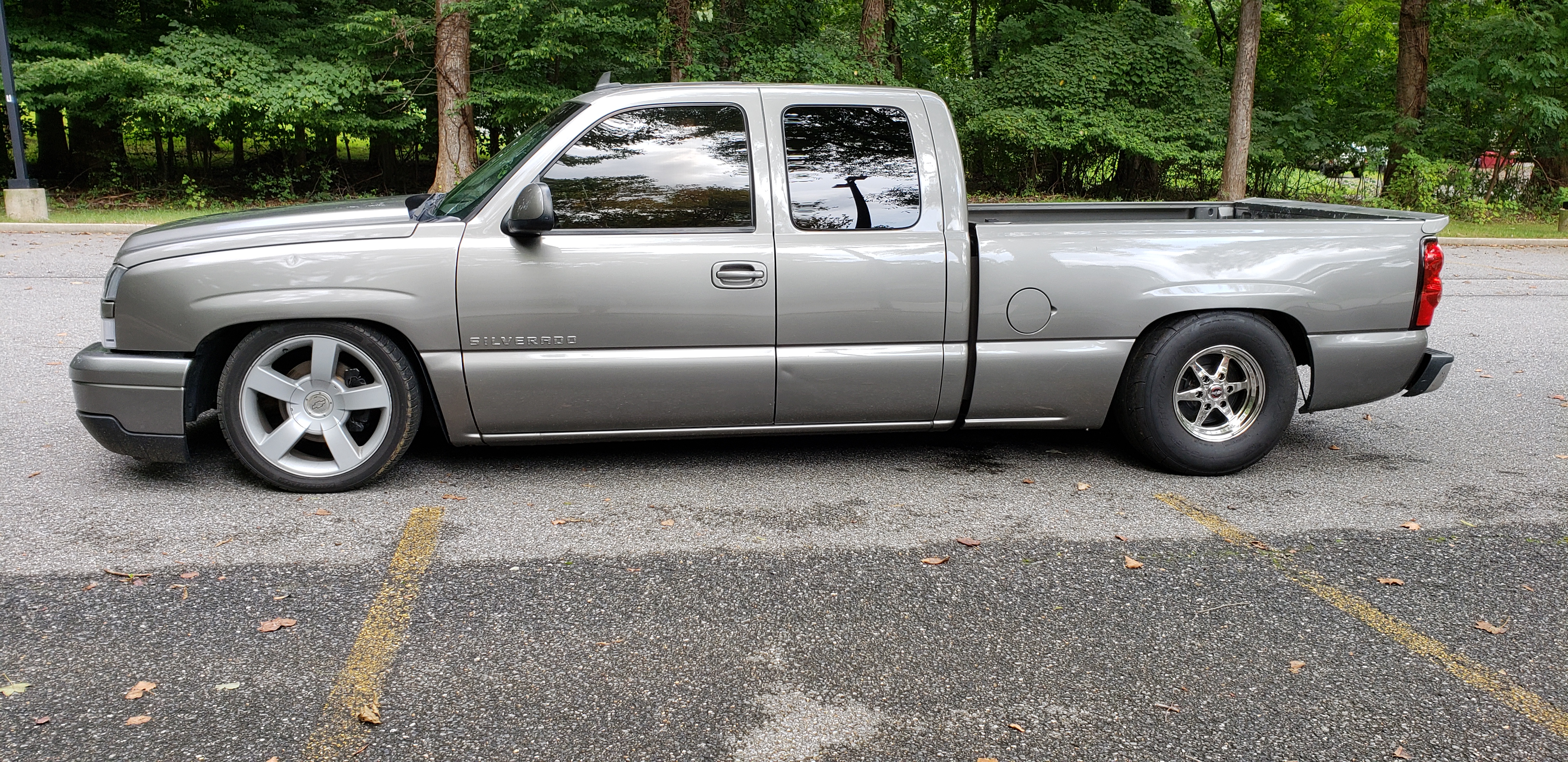

Anyways Here's a few pics with my turbo single cab
